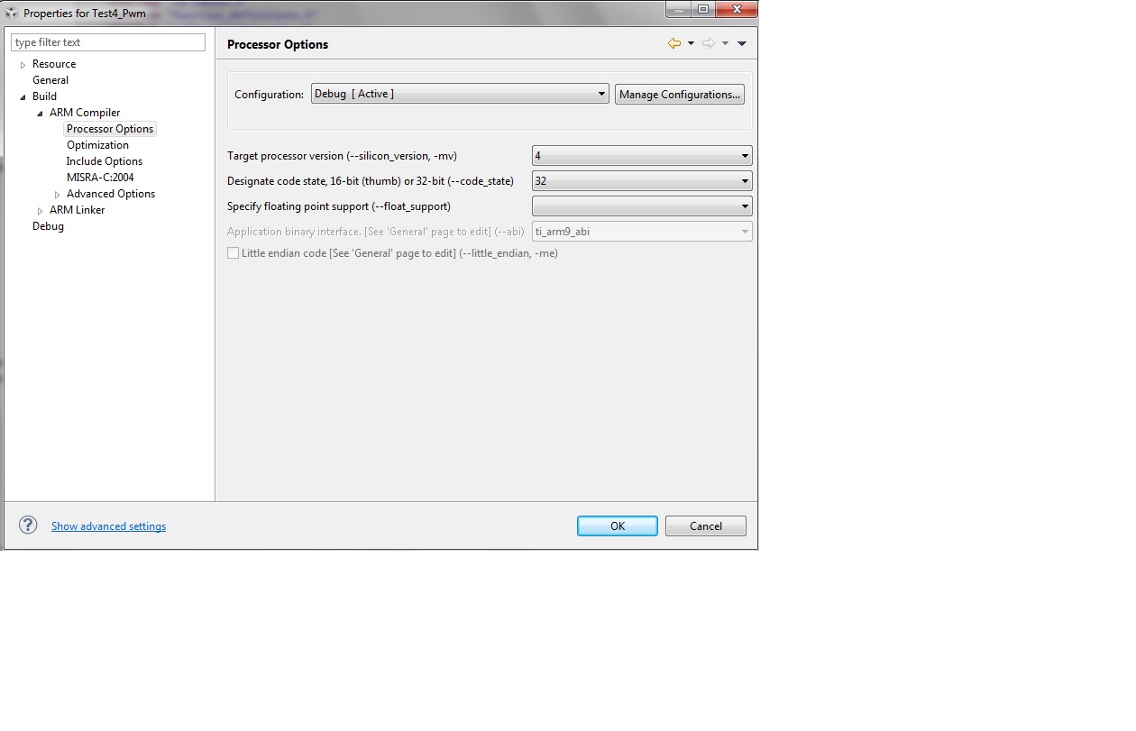

    I have downloaded and wanted to try the labs at CCSV5.5. However, I didn't succeed. I have imported the lab 02 into  CCSV5.5. After I built the project, the error windows prompted out at the line void c_int00(void) in main.c and commented "#1559 Interrupt handlers must be compiled in ARM mode". Do you have any idea how to solve it? Have you imported the lab? Did you succeed to build the hex file at CCSV5.5?
    Thank you.
    Best Regards
    Tom
  • Hi Tom,
    For the error, #1559 Interrupt handlers must be compiled in ARM mode I found to resolve this error : change designate code source in 32 bits mode like picture. Today I don't resolve the problem with void c_int00(void). so my program don't start. do you find something ?
    SEB
  • Hi Sebastien
    I have got the replied from TI Employee in the other post, the link provided below. You could refer to that. My problem got resolved. Let see if it would help you.
    http://e2e.ti.com/support/development_tools/compiler/f/343/p/137594/1186321.aspx#1186321
