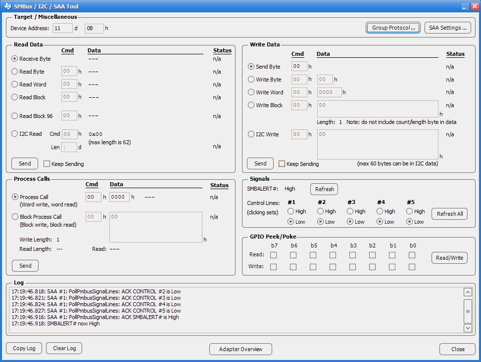

    SAA #1: PollPmbusSignalLines: USB/SAA ERROR

    I'm finding some troubles when using "SMBus & I2C & SAA Degub Tool" with my USB Interface Adapter. In my case the application freezes during "Looking for USB Serial Adapter". If try to use the adapter with the BQ2416x EVM software, it works fine.
    The firmware version installed is 49.2.2.
    Also if i detach the adaptor the  "SMBus & I2C & SAA Degub Tool" opens  with some errors like below:
    Can somebody help me with this?
  • The USB-to-GPIO adapter doesn't ship with FW version 49.2.2, I'm assuming the BQ2416x EVM software must be loading this version since that device is operating correctly.
    Please refer to the following post for an explanation on downloading a FW version to the USB-to-GPIO adapter which is supported by the Fusion GUI (I have not tried updating from 49.2.2 as I've never seen this FW version before but I expect it will work).
    e2e.ti.com/.../2121558
  • I just confirmed the BQ2416x EVM software does in fact overwrite the shipping FW and that it can be restored to a 10.x.x version.
    One thing is required, after launching the USB Adapter Firmware Download Tool it will not find the adapter while scanning, unplug adapter from USB and FW load screen comes up, reconnect adapter to USB and then continue procedure.
