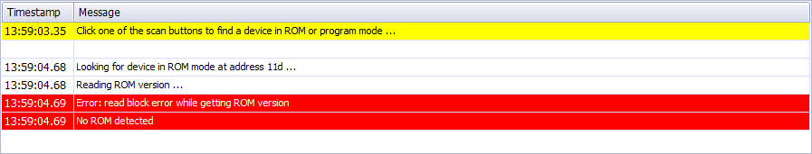

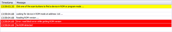

  • I was downloaded my Firmware in the target via UCD3xxx & UCD9xxx Device GUI .
    but I lost access to the ROM (ROM not detected) . The following figure shows you what you get when doing a Scan Device in ROM Mode
    But when you click Scan For Device in Program Mode we get this:
    At this stage, it is blocked it does not have the right to appoint another Firmware or the possibility of recovering the Flash program. It seems like I was be locked in Flash mode.
    So , How can i get back to ROM mode
