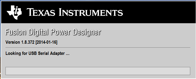

I am having trouble getting Fusion Digital Power Designer to run. I connect the TI USB Interface Adapter to my PC (Win7 Enterprise Service Pack 1 64-bit) using no hubs or docks. It enumerates as a USB Input Device. I start Fusion Digital Power Designer (v. 1.8.372), and it stalls out indefinitely at the step shown below:

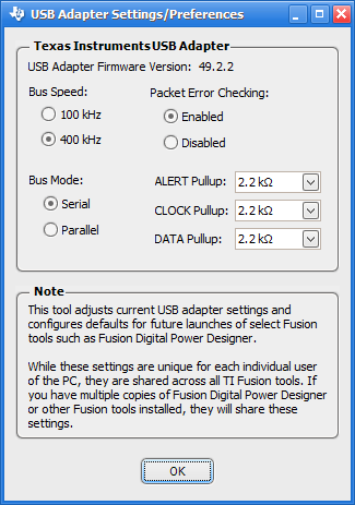

Strangley, if I run the Fusion Digital Power Designer (Offline Mode), I can see that it's communicating with the USB Serial Adapter by clicking "File -> USB Adapter Settings". This is what it shows:
Can anyone tell me why the online version stalls out when looking for the USB Interface adapter?

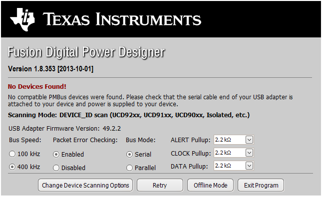

    The UCD3XXX / UCD9XXX Device GUI stalls on the same screen. After letting it sit for 30 minutes on this screen, I tried unplugging and replugging the USB connection. I then make it to this screen:

  •  Can you confirm the FW version on your adapter?
  • The FW version on the adapter says 49.2.2
  • I'm not sure where this version of the USB-to-GPIO adapter with the 49.2.2 FW originates, possibly another business unit at TI, I will check into it.
    I've never had an adapter with this FW version but I assume it is not compatible with the FDPD software.
    Try this:
    Plug in the adapter to your computer (instructions based on WIN7 OS), navigate from the Start menu as follows:
    Start-->All Programs-->Texas Instruments-->Fusion Digital Power Designer-->Tools-->USB Adapter Firmware Download Tool
    Choose the Select USB Adapter Firmware radio button then select any of the FW versions shown.
    (the USB-to-GPIO supports a number of different devices but all these FW versions work with the UCD9248 - the only difference you would possibly see is the polarity of the PMBus_CNTRL pin when the adapter is attached to the computer.  This may disable the conversion on the rails if the configuration is set to use the control pin and they have wired it to the controller)  If you need a particular polarity let me know and I can look it up.
    Click Next
    After Download has completed, click OK.
    You will need to disconnect and reconnect the adapter for it to run the new FW version
  • Works perfectly now, thanks for the help
