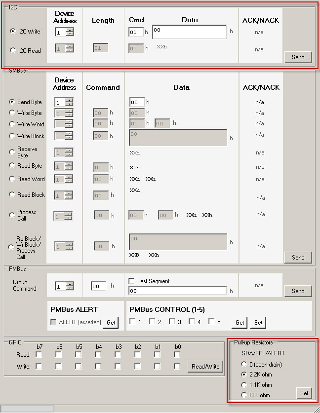

I have my USB to GPIO Interface Adapter. I download the software given in the TI website http://www.ti.com/tool/usb-to-gpio. A page where I could enter my I2C commands PMBUS GPIO, etc commands pops up. ( I will provide a picture of the page that I am talking about below) Everything is so far so good. I connect one end of the 10-Pin ribbon cable (that came in the same package as the USB to GPIO Interface Adapter) to the USB to GPIO Interface Adapter. I then connect the USB to mini USB cable (that came in the same package as the USB to GPIO Interface Adapter) to the USB to GPIO Interface Adapter and the other end of the USB to mini USB cable was connected to the PC. Basically, I followed exactly what was described in the user manual. The green light on the USB to GPIO Interface Adapter lit up and everything is fine.

After everything was set up, here is what it looked like in my computer screen:
I am using the DLP PICO CHIPSET Programmer's Guide User Manual for the DLP Pico Projector to help me with issuing I2C commands. I have read through it but I do not understand how to use it. I am an extreme beginner at I2C. I have read past forums, user manuals, google, and basically everything but I still do not know what exactly needs to be put in that screen.
MY QUESTION:
If I want a checkerboard pattern to be displayed, (that is, I want the digital micromirrors to have a checkerboard pattern so that whatever is in my computer screen gets "checkerboarded" so to speak.), what needs to be put in Device Address, what needs to be put in Cmd, and what needs to be put in Data for when I2C write is bubbled in? After I have set everything up in I2C write, do I then send or do I have to set things up in I2C read. What needs to be put in I2C read then: what do I put in Device Address, in Length, and in Cmd. I tried playing around with things (putting in numbers that I thought was right) under the "guidance" of past forums and the programmers user's manual, but unfortunately I just get errors. I played with the I2C Write and pressed Send and I got Error under ACK, then I played with the I2C Read and pressed Send and I got Error under ACK. I then tried to set Pull-Up resistor to 2.2K ohms and I got an error.
In conclusion, if someone can provide detailed step-by-step instructions on what numbers needs to be put where to and when I press the Send button, I would really appreciate it. If I can I have some dictionary and examples that translates  and shows how to put whatever is in the programmers user's manual to the screen above in the respective places. I only see in the Programmer's Manual things like (I2C:X0B) and then a column that says BITS and a column that says Description and a column that says TYPE and I do not know what to put in the Device Address, Cmd, Data, length, etc. Can you please tell me what needs to go where. Please tell me exactly what numbers or whatever needs to go where to do the checkerboard example as discussed above. I have read the USER Manual for the USB to GPIO Interface Adapter and still do not get their instructions.
I have researched a lot on my own. I have read all kinds of manuals, and forums and google on my own. I believe I understand the basic idea of I2C but I still do not know what to write under Device Address Cmd, Length, Data and when to press the send button. Please give the checkerboard example. I would really appreciate your time, help, and effort!!!!
