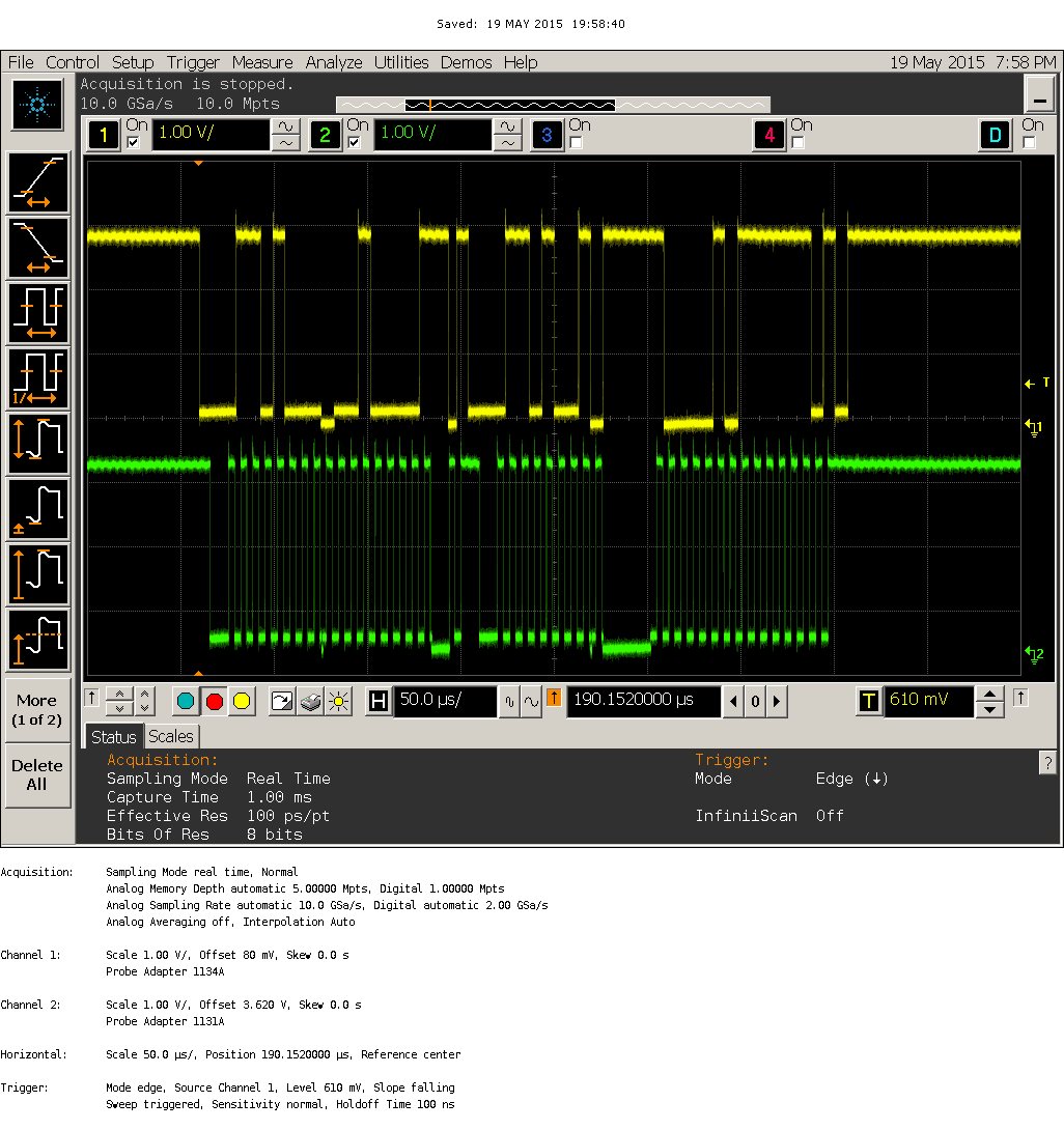

  •  Hi Zhiyuan,
    I have a few questions again i have gone through document which u have refered, and found that some data i am getting from the UCD9248.  So  few questions here.
    1. I have currently set the FPGA voltage to 0.97V using the command code name as  VOUT_COMMAND with command code address as 8'h21, using SMBUS Protocol and the Voltage is set properly.Checked and verified .
    Now if i want to read back the Volatge what i have set through SMBUS protocol from the slave (UCD9248) what is the Command Name and Command Code used ?
    I thought that it would be the same command code  (VOUT_COMMAND,  8'h21 ), is that True ? or should i need to send the the Command Code name as READ_VOLT with command code address as 8'b8B picked from page no. 100 , PM Bus spec 1.2 version .
    2. In the PM BUS document  page no. 85 section 18.4 says that  " If the VOUT_MODE is set for Linear or Direct format, the returned value is in volts. If the VOUT_MODE is set to VID format, then the returned value is the VID code corresponding to the voltage closest to the measured voltage". currenty i have not set any of the 3 modes through VOUT_MODE.. so what will be the Default Mode  ? ?
    3. Contuniation of Point no. 1, After i have set the FPGA voltage to 0.97V from the Texas Fusion Digital Designer , i have noticed in the Log file stating that " VOUT_COMMAND [0x21,Rail #1]: wrote 0.970 V [0x0F85] to RAM "  so now the Voltage value in hex corresponding to 0.97V  is 0x0F85. ? correct ?
    So assuming that READ_VOLT is correct for reading the output voltage,  when i executed the READ_WORD protocol with command code name as READ_VOLT,  i am getting 16 bits of data from UCD9248 as ( 0xBFF8).
           a.  Why i am getting the 16 Bits data ? i am supposed to get 12 bits of data ?
           b.  When loading through the Texas Fusion Digital Designer tool i am able to see only 12 bits (0x0F85) of data corresponding to the voltage (0.97V).
    Please kindly correct me if am wrong any were in the statement.
    also i have attached the snapshop of the scope for your reference, so that u can verify that i am following the READ_WORD protocol by senidn the Command code as 8Bh
    Thanks Regards,
    Pranesh

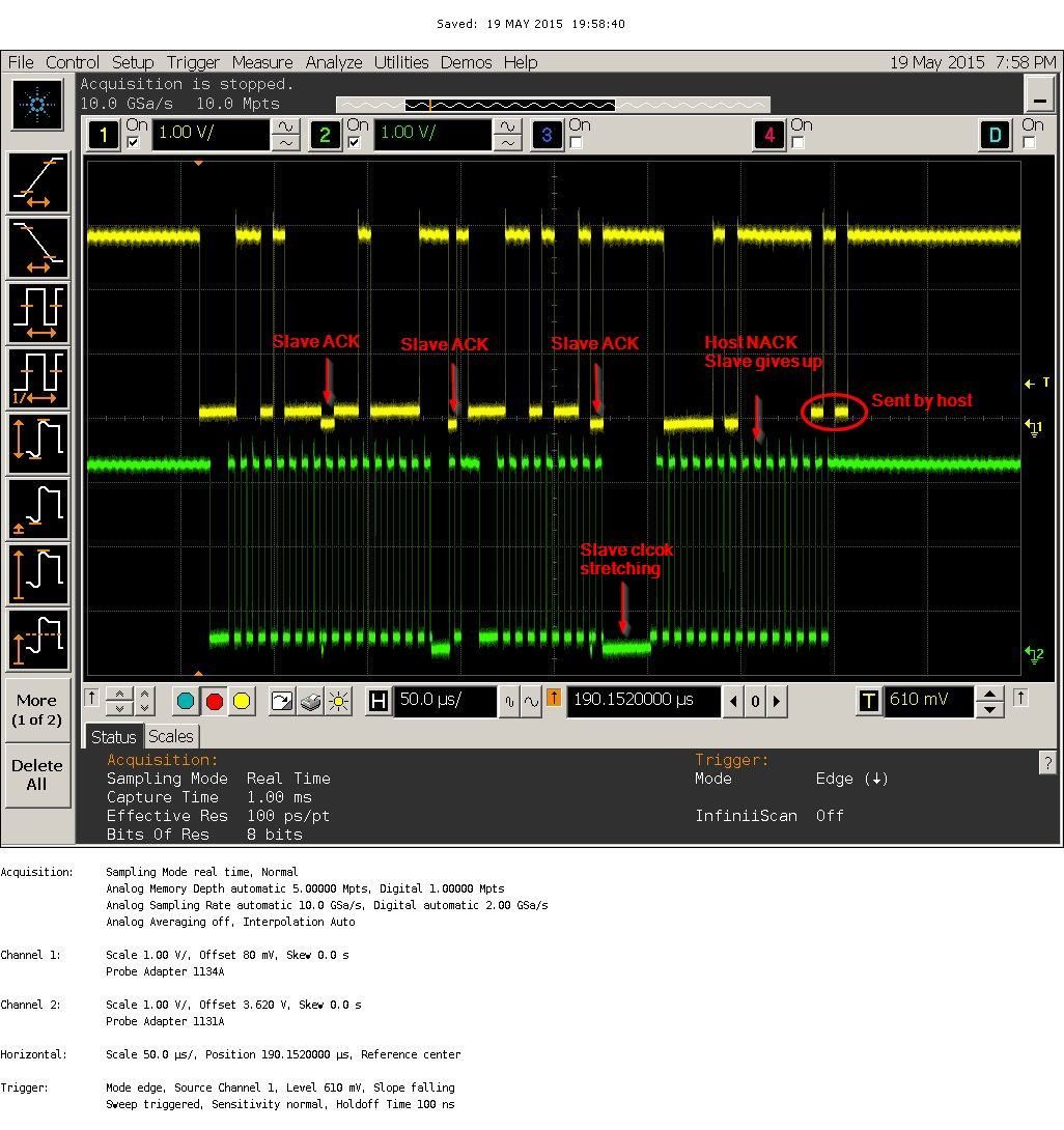

    The waveform you attached is NOT 8Bh. It is sending 21h VOUT_COMMAND. The host NACKed the slave during transaction so the slave aborted. Please check why host NACK. Note that host must support clock stretching per PMBus 1.2.
    Zhiyuan

  • Hi Zhiyuan,
    Good Day to you.
    As you said i have checkd my Code and verfied that i am sendind the Proper Slave Address and Command Code i am sending is 8'h21 attached the snippet . and also i have taken the snap shot of tehy scope.
    I am capturing the data in the below mentioned fomat.
    1. Data Lower Byte { 7 6 5 4 3 2 1 0}
    2. ACK From HOST
    3. Data Upper Byte { 15 14 13 12 11 10 9 8}
    Is the Capturing format correct ?
    I am getting currently 0xFF99  Value from the slave , with the Command Code as 8'h21.
    If i am wrong please correct me. I am currenlty reading the VOUT_COMMAND.
  • What I read from the waveform is:
    S 0110 1000 A 00100001A
    Sr 0110 1001 A 0110 0010 N 1111 1110 P
    The problem happens when host NACKed the first byte, then the slave gave up. The second byte is sent by host, not from the slave.
    Also, it look like 0 before the NACK is sent by host. You can tell it by observing "0"'s voltage level -- host doesn't pull all the way to ground, and slave pulls down to ground. The 0 before the NACK doesn't pull to ground, so probably slave wanted to send a 1 but host pulled low the data line and then NACKed the slave.
    You need to check what happened in host when receiving the first byte. Why does it NACK? Why does it pull the data line?
    Zhiyuan
