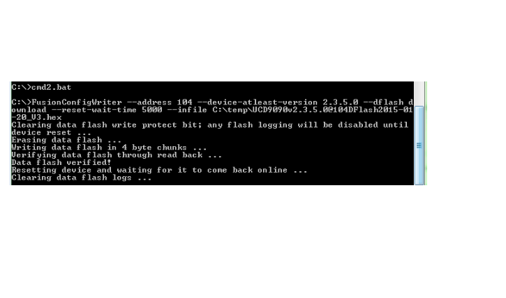

We are using UCD9090 in design, we need upload the Firmware for in manufacturing line, for each and every PCBa, I am planning to have USB-GPIO programmer, I found some of command line argument to dataflash/FW write in Fusion digital software, but with this I have to configure the Serial number and Revision letter is there any script/command line to atomize this process in Manufacturing line.
