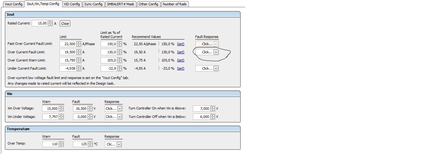

    Starting problems on my digital power solved. The problem was not on operation of the power manager UCD9090, but on starting of the power stage UCD74111. I adjusted fault responses on my UCD9222 design to restart up to 5 times and got the prototype working. I guess the output caps on UCD74111 drew too much current on cold start and over current limits were exceeded. Default setting was "do not restart".
    Fault response setting tab marked on attached picture.
