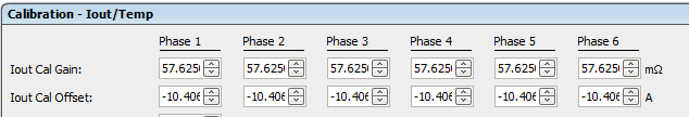

My IOUT_CAL_GAIN is set 129mOhm  and IOUT_CAL_OFFSET is set at approximately -4.8A.

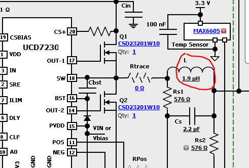

    [1] For R_series current sensing.
    I set the series resistor as 2.8mohm and GUI automatically give the results:

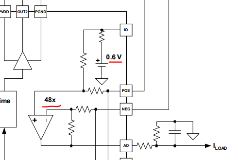

    From UCD7230 datasheet, you can see the gate driver's Current sense amplifier GAIN= 48, OFFSET=0.6V
    So The Iout Cal Gain = 2.8*48=134 mohm
    The Iout Cal Offset = 0.6V/134mohm = 4.4A
    [2] For inductor DCR current sensing
    The calculation methods will be the same, and you just replace R_series with DCR value.
    For this example, my DCR=1.2mohm. And GUI gave the correct results.

  • Hi Dima,
    I will suspect your load current is too Low. At such small load, it is difficult to read accurate current. Reading will be more accurate once you add load to 10A or 20A.
