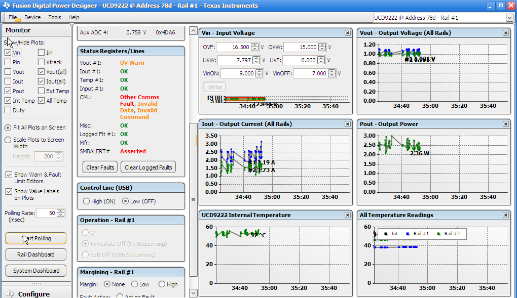

    Further more update, when I only enable the DSP2 1.1v and 1.0v power supply, the UCD9222 monitor as below: (Already clear faults and clear logged faults)
    But once I enable the DSP1 UCD9222, The DSP2 UCD9222 voltage and current will fluctuate heavily as below: (Already clear Faults and Clear Logged faults)
    Any possible reason for the DSP1 affects DSP2 UCD9222?
    Thanks.
  • As for the error messages shown above, is there another Master (other than the USB-to-GPIO) on the PMBus bus used by the UCD92 controllers?
    It looks like there may be collision between two masters which could cause these error codes.
    If possible isolate the controllers from the other PMBus master while using the USB-to-GPIO adapter.
    The FLT error code is likely due to an overcurrent event on the UCD7242, but could be due to instability of the control loop given that you are also seeing OV and UV faults as well.
    Can you provide the configuration files (.xml) for both controllers and schematics for these power components, you can use the PM connection we setup if you would not like to post them to the E2E.
    I cannot speak to the C6678's loading requirements, not my area of expertise, I believe this is highly dependent on the coding loaded onto the DSP. You could post to the Processor E2E for assistance with calculating the expected power requirements of the DSP.  Since DSP2 starts and runs by itself I would not think that it is a loading issue unless having DSP1 running somehow increases the loading on DSP2.
    Is it possible to unload the coding from DSP2 so that its loading requirements would be reduced or to disconnect the UCD9222 and UCD7242 from the DSP to see how it operates on its own.
    Have you looked into the PCB layout to rule out any issues there?
    Brad
