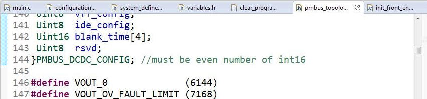

  • First,when I  calculate the ramptime for HSFB UCD3138,I met a problem. The reference value I calculated is 1.2V/0.09765625 mV=12288,that is  FeCtrl0Regs.RAMPDACEND.bit.RAMP_DAC_VALUE = 12288;but the reference value in UCD3138HSFBEVM_029 is 6144. I don't why?

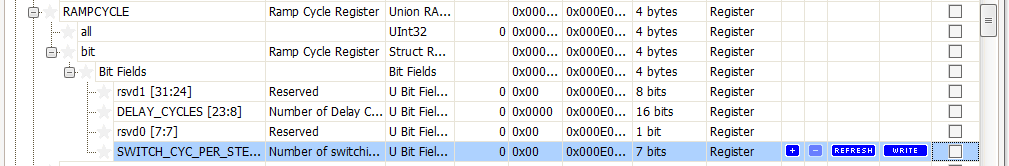

    That is FeCtrl0Regs.RAMPCYCLE.bit.SWITCH_CYC_PER_STEP = 8;// every switching cycles pre DAC step
    Third,after I change the SWITCH_CYC_PER_STEP for the right front end,but when using the read function inmemory debugger, SWITCH_CYC_PER_STEP doesn't change. I don't why?
  • OK, the picture is clear now.
    First let's look at the function :
    void configure_vout_cmd(void)
    struct qnote constant_DAC_VALUE_SCALER = {DAC_VALUE_SCALER, 0};
    pmbus_dcdc_config_translated[0].vout_cmd = qnote_linear16_multiply_fit14(constant_DAC_VALUE_SCALER, pmbus_dcdc_config[0].vout_cmd, -VOUT_MODE_EXP);
    FeCtrl0Regs.RAMPDACEND.all = pmbus_dcdc_config_translated[0].vout_cmd;
    Plaese note that "pmbus_dcdc_config_translated[0].vout_cmd" is not the same as "pmbus_dcdc_config[0].vout_cmd".
    What is placed in the DAC for setpoint is the pmbus_dcdc_config_translated[0].vout_cmd and that one should be 12288
    The value of "pmbus_dcdc_config[0].vout_cmd" is in PMBus "Linear16" format, when VOUT_MODE_EXP defined by PMBus is set to 9.
    If "pmbus_dcdc_config[0].vout_cmd" is set to 6144, after the above function is executed, the value of "pmbus_dcdc_config_translated[0].vout_cmd" and the DAC value will be set to 12288.
    Regarding the no change in SWITCH_CYC_PER_STEP, these register values are of course volatile. I am not sure why it goes back to zero.
    Do you set it by firmware or by the memory debugger? How are making sure that the statement "FeCtrl0Regs.RAMPCYCLE.bit.SWITCH_CYC_PER_STEP = 8;" is getting executed? Is there any other statement in your code that accesses the RAMPCYCLE register?
