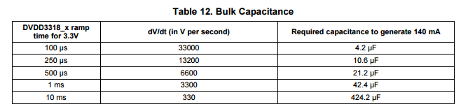

    As for the cap + slew rate solution, again I am not aware of any specific examples, just that if the slew rate is increased then less overall energy is transferred to DVDD18 and therefore a lower load will be necessary.
    Just as it is described in Table 12 of the OMAP-L138 Errata: http://www.ti.com/lit/er/sprz301m/sprz301m.pdf
