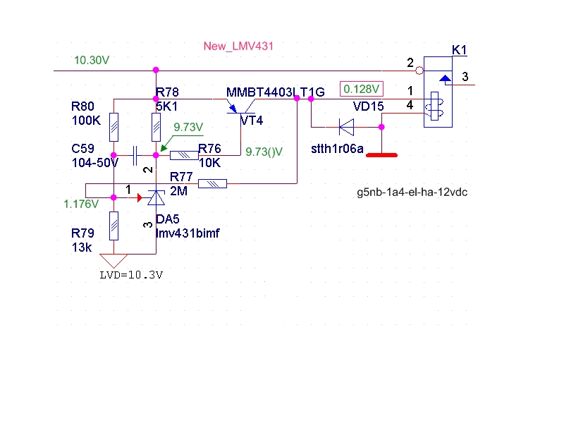

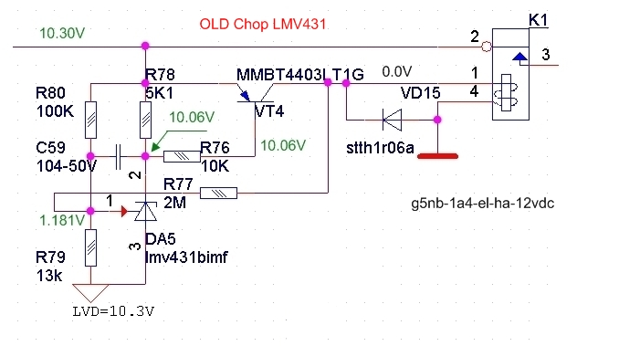

We got a new batch of chips LMV431.
Driving behavior has changed.
Also, the new devices have a larger size.
Got a question. ICs of the new party are normal or is it counterfeit?
