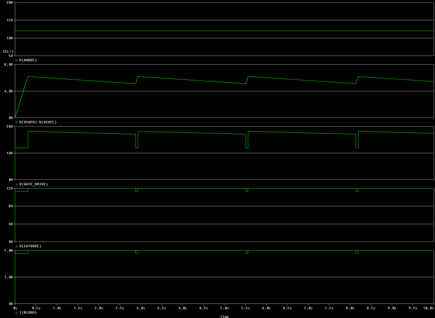

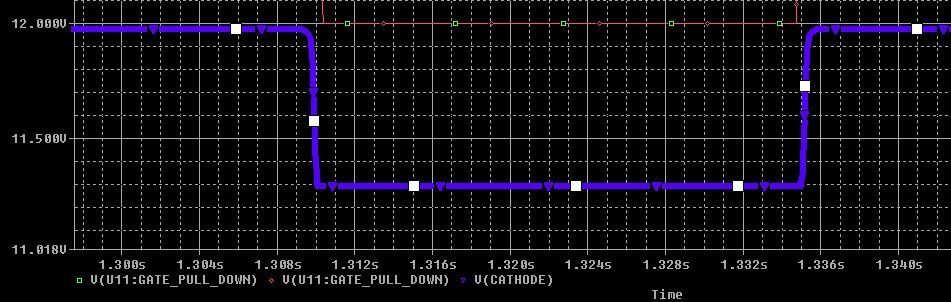

    I ran the following simulations to see whether having a large output cap makes any difference:
    In this simulation I have 12V input voltage, 2A output current (resistive load). As we can see the output voltage has body diode pulses every 2.3 sec. For the equation T = C*dV/dI, dV is change in voltage (diode drop) = 0.7V, dI is change in output current drawn = 0.1A. So we can calculate the slew rate based on the cap value ( which is 22uF for this simulation) here is whats happening:
    So the slew rate of voltage drop from 12V to 11.3V is 0.02msec, exactly what I calculated using T = C*dV/dI. The voltage drop width time is 22msec, This is the time period when charge pump is active and charging the VCAP (change pump cap) from lower threshold (~5V) to higher threshold value (~6.1) using 50uA current flow. So If you use 2.2uF, this time will be exactly what the simulation is showing.

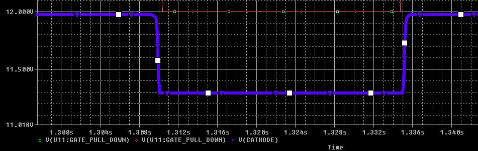

    Now for comparison, I changed the output cap to 10,000uF and here is the result:
    As you can see every thing remained the same except for the slew rate for the change in voltage from 12V to 11.3V. This time it increased from 0.02msec to ~0.4msec. However, the amount of time body diode had to conduct is still 22msec.
    So this proves a few things:
    1. Body diode pulse width doesn't depend on the output capacitor value and therefore the change pump operation is not effected by output cap
    2. Output cap value only changes the slew rate of how fast the voltage shifts from MOSFET conduction to body diode conduction. Due to small change in voltage and current the cap value has to be unpractical and  so large to see this change. The change in duty cycle will be very insignificant. So it will remain 98%. because the pulse width increased only by 0.4msec even with such a large change in cap (22uF to 10,000uF)
    3. Body diode conduction time depends on the VCAP value only, During this time VCAP is charged form 5.1V (lower threshold) to 6.2V (higher threshold) using 50uA charging current from the change pump.
    Hope this explanation helped, thanks for the opportunity to learn.

  • OK, I see what I was missing is that this circuit is really running much more slowly than I had imagined.  So the longer slew time due to output capacitance is still small compared to the body diode conduction time.  Thanks for the clarification.
