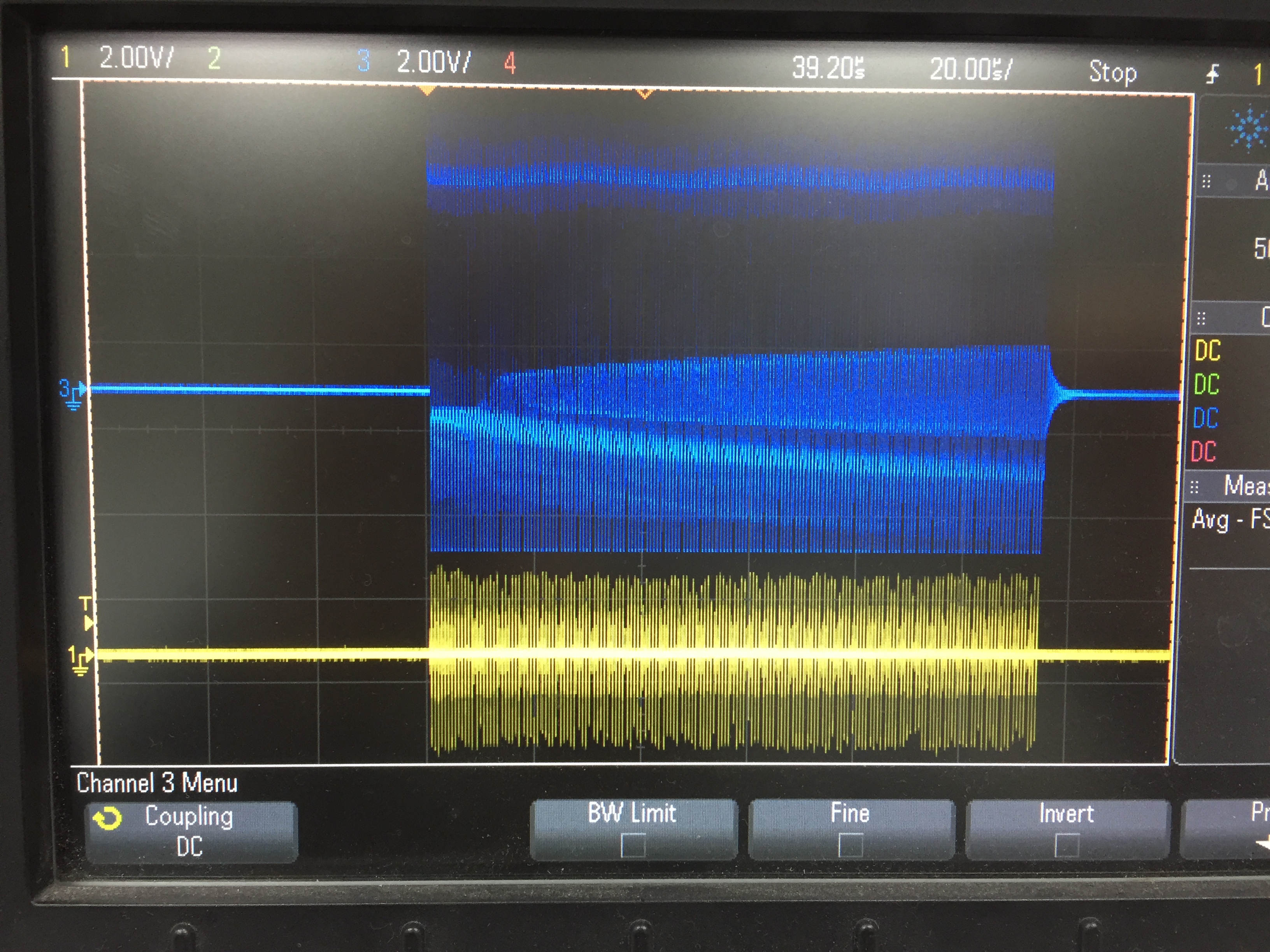

  • Hi Gal,
    Yes there seems to be a relation between VN and VCOM, and a single 10uF on VEE_IN may not be enough to resolve the issue. Placement of the cap should also make a difference, where it would be best to bridge A1 on U17 directly to the ground pin of L12, and even still the external capacitor may not be enough depending on the layout of the board. It is also recommended to have a small dedicated capacitor for VCOM_IN. A scope shot comparing VN_SW and VCOM on a smaller time scale may help with debugging this behavior.
    Rick S.
  •  Hi Rick,
    Pls see below the scope shots , VN_SW in Blue, VCOM in Yellow.
    This is another device with closer caps.
    Thoughts?
  • Hi Rick,
    After placing additional cap on A1 of U17, as you've suggested, I see improvement of the VN signal, and now it drops to -8v and VN_UV is generated.
    VN is in yellow.
    What might cause VN not to be able to reach its -16v?
    Thanks for your help so far!
    Gal

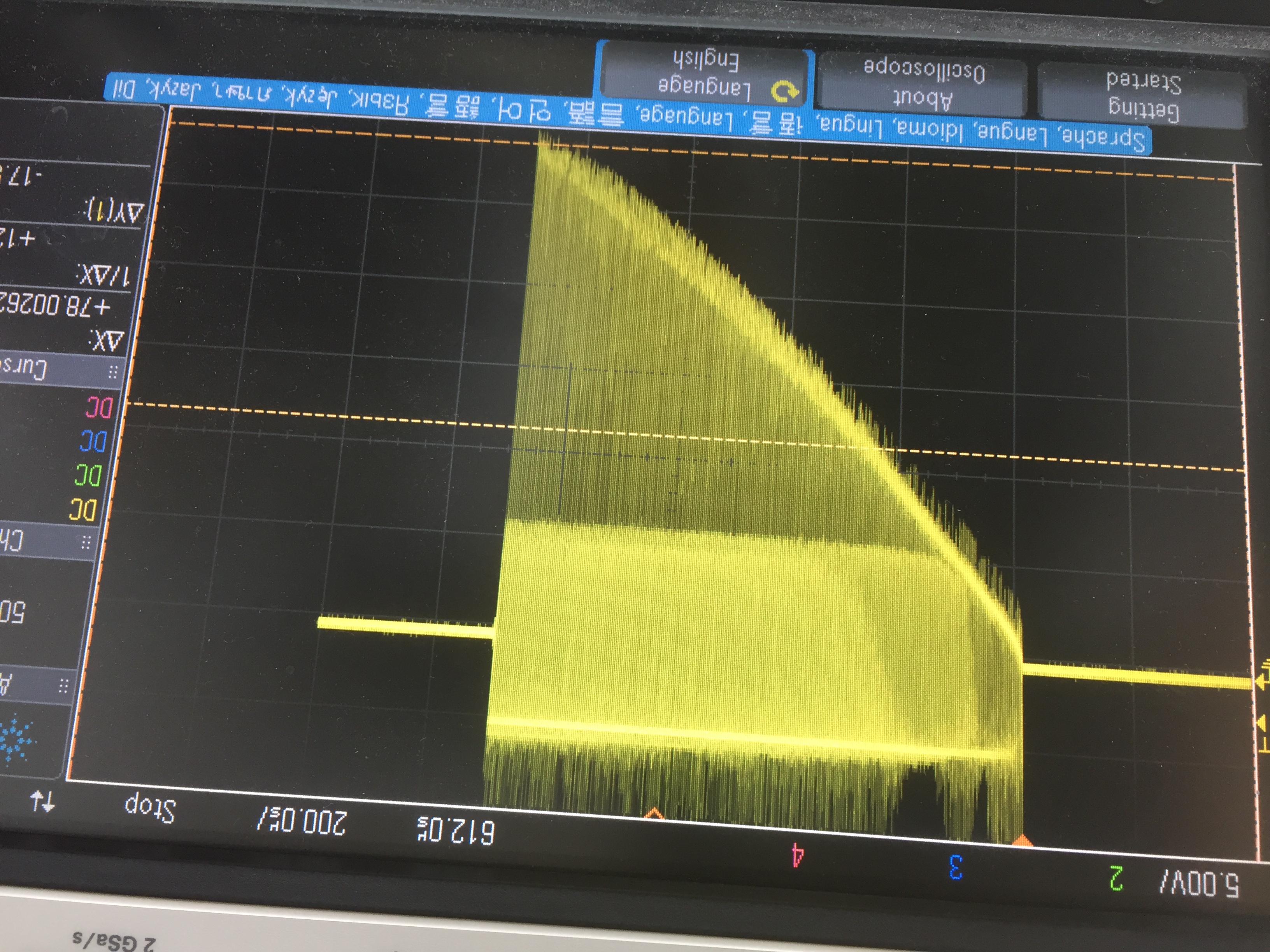

  • Hi Rick,
    No, the VCOM_F does not occur anymore. Now the VN_UV is constantly occurring.
    You can see below the signals of VN_SW and VN:
    I've tried to increase the cap of C78 to 10uF and reduce it, no change.
    The VIN is extremely stable, injected from external power supply @ 5v with practically no current limit.
    Any idea how to proceed ?
    Thank you!
    Gal

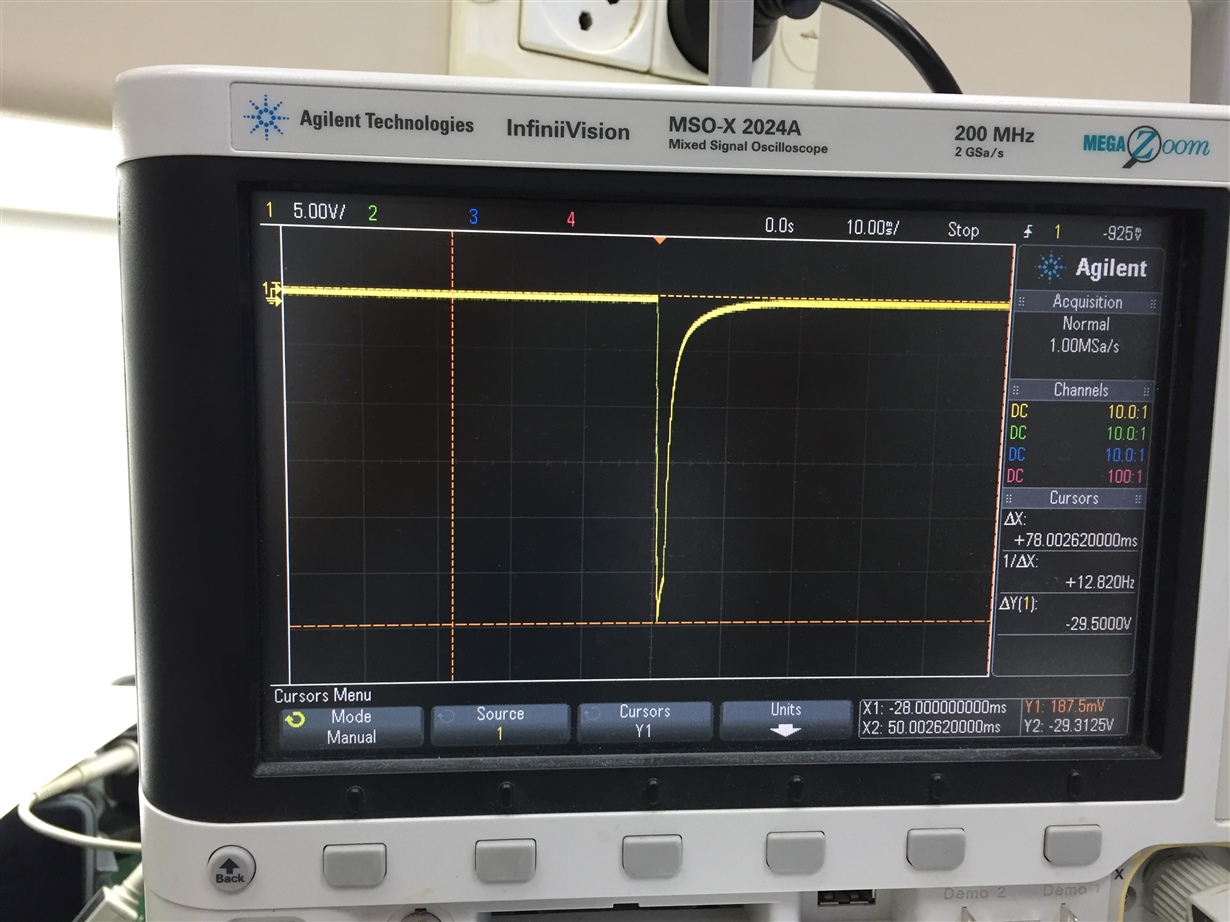

  • Hi Gal,
    Can you confirm the current rating of your rectifying diode? From the schematic it looks like it could be 150mA, but the switching current limit of VN is typically 1.5A. Our EVMs implement 1A average rated diodes capable of 5A peak
    I do not see a clear low side in the switching cycle, and if the diodes cannot handle the switching currents it could explain this behavior.
    Rick S.
  • Hi Rick,
    First, I want to thank you for your support till now!
    Second, we're making progress here as I took your advice and replaced the U17 diode with Schottky diode (2A, 30v) and also replaced L12 inductor to 4.7uH 1.9A/90mOhm, VN capacitor is 4.7uF / 50v. The result looked promising, now I see VN drops very fast to -30v (I expect it to get to -16v) and no error is generated via INT1/INT2!! clearly VB and other rails are not generated.
    Please see image of VN:
    Any idea what might cause VN to overshoot like that?
    seems that the DCDC2 supposed to work independently of other passive components connected to the PMIC, correct?
    thanks again,
    Gal
  • Hi Gal,
    DCDC2 can work independently, but this could happen if the feedback pin (VN) is not actually connected to the output capacitor, as it uses this node to regulate the target voltage and recognize UV/OV conditions. Is there any chance the new components are not connected to VN?
    Rick S.

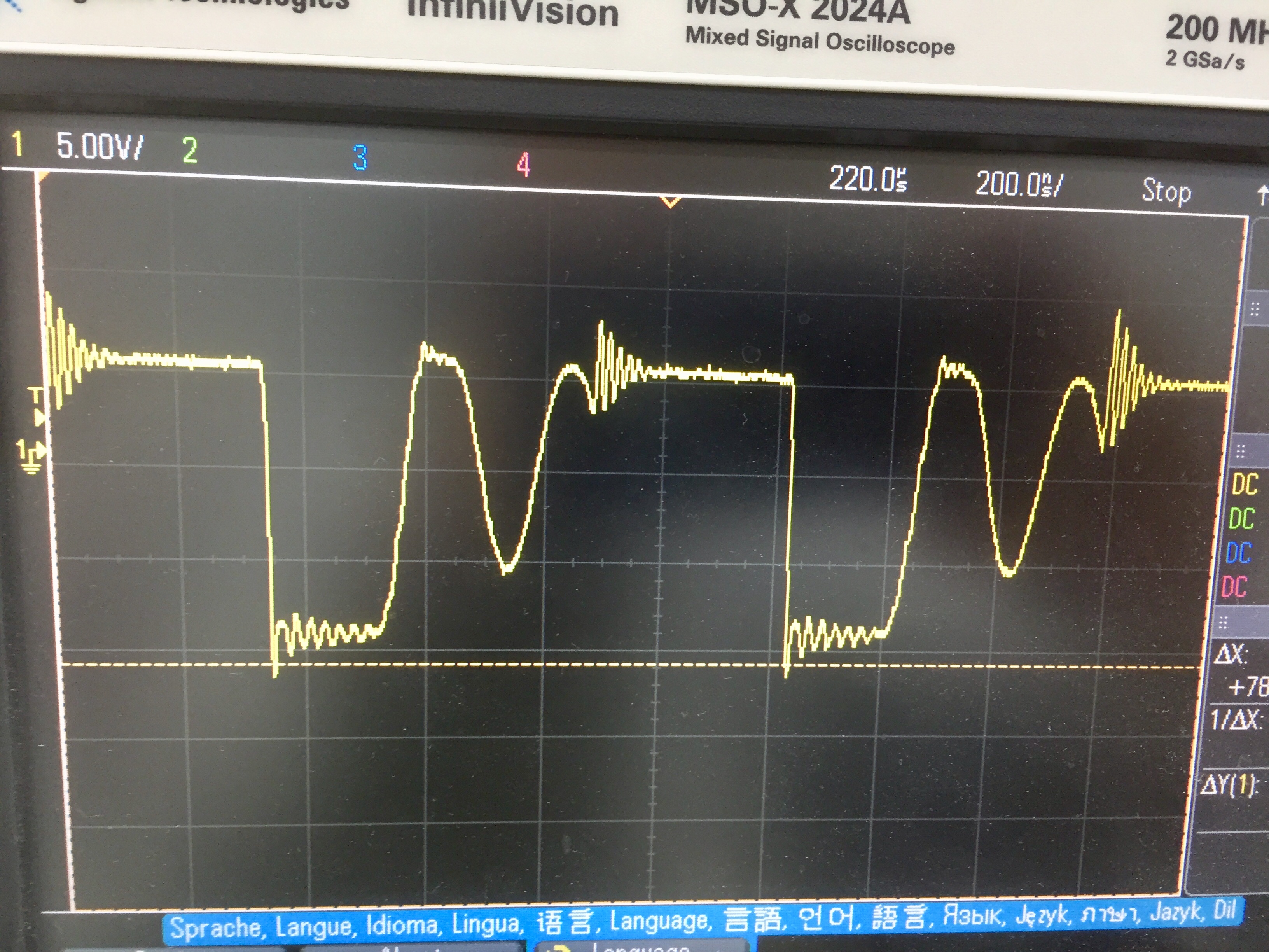

  • Hi Rick,
    I see your point, but the VN capacitor is well connected. I've double checked and even added more capacitance (4.7uF vs ~14uF) and saw VN rise/fall time becoming longer respectively.
    I've captured the VN_SW herein (both images) and it looks strange:
    Thoughts?
    Gal
  • If these voltages were confirmed at the VEE_IN test point, the VN pin (26) might be damaged and the part may need to be replaced.
    Rick S.

  • Hi Gal,
    While DCDC2 is the first regulator in the sequence and will boot independently, after it successfully regulates an undervoltage fault on VB will also shut the device down. However it does not seem that we are getting to this stage if no voltage at all is appearing on VN.
    Please also ensure the power-pad (PBKG) is connected to VN.
