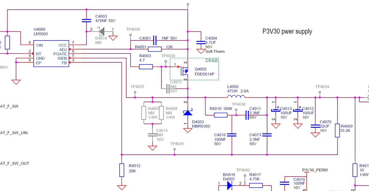

Hi everyone,
I am currently using the LM5085 DC/DC converter in order to convert 28V to 3,3V output :
We would like to improve the switching frequency thanks to the Rt resistance (R4002 in the schematic) and in the same time we would like to keep a good stability of the switching frequency.
I tried to change the switching frequency (resp 600kHz and 800kHz) but more it is big more the circuit is not stable ...
In the same time, I calculate the adjustement ripple circuit (R4010 + C4011 + C4016) thanks to this document : Transient response versus ripple - an analysis of ripple injection techniques used in hysteretic controllers, especially for the 600 kHz switching frequency, but the LM5085 seems to be unsteable.( We chose 100 mV output ripple for our application.)
Do you know if this integrated circuit has some metastability criteria above 400 kHz switching ?
Do you know some tips to fix Fsw ?
I would be grateful if you could answer this question as best as possible,

  • Hi katelyn,
    Thanks for your answer. I put the schematic in attachement :
    Can you see the image ?
    Olivier D.
  • Hi Olivier,
    Yes, I can see the schematic now. Thank you for sharing again.
    My recommendation is to start with the Quickstart calculator on the product folder. As you change the switching frequency, the passive components in the applications circuit will need to change accordingly.
    What is your input voltage range adn output current range? I will also simulate the design with the calculator if you can share this information.

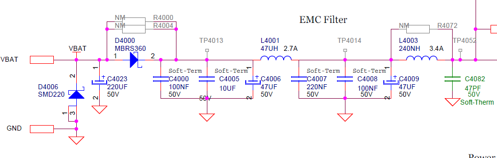

    We designed an EMC input filter from the voltage supply line :
    We have chosen a pi filter which filters the 28V input voltage. Our requirements are the following :

  • Hello Olivier,
    By changing the switching frequency, you will need to re-verify the passive components for stability (COMP, output inductor, COUT).
    What frequency spectrum are you failing the CISPR limits in? Is it the emissions due to the switching (FSW, harmonics of the switching frequency)? Is the switch node waveform clean - is there ringing on the switch node waveform?
    You can also try increasing the values of C4000, C4005, C4007 and C4008 to see if this improves the performance.
    Also, where are the self-resonant frequencies L4001 and L4003?

  • Hi Olivier,
    Using a shielded inductor as well as the shielded hood should definitely help.
    If you are having trouble at the switching frequency and its harmonic, I recommend focusing on the input filter components. The input filter is critical to filtering out the switching frequency. I would go through your filter components and recalculate to make sure you have optimized these values: www.ti.com/.../snva489c.pdf
    I would start with changing L4001 and L4003 to inductors within the range of 1uH - 10uH. Then calculate the necessary capacitance, and also calculate the necessary ESR for your electrolytic capacitors.
