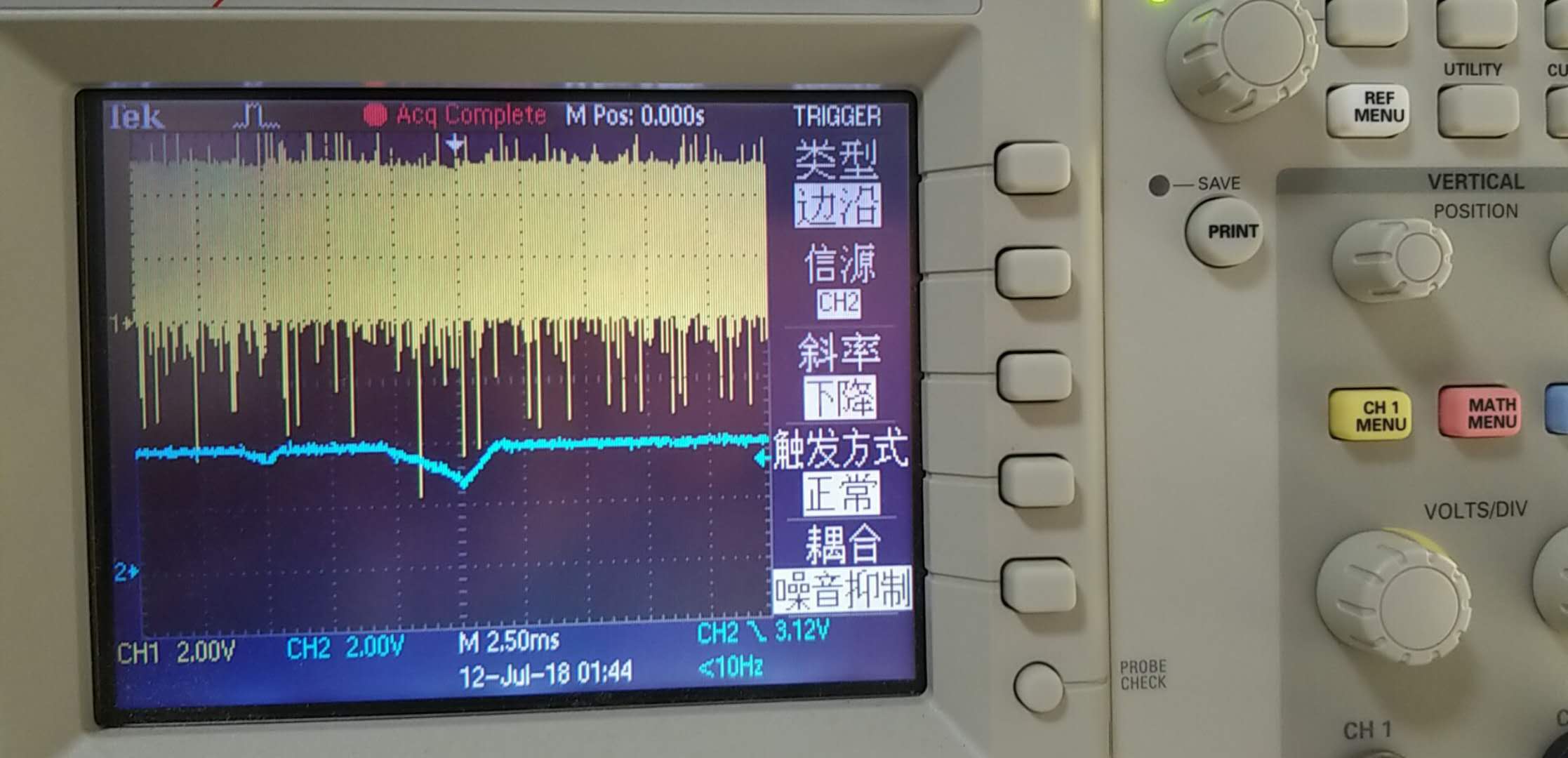

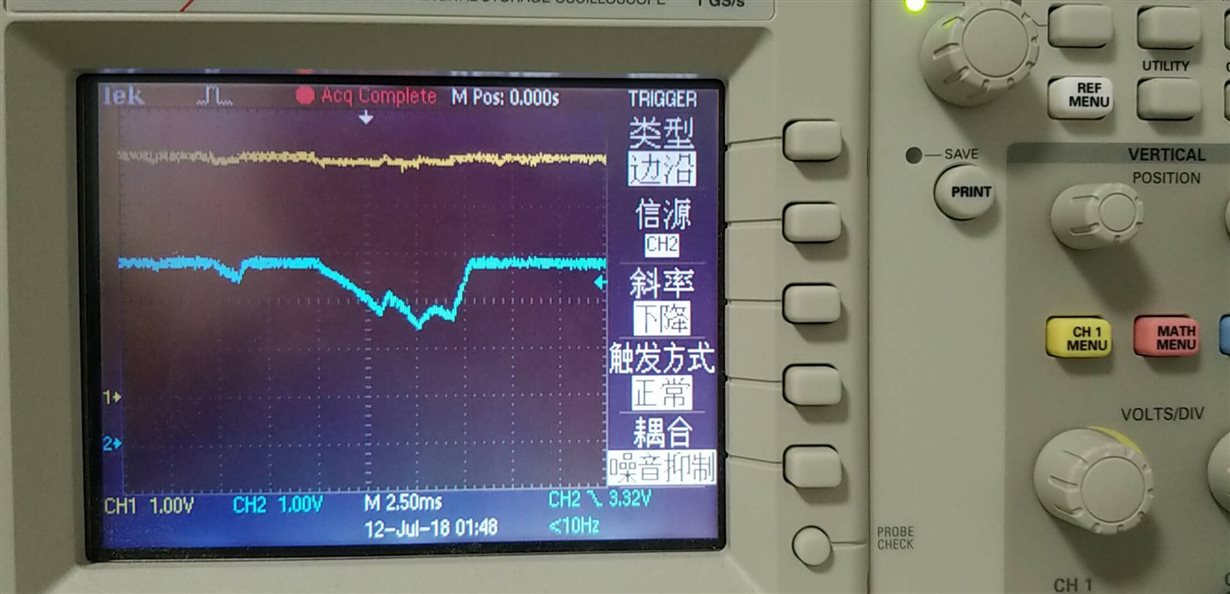

    More description: In my application with my board, when WIFI disconnected, the board takes 250-300mA current with 5V supply. And when WIFI connected, the current consume increase to 350-400mA with 5V supply.

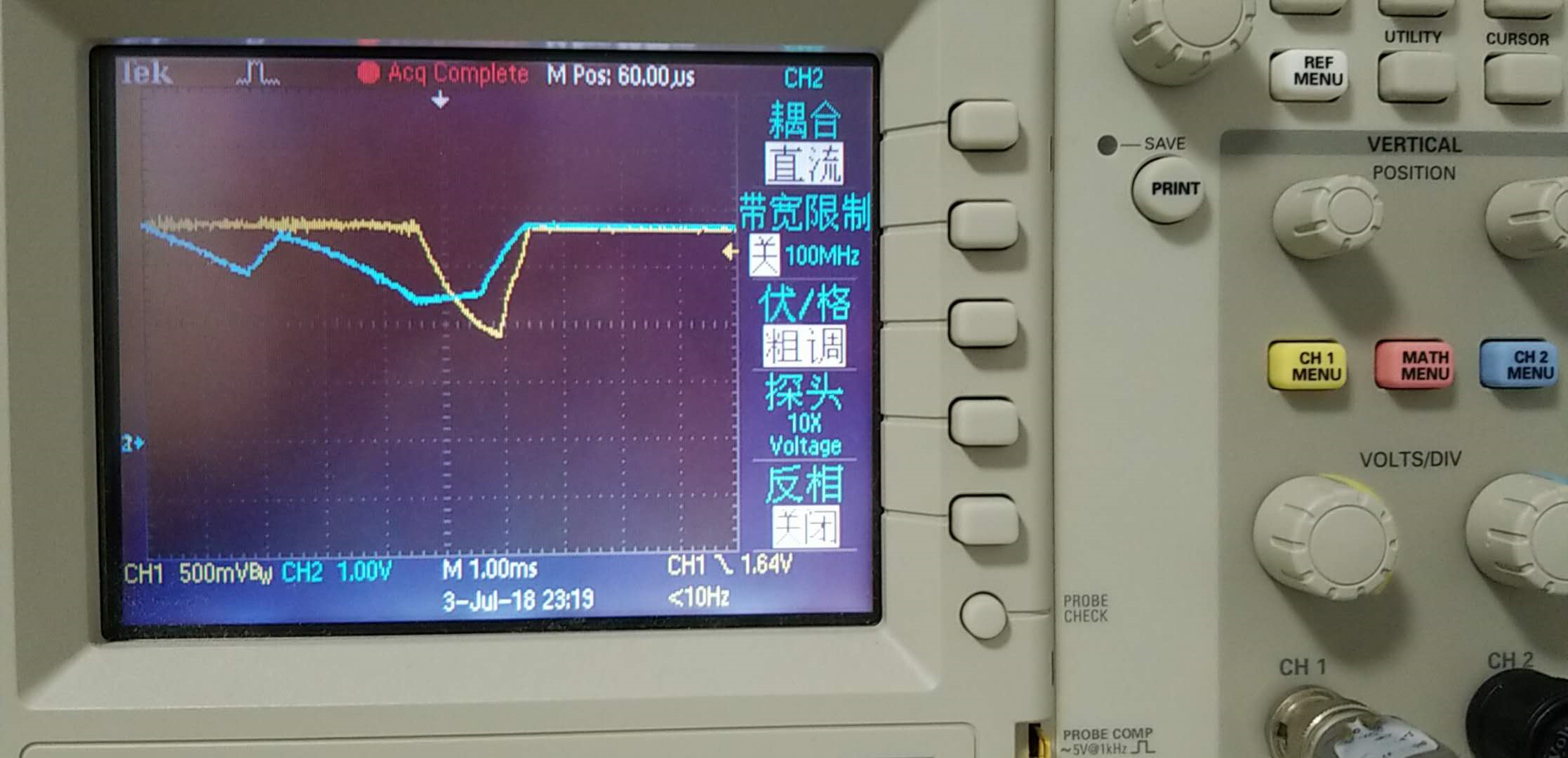

             In Case 3, the application works well when WIFI disconnected. But when connecting to WIFI, the DSP is reset, and with the oscilloscope I find the Vsys has a drop.
             In the above figure, the blue channel is Vsys and the yellow channel is 1.8V for DSP. When the board try to connect to WIFI, the current increase and the bq25890 cannot afford sufficient current, so the Vsys drops.
             In Case 1 and Case 2, the application works well both when WIFI disconnected and WIFI connected.

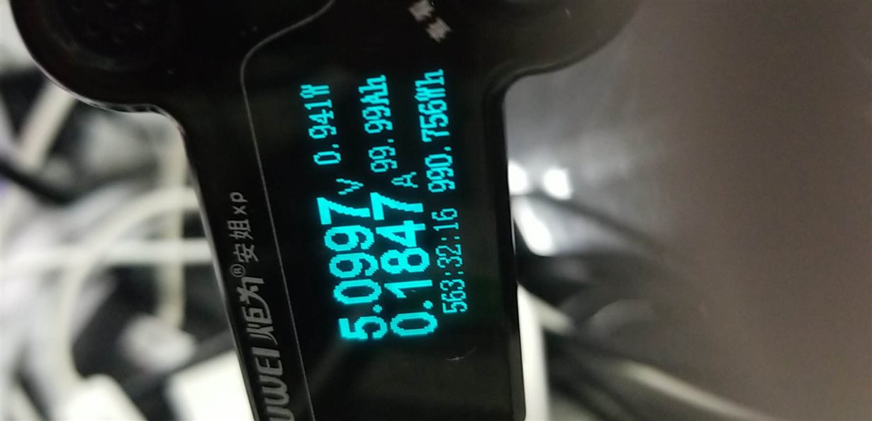

    When WIFI is not connected, the current is 250-290mA, the VBUS voltage at VBUS pin is 4.97V.
    When connecting WIFI, VSYS drops, but the VBUS pin never drop.
    For test, when connect the VSYS with a 4.7 Om resist load, the VSYS is 1.65V, but the VBUS pin is 5.03V.

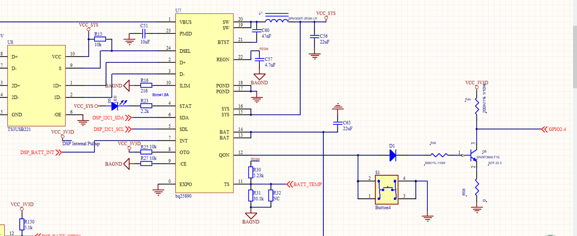

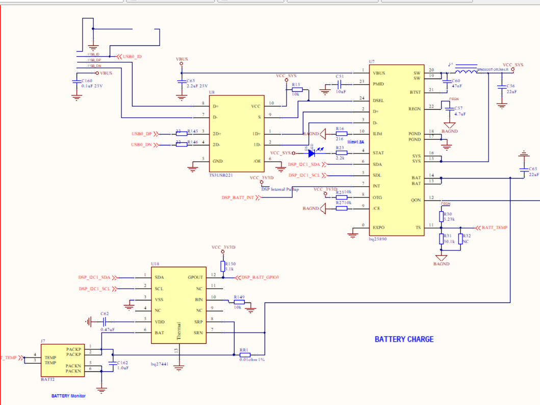

    Can you send the schematic for the bq25890, including inductor part number? Do you have a way to read the I2C registers when this is happening, including an ADC measurement? The status registers will tells us what is happening. If not, then can you send oscope plots of VBUS, SW and SYS when this occurs?
  • Hi Jeff,
         The schematic is below:
       The inductor I use is SPM3020T-2R2M-LR
       And althrough the I2C is connected to DSP, but the DSP is reset when the SYS drops. I cannot get the register when this happens.

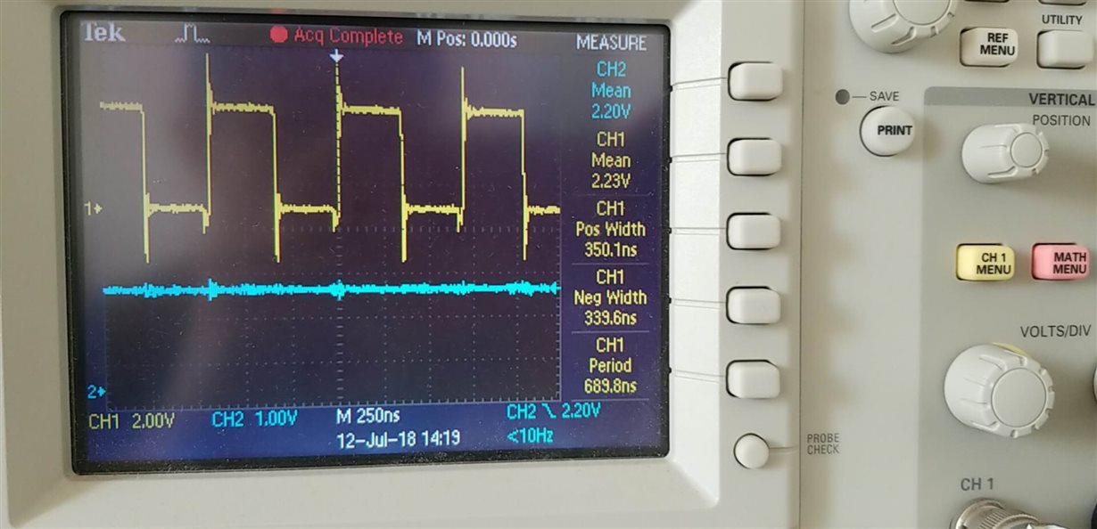

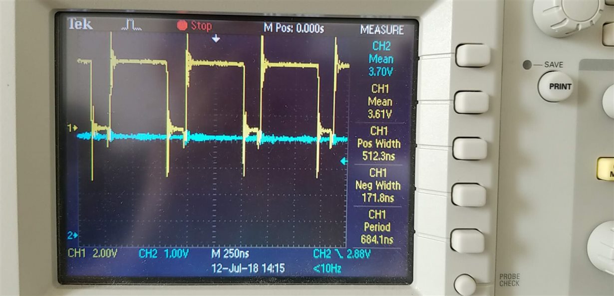

    Can you zoom in on the SW pin when SYS drops out to show the squarish waveform like shown in d/s figure 54? Do you have a way to measure the charger's input current? I strongly suspect the charger is input current limited.
  • Hi Jeff,
         Thank you very much.
         The 2 figures below shows the SW (yellow) and SYS (blue).
         Figure 1, the WIFI is not connected. Figure2, the SYS drops when connecting to WIFI (I set the trigger level to 2.2V, falling edge). Since the SYS drops in several ms, you can see the SYS is a straight line in 100ns scope.
    Figure1:
    Figure2:
    The auto measurement in Figure1 is not acurate because of the over shot. The cursor measurement is:
                    VSYS                     Pos Width            Neg Width
    Figure1    3.7V                       528ns                   160ns
    Figure2    2.2V                       352ns                   336ns

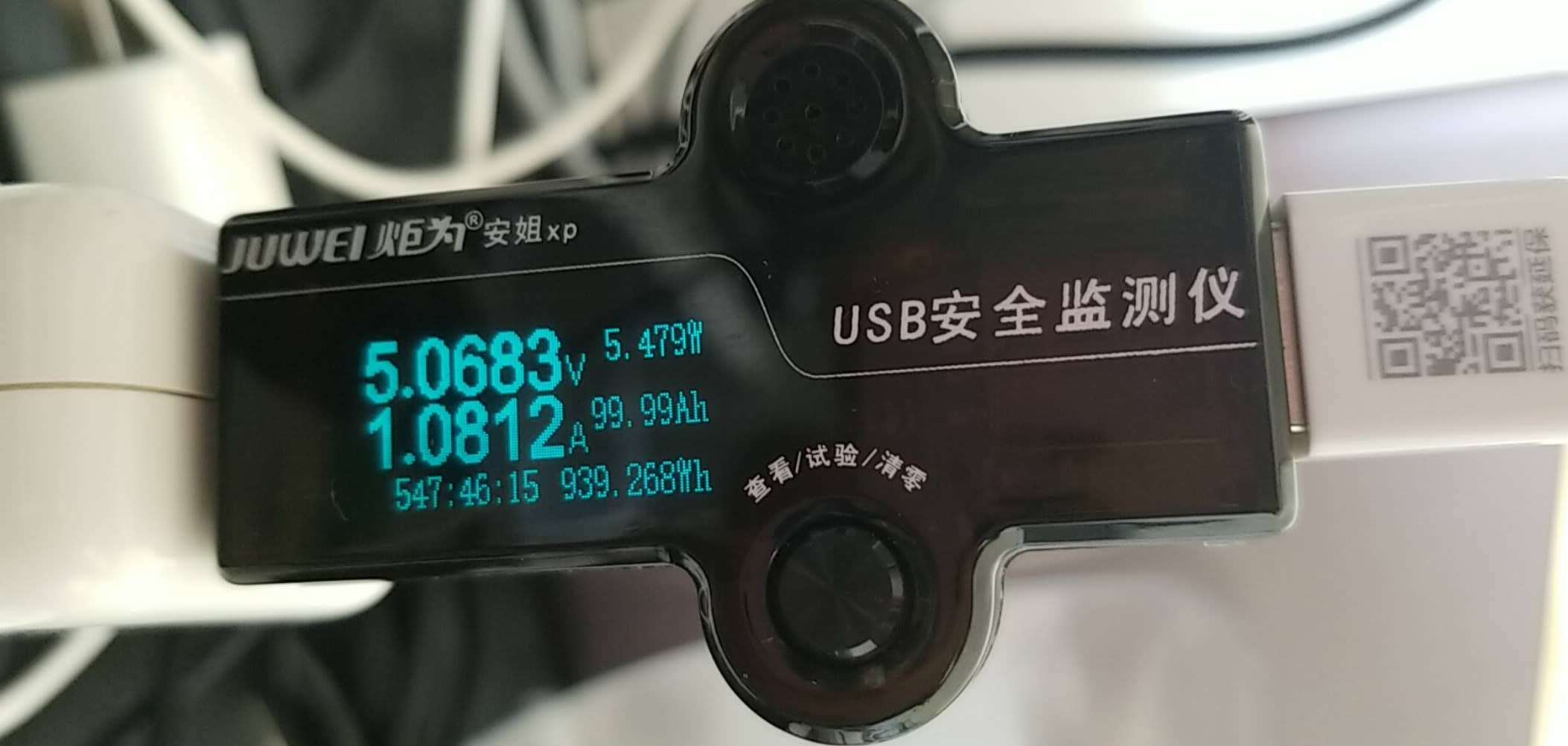

    I use another 2A charger and use the USB current meter to monitor the current. When the battery is on, the current is 1.08A. So I don't think the problem is because of the input current limited.

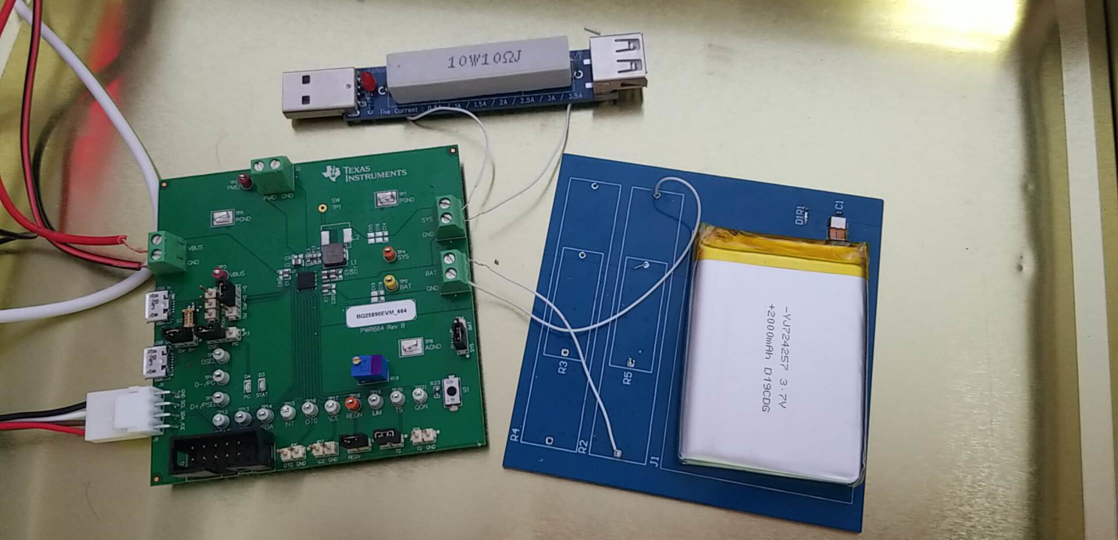

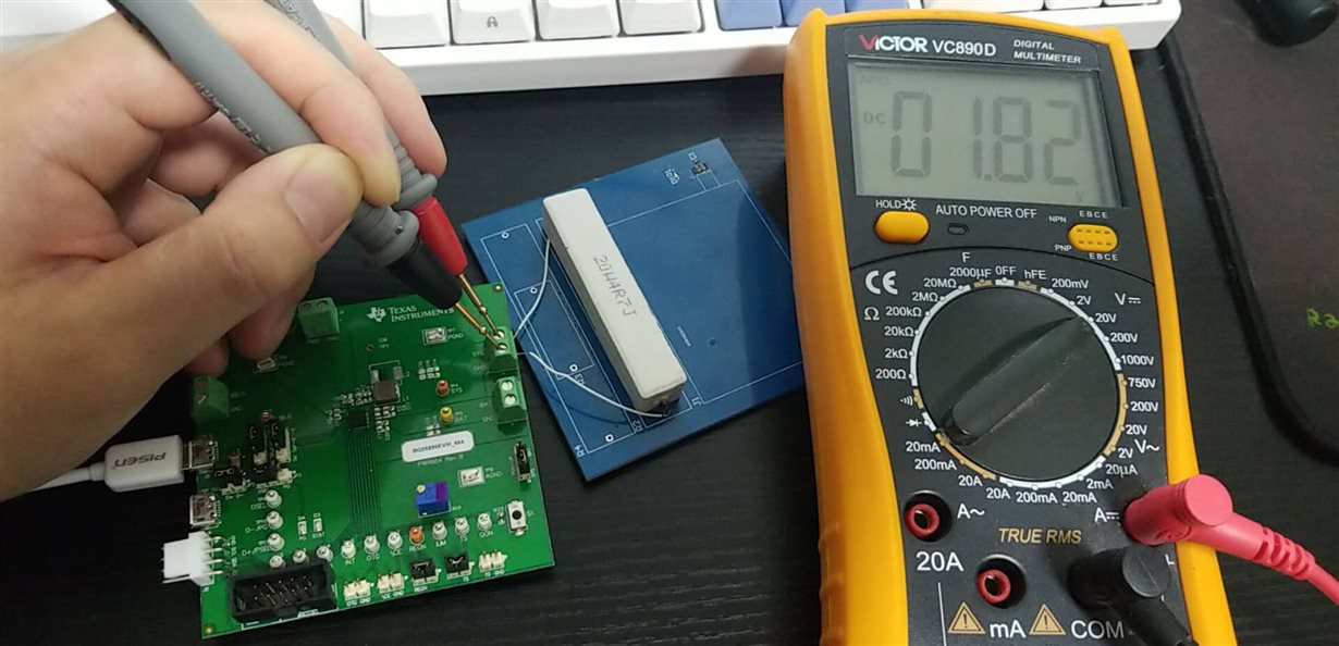

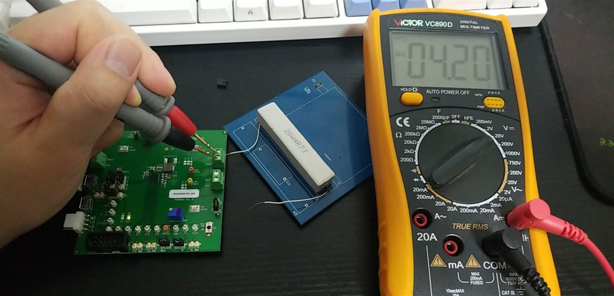

          I ordered a BQ25890EVM-664 from TI and today I got it.
          TEST1. I use a 4.7Om load for test.
          1. When no load is put at the VSYS, the VSYS is 4.2V. (D+ D- not shorted)
           2. Then, I put the load onto the SYS while keeping the board powered by the VSOURCE. The VSYS drops to 1.82V which is similar to the phenonmen that happened on my board (1.75V). Here now, the VSOURCE keeps on 5.08V and the current is 0.18A.
       3. I also repeat the above experiment with D+ D- shorted. The exactly same phenonmen happened, the VSYS droops to 1.82V.
      4. You can see that the Vsource did not drop. And the Vsource is a 2A charger and as I said, when the battery is put on, the meter shows the current is 1.08A.
          And I also tried the experiment without the meter. The exact phenonmen happened.
    5. If a 10Om load is used. The VSYS is 4.19V and everything is OK.
        So, I think the bq25890 VSYS can not provide > 4.2/4.7=893mA current when battery is off.
        Question1. What is the maximum current that the VSYS can provide when the battery is off?
        TEST2.  Compare my board with BQ25890EVM-644.
        Both the boards can not drive a 4.7Om load.
        When the load is 10Om, the VSYS on my board is 3.64V while the VSYS on EVM is 4.19V.
        Question2 : What is the difference between my board and EVM?
        Question3 : The STATE LED on my board blink once at a time, while the STATE LED on the EVM blinks much quickly. Why?

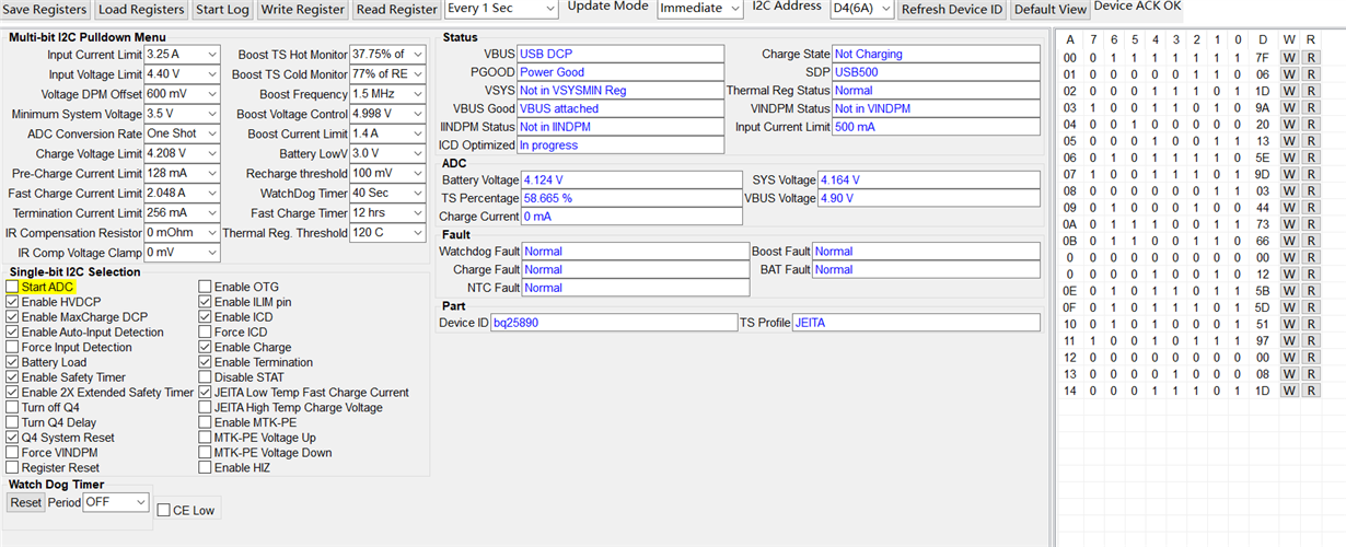

  • Frank,
    I have used the bq25890 to provide well above 2A from 5V/3A input so I know it is capable. To summarize:
    1. At startup with SYS < ~2.0V, input current is limited to 200mA so the charger will not startup into 4.7ohm.
    2. After startup, the input current limit is clamped to the lower of the setting per the ILIM resistor or setting in the IINDPM register. With the 890, the IINDPM register is configured by D+/D- pins. With D+/D- shorted, IINDPM is 3A but, unless you disable ILIM resistor via I2C or also change resistor to set it to 3A, the ILIM resistor clamps the input current below 3A. If I recall correctly, the EVM ILIM resistor has a potentiometer in parallel with fixed resistor. If you increase the potentiometer to the maximum, so that help?
    3. If the load transient caused by quickly added such a large load causes the SYS voltage to drop <~ 2.0V, the charger could get confused and think it is in startup, which returns you to condition one above. In that case, you will need to add additional capacitor from SYS to GND that can absorb more of the transient and prevent such a droop.
    With the EVM, you can use the bqStudio I2C software to read the charger's status register, which might tell you the problem. Do you have an EV2300 or EV2400 I2C box to use with the software?
  • Hi Jeff,
        I find that the JP10 is shorted with a jumper on the EVM, and the VSYS is 4.2V. Remove the jumper in JP10, the VSYS become 3.65V.
        In my test, the RLIM is 130Om on the EVM (the R19 potentiometer is set to 0Om). So the ILIM is 355/130=2.73A.
        In my test, the 4.7Om load is in parrel with a 1uF cap. With the 4.7Om load, the VSYS is 3.13V.
        And with the 10Om load, the VSYS is 3.65V, when I open the power first, and then connect the load to VSYS manually.
    With the 4.7 Om load:
    The adapter is recognized as a SDP, and the current limit is 500mA. 3.65/4.7*3.65/0.9/5=0.63A.0.5A.
    That's why the VSYS drops. And if I set the current limit to 3.25A, the VSYS can be 3.65V even with the 4.7Om load.
    Thank you for your advice.

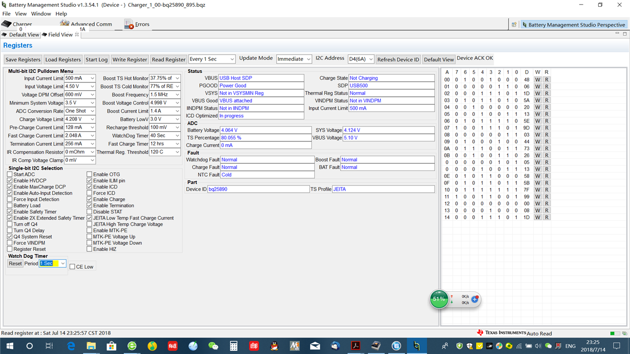

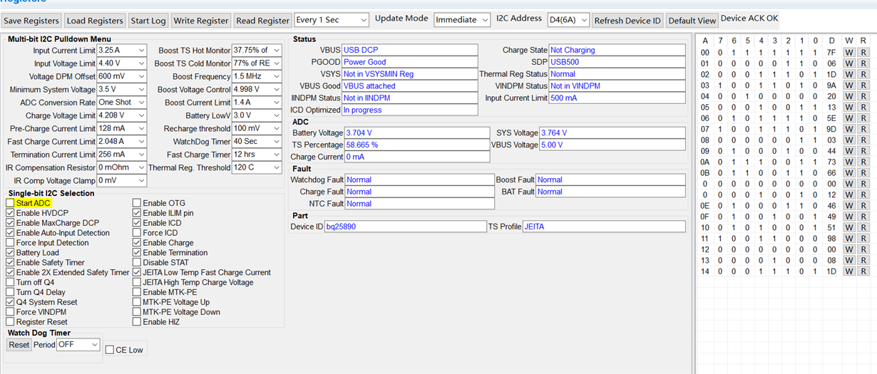

    First, please check the EVM to ensure that it has a bq25890 installed and not a bq25892.  Then, confirm that JP1 shunt is not installed and JP2 shunt is connected between pins 1 and 2.  If you are using a power supply, you can install the shunt on JP5 to short D+=D- and simulate a DCP.  If you are plugging in a DCP adapter, use J5.  If that doesn't work, try flipping the S2 switch.
  • Hi Jeff,
            I use a power supply, set 5V output and 2A current limit. The S2 is switched to the right position which makes D+ D- shorted. The battery and a 10Om load is connected to the VBAT and VSYS receptively. The Rlimit is adjusted to the smallest value 130Om, so the Ilimit set by the Rlimit is 335/130=2.577A.
    The connection is shown below:
    The Vsource is recognized as a DCP, and the regisiters are shown below:
    If the power supply is off, the VSYS is 3.7V which means the power now is supplied by the battery (VBATT is about 3.7V for this half full battery).
    Question 1: Why the Input Current limit is only 500mA?
    Question 2: Why the state is still not charging? The Isource shown in the power supply is 320mA, but if the battery is removed, the Isource is 297mA. So the power supply drives 20mA into the battery. I wait for 10 minutes, the Isoure is still 320mA and the state is still not charging.
    Then I change another battery and switch the power supply off and on. This battery is nearly full, the VBATT is about 4.124V as shown below,
    The state is still not charging, and the input current limit is still 500mA.
    But this time, the Isource is 370mA, which means about 70mA is driven into the battery. But the state is still not charging.
    Please help. Thank you.
    B.R.
    Frank

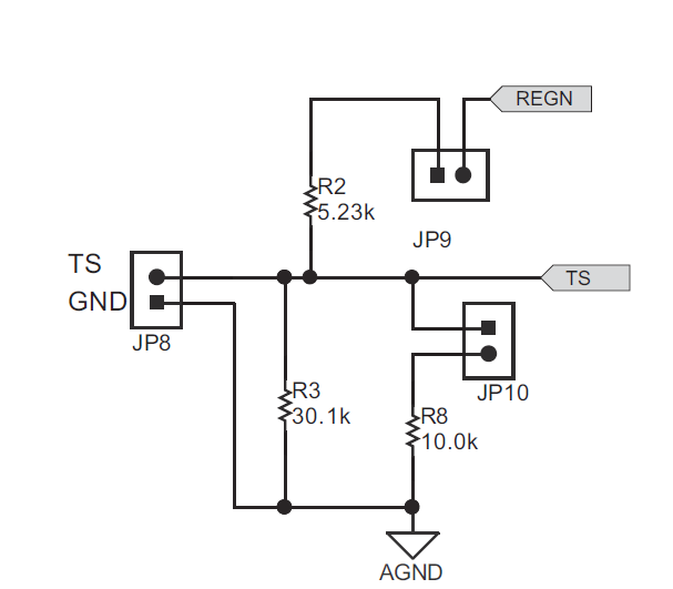

  • Please note that battery charging is enabled when CHG_CONFIG = 1 and CE pin = Low. CE pin must be Low to charge. Please install JP7 shunt: JP7 CE pin setting: pull low to enable the charge.
    The input current limit detection is correct because REG00[5:0]=3.25A (top-left corner on the GUI) for DCP.
    For REG13[5:0] (shows Input Current Limit=500mA), it is the input Current Limit in effect while Input Current Optimizer (ICO) is enabled. Since REG14[6] (Input Current Optimizer (ICO) Status) shows “In Progress”, ICO current limit is not finalized, i.e. REG13[5:0] does not show the final ICO current limit yet. To avoid confusion, please set Enable ICD (REG02[4])=0 (i.e. disable ICD) and read registers again.
    Thanks!

    0x51
    REG11
    0x96
    VBUS=4.8V
    0x98
    VBUS=
    REG12
    0x0
    IBAT=0mA
    0x0
    IBAT=0mA
    REG13
    0x8
    In VINDPM
    Not in IINDPM
    IDPM_LIM=500mA
    0x3F
    Not in VINDPM
    Not in IINDPM
    IDPM_LIM=3.25A
    REG14
    0x1D
    Optimization is in progress
    0x1D
    I think the only difference between my board and EVM is that I use a bq27441 to monitor the volume of the battery.
  • I removed the bq27441 from my board, but it doesn't change anthing.

  • For your board without battery, REG0C=05 (TS cold). Do you know why? Thanks!
  • Hi Ning T,
         Thank you very much for reply.
         Because there is a JP10 on the EVM board, while my board do not have. When the 10k is connected, TS will be normal.
         When I remove the JP10 jumper of the EVM, the EVM is also TS cold. But the EVM can still recognize the DCP correctly.
         B.R.
    Frank
  • Hi Ning T,
           I've found the cause of my problem.
           In my schematic, I use a TS3USB221 to switch between the Host D+D- and the bq25890 D+D-, which is similar to the typical application example shown in bq25890's datasheet.
           But the TS3USB221 is powered by VCC_SYS. So when the battery is off. When the USB is plugged in, the VCC_SYS is 0, so the D+D- does not get through. So the bq25890 cannot recognize the USB connectly.
           So, I should use a USB SWITCH whose VCC can be 5V to 14V, since there are many 9V fast USB charger. But I find there is no such USB SWITCH which can tolerate 9V or 14V.
           So, the solution is that I can use a 5-14V input 3.3V output LDO to power the TS3USB221. I think hat will make bq25890 recognize the USB source correctly when the battery is off. Do you think the solution is OK, could you give me some advice?
           Thank you.
        B.R.
    Frank
  • Referring to bq25890 EVM design www.ti.com/.../sluuba2b.pdf, it uses a 3.3V rail to supply TS3USB221 and the 3.3V is generated by VBUS via a LDO. Thanks!
