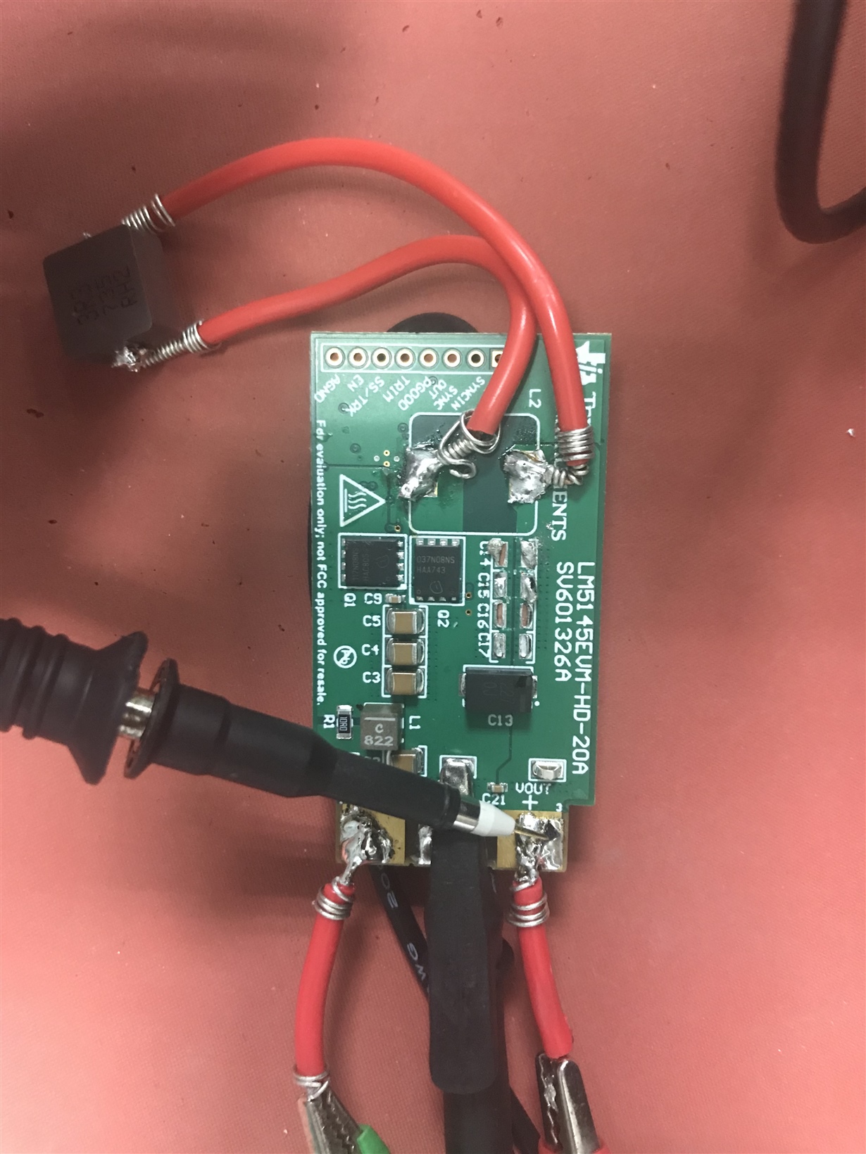

Hi experts,

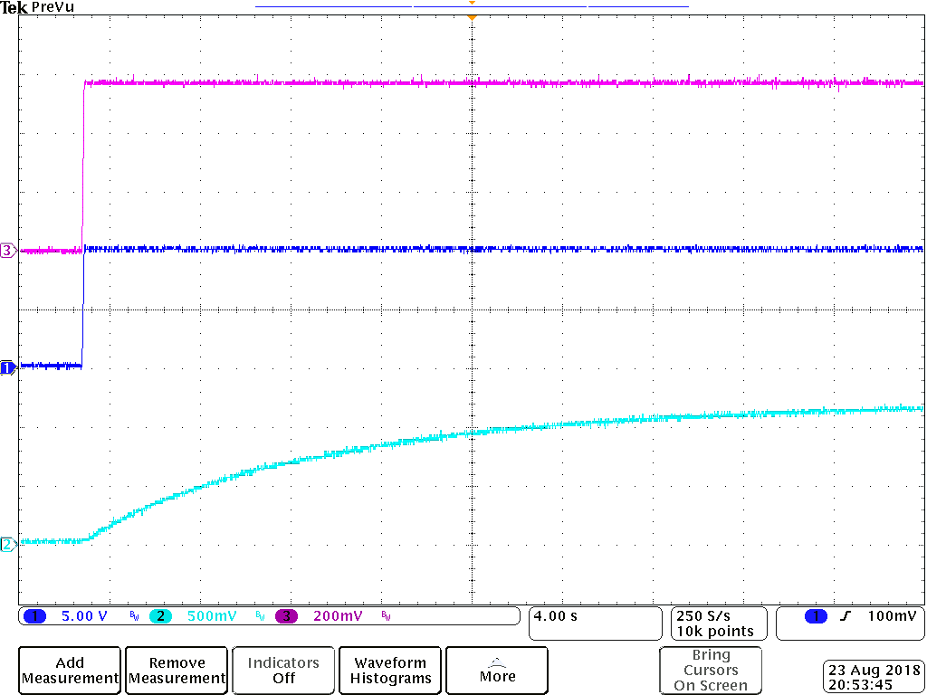

Using LM5145 EVM, when controller enters standby mode, there is a approximately 1.2V Vout in over 40s. And I am also wandering why there is a standby mode in almost every buck controllers which are with UVLO. The corresponding pic is shown as below: in which
Red line indicates UVLO;
Blue line indicates VIN;
Sky-blue line indicates Vout.
My questions are:
1. Why controller must feature Standby Mode? Is it because VCC needs time to rise?
2. Why there is a 1.2V output with rise time RC similar to Cout*(Rfb1+Rfb2)?
Thank you very much for your help!
