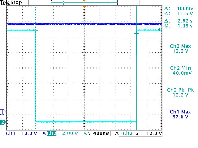

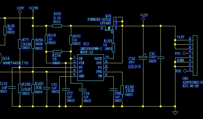

Our customer is using our LM25069-2 as Hotswap application. 12Vin, 12Vout. They tested the current limit operation:
1. Normal room temperature: CH2: 12Vout.  Ignore CH1; We can see the restart time is about 2.62s. It is right. Just short the output 12V to GND for 0.5s.
2.   -10C temperature:  CH1: 12Vout.  Ignore CH2; We can see the restart time is about 2.62s. It is incorrect. Just short the output 12V to GND for 1.5s.
Please find the Sech:
So why is ti different at different operation temperature? Could you help us check if our application circuit is correct?
Your feedback are appreciated.
