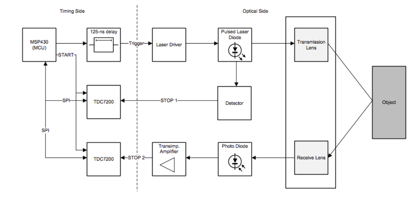

  • Well we Haven't gotten to the design phase. We are trying to create a LiDAR application that measures the distance of an obstructing object. We are trying to find a laser driver to drive the laser diode, so yes, we are trying to directly drive a laser diode directly. For instance, we want to drive the follow laser, HFE6192-761. We want this to then be pulsed and create a pulse width of under 5 ns. Our product needs to be efficient so we need to find a laser driver with low output current. This is the general schematic that would be implemented
  • Thanks for the application schematics. The totem-pole driver inside LMG1020 is meant to drive a GaN FET; thus FETs inside the driver are too large for this application. The maximum switching frequency is limited to 60 MHz due to thermal constraints. Therefore, it is not possible to get 1 Gbps with LMG1020. This driver is not optimized to directly drive a laser diode. It would only be viable solution if you switch less than 60 MHz.

  • What if we did not directly connect it to the laser diode? is there a way to input a MOSFET in between to lower the current?
  • A simple resistor in series should limit the current. It looks like that diode as a ~2V foward drop, so with a 5V supply 3V would develop across the resistor. So if you want 20 mA current, 3/20mA=150 Ohms in series with the laser diode directly connected to the LMG1020 output should do what you need.
    Also, to clarify Serkan's comment above, 60 MHz is not a hard limit, the limit is thermal. You can switch it faster if you respect the thermal limitations. (i.e. sending bursts of 200 MHz pulses could be fine)
    Nathan
  • so it is possible to drive a laser diode directly? is their any drawbacks from simply placing a resistor in series?
  • The current will have some variation due to the variation of the forward voltage of the laser diode. Other than that, it should work fine.
