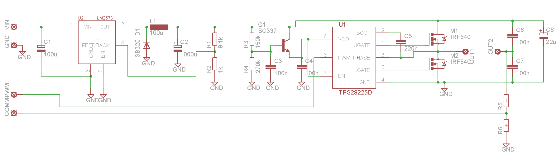

I have some issues building the circuit below. I have problems gettign teh TPS28225D to work properly. I am trying to build a wireless power transmitter, however, when i connect the transmitter coil to the OUT1 and OUT2 connectors, the UGATE voltage of the IC fails. Without the coil, the IC provides good voltage levels. I just cannnot figure it out. I assumed the PCB layout may not be good, otherwise i am using the exact same schematic as the BQ500410A wireless power transmitter uses. The bootstrap and drive capacitor values are the same as well.

    I do think you may have a problem with your circuit. C5 is going from the PWM IC out to C5 to pin 2 on U1. Where is your coupling cap for U1? You need a good size coupling cap, 1 uF or larger at pin 6 to ground. The cap should be placed as close as possible to U1.

    The track for C5 is indeed connected improperly, i have already soldered it directly to the IC's pins, but it didn't solve the issue. The coupling capacitor is C4, which is currently 220nF. Texas Instruments was using a 100nF there, but I figured it might not be enough, i will definitely try using a higher capacitance capacitor.

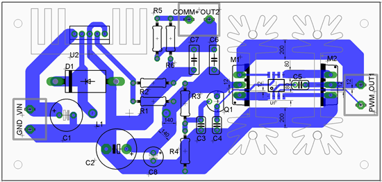

    I know the PCB layout isn't great, but i had to do this on one layer. I simulated the entire design in PSpice, using OrCAD,it worked exactly as it should. I used an inductance value of 5 uH for the coil.
    I dont know what could cause the problem, C4 is not close to the IC, so that may be it.
