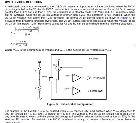

I evaluate the LM25037 EVM which is modified to lower UVLO threshold  (R4 9.76kohm -> 15kohm) .
I obtained a strange behavior which is following duty cycle.
There are large changes of the duty cycle for the variation of the input voltage(Vi=11V -> Vi=10.7V).
Why does this phenomenon(large changes of duty cycle) occur?

    You need to check the uvlo leakage current, Iuvlo. The maximum value is listed on page 4 of  LM25037 data sheet. It says the leakage current out of this pin can get as high as 26 uA. The sink voltage is 0.6V, this means there is a maximum parasitic resistance of approximately 23 kohms in parallel with you 15 kohm. This drags down the value of the 15 Kohm voltage and causes your circuit to go into UVLO at a higher input voltage than you planned.
    If your chip has a worst case Iuvlo of 26uA and a Vsink of 0.6V, you have an effective leakage resistance of 23 Kohms in parallel with your 15 Kohm bottom resistor. This will cause you to go below the UVLO threshold of 1.23 V at an input voltage of 14.8 Vs.
    The 26 uA is a worst case maximum, so it appears you have only about 6 uA of leakage at that pin. So your UVLO trip point is around 10.7V.
    With a minimum of 0.35 uA  Iuvlo leakage it's about 9.5 Vs. So 6 uA of leakage current raised the UVLO threshold 1.2 Vs.
    You need to account for this leakage current when you design you voltage divider. It may not be as high as the data sheet since this is a worst case maximum.

  • Koji,
    R2 controls the current used to charge up the Vcc pin cap. So maybe in the "typical" schematic they chose a better value for efficiency after some testing. R7 is the R part of the current sense RC filter so maybe they had to adjust it to keep it from shark toothing the input signal at very high load or not having enough noise rejection. And finally R8 is a part of the compensation network. It is used to form a pole with C11 and a zero with C8. So probably they had adjust these values to make the circuit stable.
    I also noticed that the specification on that apnote for the eval unit list the input voltage range for regulation from a minimum of 16 V to 32 V. And the same specification shows the UVLO trip voltage at 14 V, just like you have in your scope plots. So that means that from 14 V to 16 V, they do not guarantee regulation. I think that is your problem. Or actually you don't have a problem. You set your new UVLO trip point to 9.56 V. So you should leave 2 V margin for the minimum input of regulation. That means you now have an minimum input voltage of 11.56 V. So when you go below that voltage, your converter starts to go into standby mode. In other words, you need to set the UVLO trip point 2 Vs below the design minimum input voltage for regulation.

  • Koji,
    Your questions below:
    #2.As you mentioned, 'In other words, you need to set the UVLO trip point 2 Vs below the design minimum input voltage for regulation.' I do not understand what does it happen if the VIN fall below the margin of the 2V. At the EVM-2 the abnormal duty cycle which is occured at the EVM-1 is NOT occured.
    If you look at the UVLO divider selection shown above, you will see how the voltage divider components are selected. There is a current source that influences the UVLO trip point so that it trips "on" at on one voltage and "off" at a lower voltage. So in the case of the original design, the converter turns "on" at 16 Vs, but trips "off" at 14 Vs. So they have designed the UVLO to have 2 Vs of "hysteresis". You need to use these equations to select your divider components.
    As far as the abnormal duty cycle phenomena, I have no idea why that is happening. Probably the only one who knows that is the IC designer. It could be that the 22uA current source is turning on too quickly or overshooting and modifying the duty cycle. It could be that the IC's gate driver section has a problem. The only way to know is to change out the PWMIC and test. But if the duty cycle problem is occurring at a voltage below the minimum operation voltage, does it matter?

  • Hi
    I am sorry for many question.
    I checked UCLO trip point by equation below.
    I think the equation must be below,
    *: It should be (-VPWR) since on the evaluation R1 is 100kohm and VPWR is 14V, VHYS is 2V.
    What do you think?
