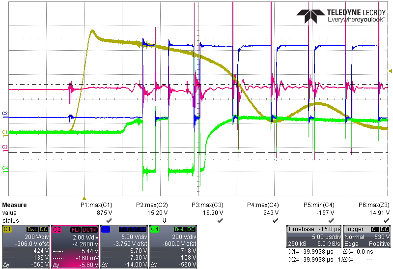

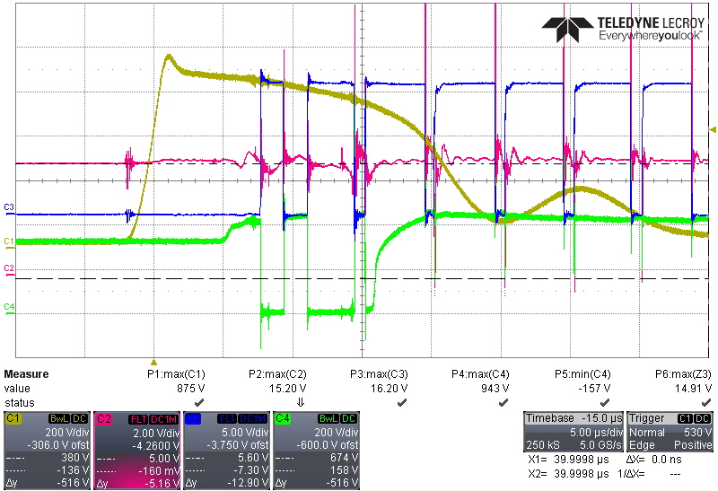

The IC active abnormal when surge happens.
The main issues are:
  1. Comparing with former DCBUS voltage, the Vsense voltage should be higher than OVP point all the time. But from the waveform, the vsense voltage have fluctuation to drop down to 5.1V
  2. When the vsense voltage>5.1V, there still be big duty cycle here.
About first issue , I think we need to increase the vsense capacitor. But I am worrying about whether bigger capacitor would significantly reduce the control response time to output voltage deviations.Now the capacitor is 1n
About second issue, Is there any inference that would cause the OVP disable, please?
Channel 1: MOV voltage
Channel 2: Vsense voltage
Channel 3: Drive waveform(Gate voltage)
Channel 4: Vds of Mosfer

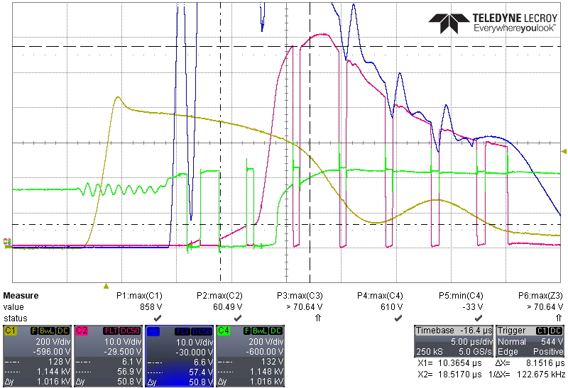

Add a output voltage waveform:
Channel 2: Voltage between Bridge Rectifier pin 1 and pin 4
Channel 3: Bulk capacitor voltage
Channel 4: Vds of PFC Mosfet
    During surge test, the ground noise is significant. This noise  make Vsense very noise.
    1. 1nF capacitor of Vsense pin is OK, you should put this 1nF capacitor very near to UCC28180 to filter the noise.
    2. There are two level OVP of UCC28180. The OVP_L threshold is 5.35V, if OVP_L is triggered, VCOMP will be discharge to limit Duty. The OVP_H threshold is 5.45V, if OVP_H is triggered, PWM will shundown immidiately. Because Vsense didn't exceed 5.35V, the OVP function was not triggered.
    3. Could you capture the VCOMP and ICOMP, the duty is defined by VCOMP and ICOMP.

    1. The capacitor is very near the UCC28180 pin. But as the waveform shows, there are also many noises here
    2. It is very strange. Our OVP set point is 429.339V (calculated by your excel).The Vsense voltage's flutuation would droped<5.35V even when the Bulk cap voltage still higher than 429.339V

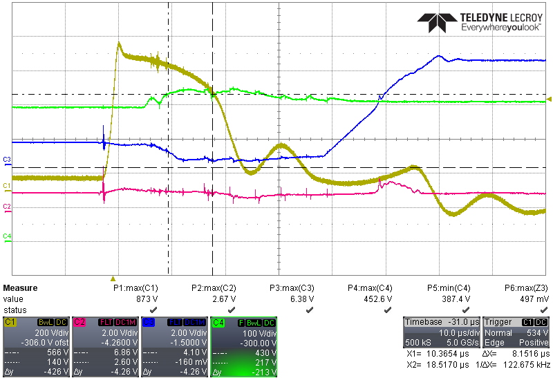

    The waveform of Vcomp and ICOMP are attached.
    It is a little weird that the Icomp is pulled to ~0.2V for a while
    Channel1: Voltage on the varistor
    Channel2: Vcomp
    Channel3: Icomp
    Channel4: Bulk cap voltage(output)
  • Hi, Gene
    1. Though the waveforms, there is OVP_H is triggered during surge test, then PWM is stopped. During the PWM is stopped, the Isense is 0, ICOMP is the average signal of ISENSE, so ICOMP is clamp to minumum level.
    2. I found the Vcomp has 10us spike when the output voltage is still higher than setpoint,  Is your setpoint  400V?
    3. Is there any concern on your board during surge test?
    regards,
    yunsheng

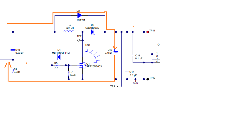

    3. We add a 275Vac varistor after the fuse,and one common choke and one differential choke(paralleling with a diode). The main surge energy flow into the bridge rectifier was absorbed by the Bulk cap in the output.
    BR
    Gene
  • Hi, Gene1. could you check the ISENSE pin wavefrom during surge test?
    2. what is the RC value connect to VCOMP?
    3. what is the C value connect to ICOMP?
    4. what is the RC value connect to ISENSE?
  • Hi Yunsheng,
    Attached is the circuit of PFC part.
    I planned to test the current with current probe.  I would send you the waveforms ASAP
    BR
    Gene

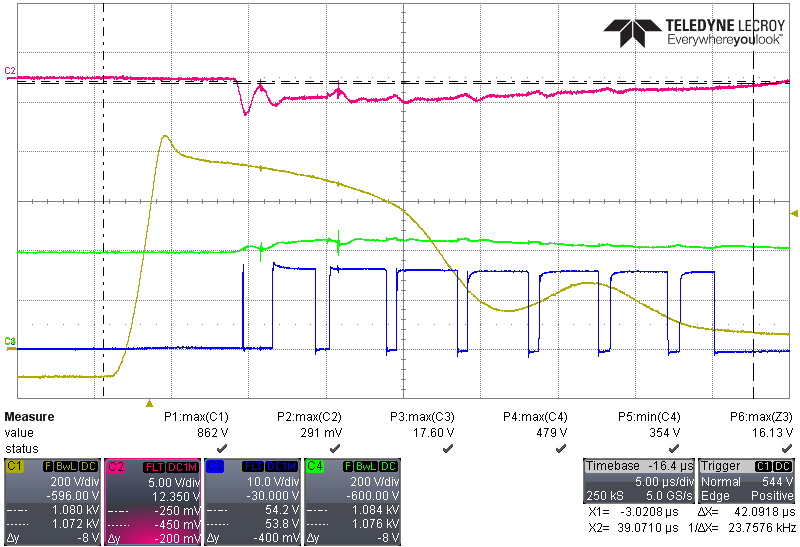

  • Hi yunsheng,
    Isense waveform is attached. You could see the Isense voltage is always higher than 0.44V. But the PWM pulse is not terminated. The maximum voltage of Isense is -3.7V. Is the high peak negative voltage would cause some problems? (In the datasheet, the absoulute maximum input voltage range is -21V to 7V. current is -1mA to 1mA.)
    Channel2: Isense voltage
    Channel3: Gate voltage
    Channel4: Output voltage
    BR
    Gene
  • Hi, Gene
    It is weird the OCP is functional when ISENSE lower than -0.4V. Is the chip normal after surge test?
    1. do you apply a diode in parallel with current sense shunt?
    2. could you increase the R value of RC filter in ISENSE pin?
    Please call me if anything unclear, 13916277909.
    regards,
    yunsheng
