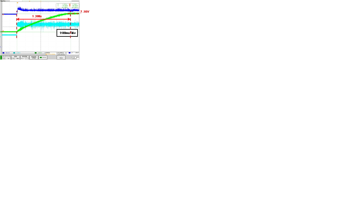

  • Hi John
    Thank you for your reply.
    Our customer measured SS pin,EN pin and Vout when EN was turn on as follow.
    SS pin is raised between 1.388s but Vout is raised very fast.
    And also you mentioned soft start is initiated when the voltage on VCC pin rises to its UVLO point but if it is true , I think Css has been already charged.
    Question
    Why SS pin can be raised slowly?
    Green : SS pin
    Blue : Vout
    Aqua : OVP/EN
    Best regards
  • Hi John
    In my understanding Soft start is started by charging to Css and Css is starting to charge when EN is high.
    I think Waveform in the above is indicated proper operation.
    If your answer is correct , I think Css is starting to charge when Vcc was UVLO point.
    Please support and give your comment.
    Best regards.

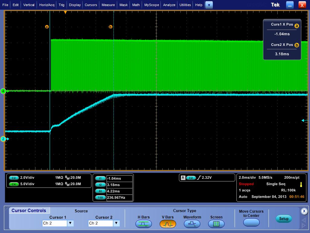

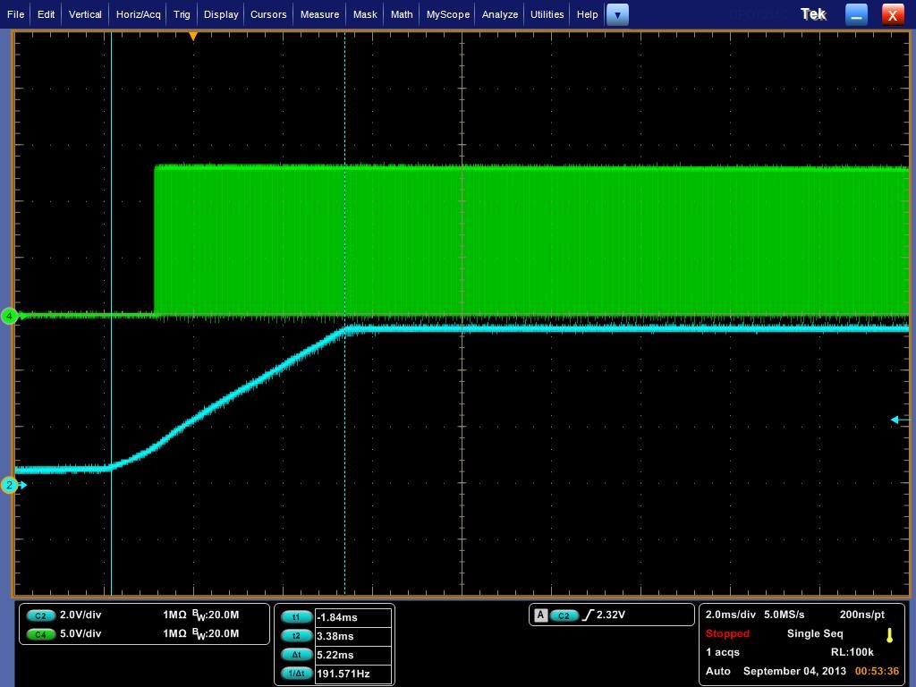

    I can confirm that  Css starting to charge when  EN pin is high, not when Vcc is in turn-on threshold.
    In this case there is not soft-start.
      No soft-start; no delay time from Vcc UVLO and                         Correct soft-start, delayed time from Vcc UVLO and EN
      EN.
      Green: PWM
      Aqua:  E/A
      Best Regards
