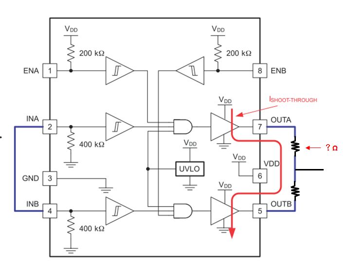

Customer plan to use OUTA and OUTB paralleled like Figure 25 of datasheet, and they are considering to adding gate resistors in series with OUTA and OUTB for control SHOOT-THROUGH Current.
Customer wants to know how to decide resister value.
I think to meet absolute maximum ratings of “Output pulsed source/sink current (0.5 µs): 5A max” total required gate resistor is 12V/5A=2.4ohm min.
Please advise how to decide external gate resister value.
