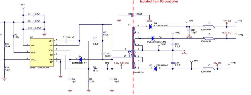

I encountered a problem when I design the Fly-Buck circuit with LM5017.
The below schematic 1 and 2 use two kinds of transfer.
In schematic 2: the 3 isolated output use separated coils.
In schematic 1: the coil of 19V output and 6.5V output is shared.
 My question:
  1. As to the current calculation on secondary side, is there any differences in scheme 1 compared to scheme 2?
  2. Is there any disadvantages(performance, ripple, …) in shared transformers, like in scheme 1?
  3. Which usage is better, scheme 1 or scheme 2?
Many thanks and look forward to your reply!
Schematic1:
Schematic2:

  • Hi Bell,
    In scheme 1, all the load current in both the 19.5V and 6.5V outputs flows in the lower portion of the winding. This increase in RMS current will increase the conduction loss in this winding and will probably require extra strands of wire to carry the current.
    1. Is there any disadvantages(performance, ripple, …) in shared transformers, like in scheme 1?
    Scheme 1 is sometimes more complicated to wind, although this depends on the detail of turns and layer count for the particular transformer
    1. Which usage is better, scheme 1 or scheme 2?
    Scheme 1 is better for cross regulation and is generally recommended.
