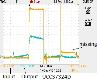

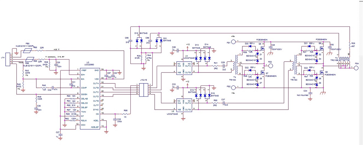

  • Enclosed are the oscillograms showing a right pulse and the following missing. There are two oscillograms as my scope has only 2 channels. I enclose also the schematic of the power part.
    In the waveforms the positive glitch is clearly visible and I suppose that this is what causes de driver to latch up. A schottky diode to VDD removes the spike and solves the problem, as well as a resistor in series.
    The length of OUTA and OUTB tracks are 30 mm and the OUTC and OUTD 20 mm. Both tracks run close and over a ground plane. The driver associated to OUTsCD runs right in several boards tested, so I suppose that inductance in the cause of the spike.
