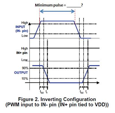

We have question about specification of UCC27517ADBVR.
How about the “Minimum pulse” that UCC27517ADBVR can support?

    I think that there is not Minimum pulse definition because UCC27517A output high level when input signal value is over threshold.
    and threshold value has error as this spec is described in datasheet.
    Is it correct?

    In reading the original posted question: I think you are looking for the minimum pulse requirement of the IN- to switch the driver output.
    The output will respond within the maximum propagation delay that is specified as tD2 in the datasheet. With Vdd = 12V the maximum is 23ns, with Vdd=4.5V the maximum is 30ns. The driver output will respond with an input pulse that is >30ns; according to the maximum propagation delay limitation in the datasheet.
    It is typically the case: where the minimum pulse may be lower than this, since there is delay on the edge to generate a high driver output, and the edge to generate the low driver output.
    I would need to conduct some testing, to evaluate typical minimum pulse requirements, and to see  the mismatch of driver output pulse width relative to narrow input pulse width.
    In this post you mention that the "threshold value has an error as this spec is described in the datasheet". Can you clarify, if you mean the input signal thresholds are not what you expect in the datasheet; or is there some other concern.
