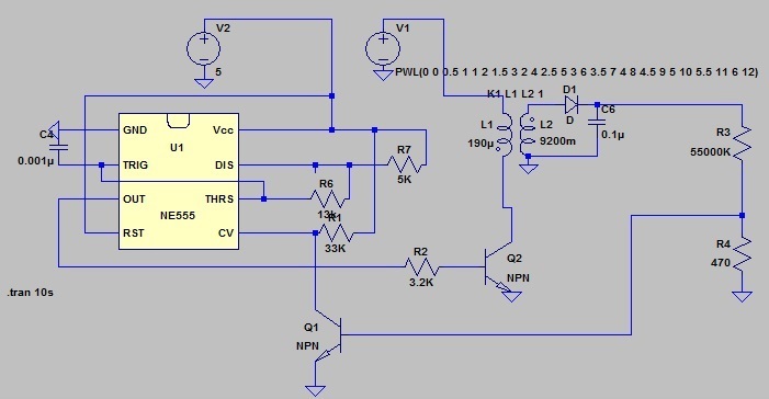

Currently I am designing a DC DC flyback converter:
Vin =0-12V
Vout = 0-2000V with very low current (0.75mA)
For build this I have a flyback transformer with follow specifications.
(EE16/11/4 THT;  Ui = 8V;  Uo1 = 1800V/0.01A;  f = 45kHz)
And actually I am using a NE555 to generate PWM (45Khz), but i would like to know if there are others IC that can be done the same but more efficiently.
