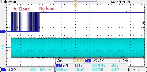

  • Hi, Lisa

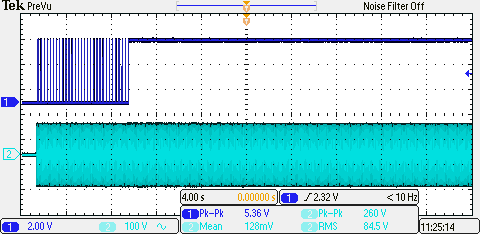

    Thanks for your help. I have tried to short the NTC, but it still can’t start up with full load. From output voltage waveform, it seems that something triggers IC’s protection.
      Channel 1 : output voltage(5V); Channel 2: input voltage(85Vac)
  • I had an EVM available here so I put it in the temp chamber on Friday afternoon and let it soak at -25C for an hour before turning it on at full load and no load. It turned on without issue even with the NTC still in circuit.
    You can determoine if the part is "seeing" a fault if there are only one or three pulses at startup.
    Do you have any other probes on the board? Can you look at the gate drive to see the initial pulses?
    Do you have another EVM to test? Again, keep in mind that the EVM was not designed to operate at anyting other than room temp (I did not spec a temp range when requesting the transformers for example).

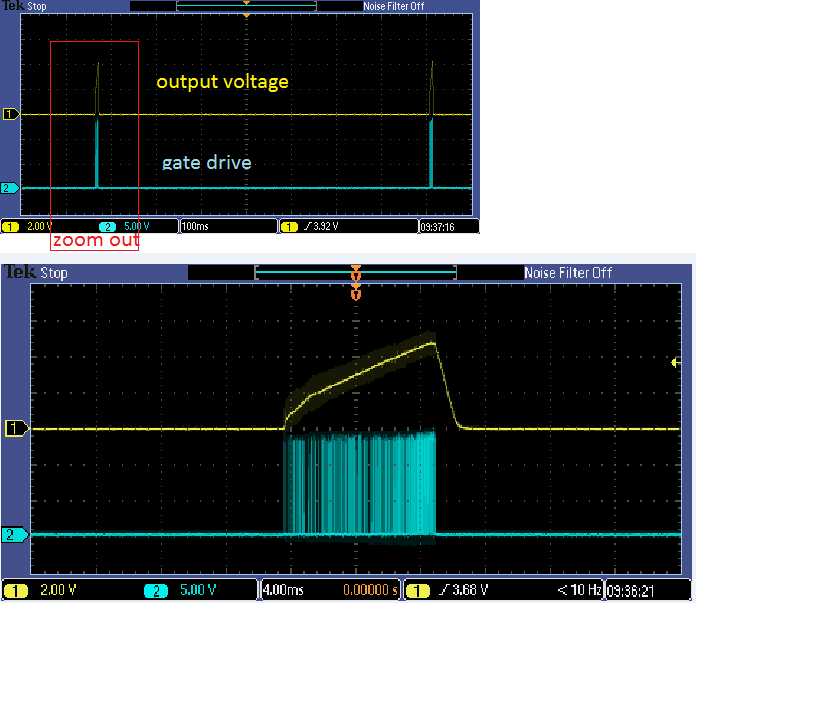

  • Hi, Lisa
    Thank you for all your assistance. I know that it is unreasonable to test EVM under other temp range except room temperature. I have confirmed that components on EVM operated specification (such as Mosfet, diode…) except the transformer as you mentioned. But it seems to be fine when operated in low temperature.
    My test conditions: put EVM in the temp chamber (-25C), and after one or two hours, then turn on it with low line(85Vac) and full load(2.1A) at first. The output voltage and gate drive signal waveform as bellowed:
     By the way, I only have one EVM...
  • hmmm, if you zoom in on the first pulses, a fault response would be shown by 3 runted pulses, then no pulses, followed by the 3 runted pulse attempt...from this far away, I can guess that that isn't happening. but what about looking at CS to see what's going on there. I'll commandeer the temp chamber here again to abuse my board a bit more also...
  • Credit must be given to Uli for this idea:
    Since it can start at lower loads, but doesn’t make it at full load, it looks like something is running out of gas.
    His last waveform shows Vout not quite getting to 5V at the end of ~9ms of ramp up time.  This should be high enough to keep VDD up, so I don’t think it is UVLO.
    But also, it looks like it flattens out.
    Maybe the input Alum Elec caps have lost too much value when cold.  Also ESR has increased, so the Vbulk valleys might be hitting the Brown-out level since this is max load at low line.
    I think he needs more/better Vbulk cap, even though he said he tried to increase it, it may not have been enough or with equally lousy caps.
    At -25C the two bulk caps on this EVM have impedance go up 5 times compared to 25C ratings.
    I suggest looking to see where the VDD and bulk voltages go at the point of shut off, and compare to 50% load cold-start.
    Also, just double or triple the bulk caps.  What can it hurt?
