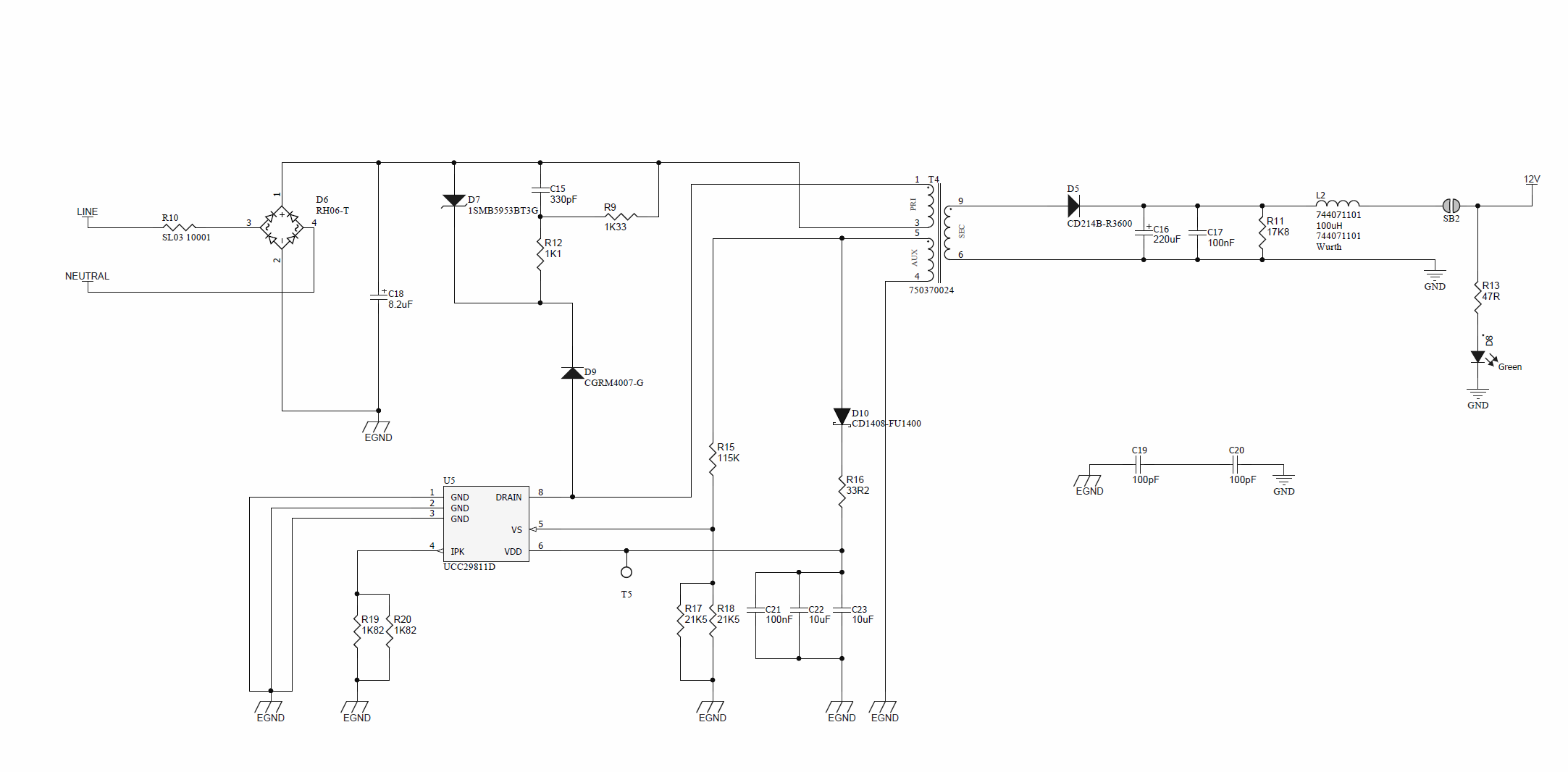

Hi there,
I hope someone can advise me regarding to couple of issues that I am having with UCC28911 that I have designed.
Current design uses Universal AC input and generates 12V on the secondary side of the transformer. Due to some height and width restrictions of the mechanical design, I have used the 750370024 transformer from Wurth.
The problem is when I turn the power on from the mains, I do get the 12V ~13V coming out from the secondary side of the transformer and seems to work fine up to this point. I have a switcher that get connects to 12V power rail to generate 3.3V for micro-controller. I do get the 3.3V coming out from the switcher as well.
But when I connect my external microcontroller board to the 3.3V rail, UCC28911 resets with varying time. When I first plug it in, it works for good few minutes and stops and starts to reset. Any idea about what might be the problem is really appreciated.
I am attaching a schematic as well, hope to hear some usefull response to help me to debug the issue
  • Hi Mustafa, the UCC28911 does have several fault protections as detailed in section 9.3.7 of the datasheet. I would check first what is happening on the output voltage, Vdd voltage and Ipk pin of the IC and see if any of the faults mentioned in the datasheet are being tripped. If the unit is going into constant current mode it may be resetting because the Vdd rail falls too low for example.
    Billy

  • Hi Mustafa,
    I would suggest that you follow the design example in the datasheet to calculate what inductance is required for your design.
    You also need to make sure that your transformer can handle the output power, essentially that for your chosen core, L* I = n*B*A.
    An easier approach if you are not familiar with the design equations may be to use Wurth's Smart Transformer Selector to select the right part.
    For an explanation of the design consideration for a flyback transformer see the following link "ecee.colorado.edu/.../Ch14slides.pdf"
    Hope this helps.
    Billy

    sory for the late response, I have been try to find, what might be problem for the last couple of days. One thing came to my attention and I have not tested it yet, but before i made the test, I wanted to double check this with you as well.
    I think the issue I am having is related to Voltage Sense resistor values. Looking at the transformer Auxiliary winding, transformer Auxiliary winding should be capable of sourcing the 16V. When I calculate the Voltage on the voltage divider, I am actually getting 2.52V, which is way below the Regulating level of the Vvsr.
    I think this might be one of the reason, why my converter is constantly restarting or going into fault mode and stops operating.
    On my previous tests, while I was monitoring the Auxiliary winding voltage, i did see values over 16V with the multimeter and I think this was causing the voltage drop on the secondary winding and also the auxiliary winding was saturating.
    Hope to hear your advise on this
  • any thoughts if this will affect the operation of UCC28911?
  • Mustafa, the IC regulates the Vs pin to 4.05V. It will keep driving up the output voltage until the Vs pin gets to this level. From the values given in your schematic and the turns ratio on the datasheet of the transformer this equates to a bias voltage of approimxately 4.05V / R17||R18) * (R15 + (R17||R18)) = 4.05V / 10.75 * 125.75 = ~ 46V. And an output voltage of ~ 46/8*6 = ~ 35.5V. According to the datasheet the Vdd pin has a nominal clamp voltage of 28V and an minimum clamp voltage of 26V. Exceeding this voltage will cause the IC to go into fault mode and restart.
    Are you sure the Vdd voltage is not exceeding this level. You will need to look at the waveform on the pin with an oscilloscope, not a multimeter to be able to tell accurately.
    Billy
  • Hi Billy,
    Thanks for your response, R18 is DNP on that circuit. I forgot to mention that. So I only populate R17. so the etimated bias voltage value should be 25.7V which is close to clamp voltage of 26V.
    I have change the R15 to be 100K ohm and R17 to be 34K ohm at the moment.
    So now I should get ~16V on the bias voltage and I should get ~12V on the output !!
    Which is what I am trying to achieve.
    Let me know if that sounds correct now.

  • That sounds better alright.

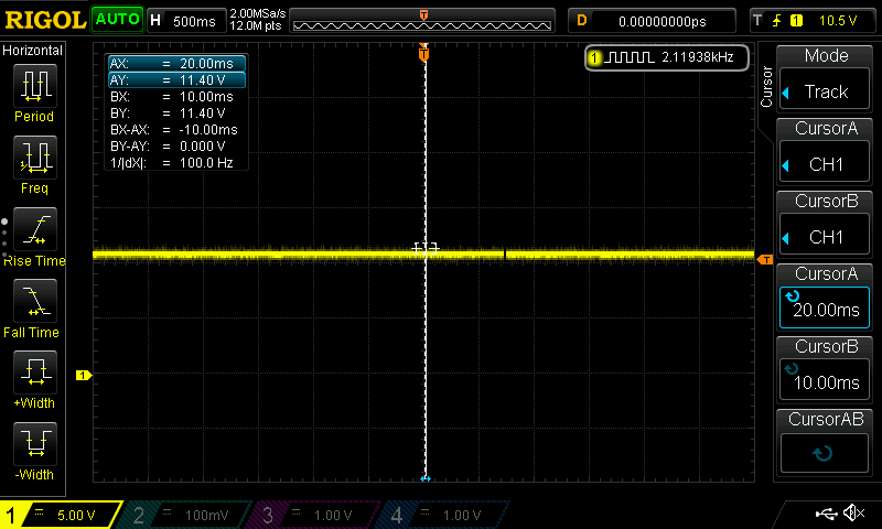

  • Hi Billy,
    I have made those changes on to the board.
    When I turn the board on i get 11V coming out from the secondary winding of the transformer.
    Switcher connected to the secondary side after the inductor generates the necessary 3.3V nicely as well.
    Image below is the secondary winding connected to switcher and works fine.
    but when I connect the load to the 3.3V generated from the switcher, secondary winding voltage response is shown in below image
    I have not checked the voltage on the Vdd of UCC28911 just yet with the oscilloscope, I am not quite sure if I connect my oscilloscope ground probe to EGND or GND on the circuit.
    Assuming the calculations are right, when I measure the voltage on the Vdd pin, I should not get values higher than 16V?
  • You will probably see some spiking above 16V, but the steady state voltage of the winding should be approximately 16V during the secondary conduction interval.
