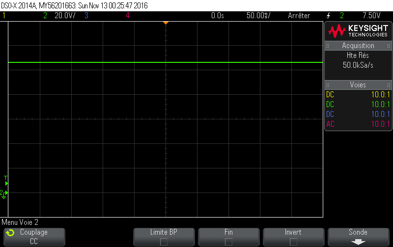

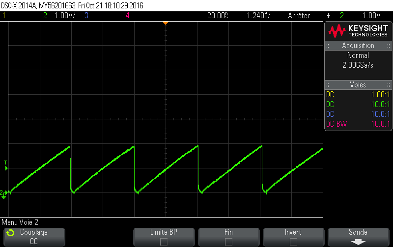

  • Dear Bernard,
    I have done further measurements.
    I increased the RAMP to 2V.
    Soft-start is working good.
    And now, I have no PWM pulses during soft-start anymore… The voltage at COMP pin remains 0V during the whole soft start process…
    Power stage is disconnected and there is NO current sense signal at CS pin… So, I am in voltage mode…
    By the way, during my first experiment, I had up to 10V on the FB. the recommended max voltage is 7V… do you think the FB/COMP bloc is dead ?
    VOLTAGE FB PIN
    RAMP
    SOFT START
  • Julien,
    First of all, the purpose of the offset from COMP to RAMP is so that COMP can be pulled low to command zero duty cycle, but it only needs to be pulled to ~1 V typ to get 0%, this makes the pull-down much easier since it does not need to go all the way to GND, and can be pulled down through a diode etc. The standard UC284x architecture uses a similar internal offset.
    If you see COMP held low while SS rises, then something external must pulling and holding COMP low, or less something external is pushing FB high, above the internal REF, which will then force COMP low. Remember that the SS buffer can only pull down on COMP internally to force SS & COMP to track, but it cannot drive COMP higher than the level COMP wants to be at - this makes COMP & SS track only until the required COMP level is reached - which could be zero, depending on what;s externally driving FB or COMP.
    The CS pin is also NOT used at all for PWM or current-mode control, ONLY for over-current protection. It's good practice to continue to connect your current-sense signal to CS (assuming it's working and properly scaled), so that the CS pin can give some over-current protection if required. Look at the overall IC block diagram on page 9.
    Current-mode signal (if used) is coupled to the RAMP pin.
    I think if the FB pin was raised to 10 V at some stage, it's probably unlikely to be damaged. However, if the IC is misbehaving, even if it's down to a system or usage issue, it may be wise to use a new IC anyway, just to factor out the possibility of damage.
    Bernard

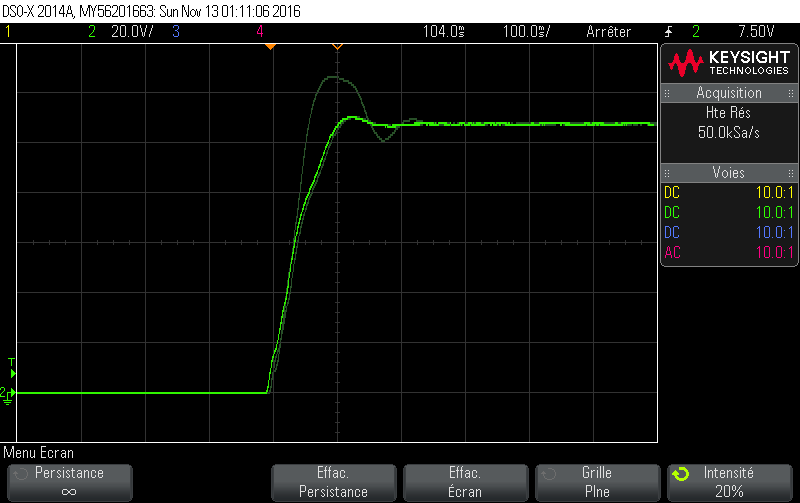

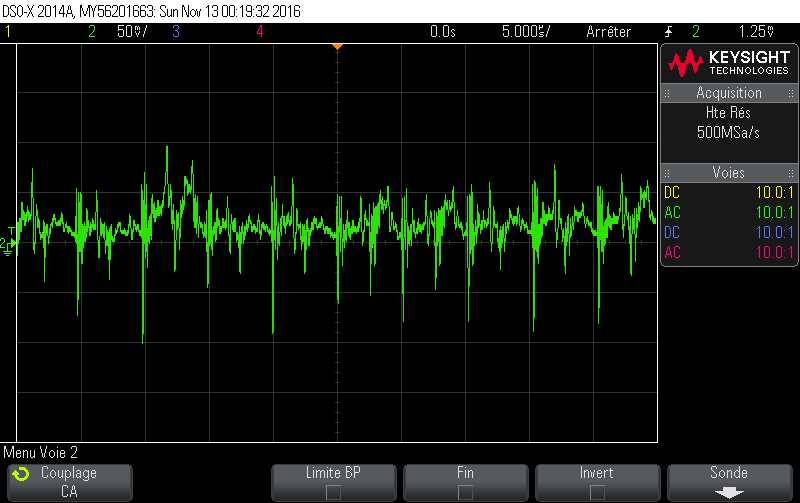

  • Dear Bernard,
    I have some further progress.
    I replace the opto-coupler by an isolated Op-Amp from AD (ADuM3190), and place the PID controller own the secondary side.
    Here you can see some measurement.
    My main problem, is that the duty cycle is not constant and oscillating… causing some voltage imbalance on the primary of the transformer…
    The switching wave-form are clean and the oscillations when the Mosfet switch off are, I think due to measurement error and parasitic effects of the probes… The Probes are directly solder on the pins of the primary winding…
    I think I have a good PID regulator, because the soft-stat does not oscillate anymore…
    So, my question is : where do you think come this little instability… The output voltage is, by the way, really constant.
    Please, not that I am at that moment testing at only 120V input voltage instead of 390V … I am increasing to full load nicely… Want to be sure that everything is stabil… I have 4 secondary windings and only 1 is used for feedback… The output voltage that I measure, is took on one of the windings that is not regulate…
  • BLUE + GREEN = Lower Mosfet Vds.
    PINK = Primary Voltage
