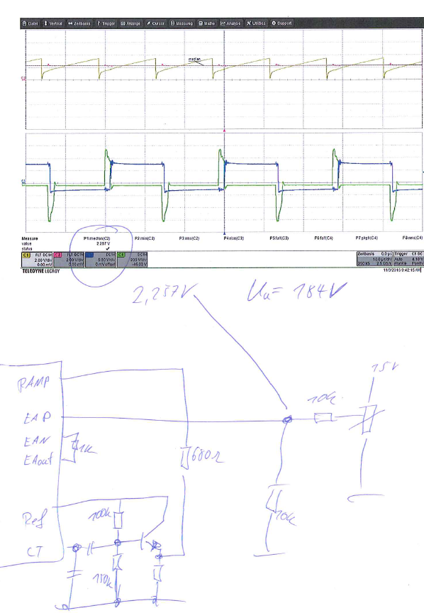

No I have make it very simple for testing and evaluating. Instead of my compensation and control circuit, i using a simple resistiver divider to set the duty cycle to check the behavior at different load points. Now I found one point which I not can easy explain.
If I change the control voltage from 1.33V up to 1.35V I get an jump at the duty cycle on time from 1.3µs to 3.9µs (periode time is about 12.5µs). At the voltage range lower 1.33V and higher then 1.35V there is no jump I can easy adjust the duty cycle. This is a very smal range of set voltage, but it has a high influence of the output.

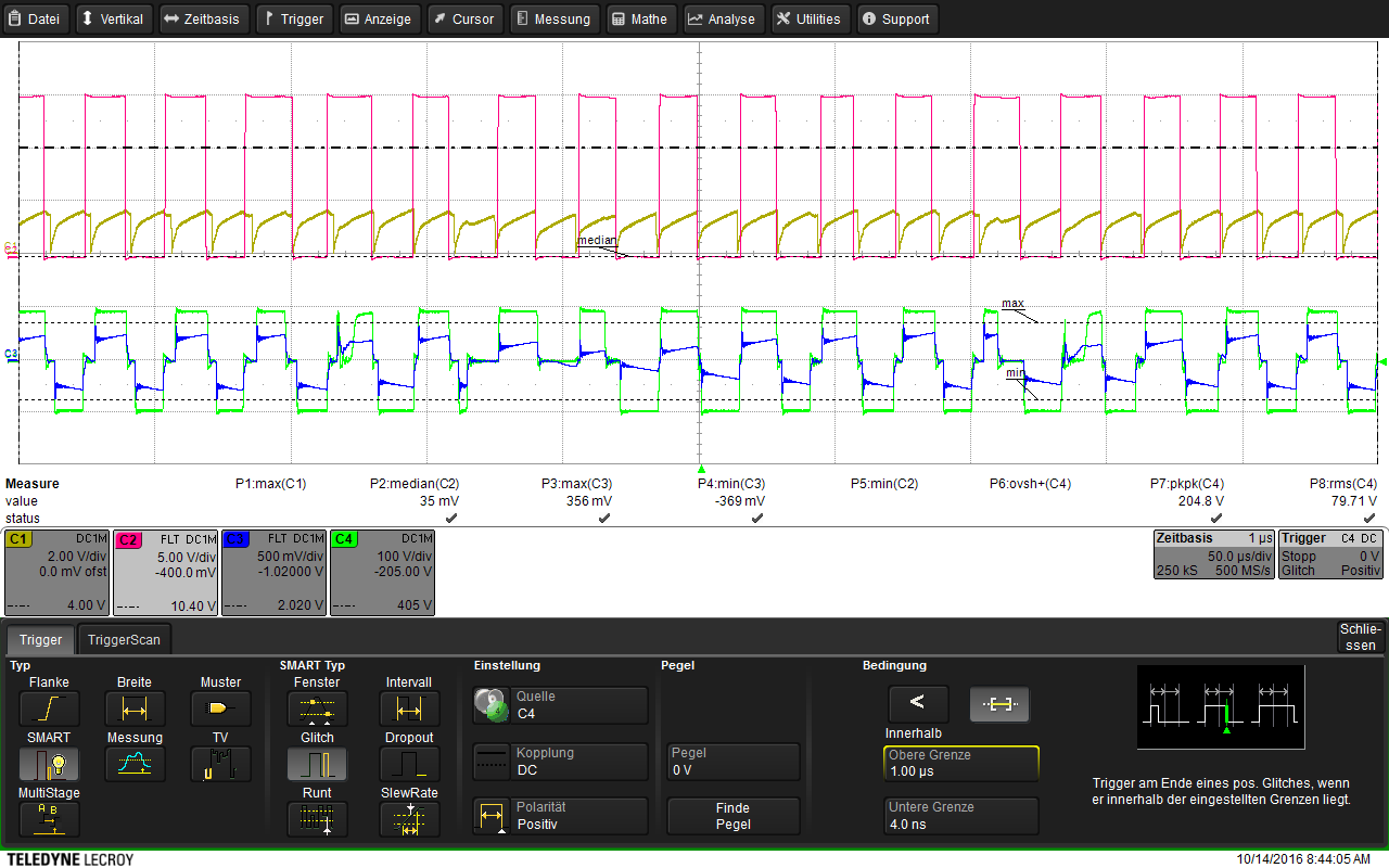

    Here are the picture which I was make during my search: yellow VCC; magenta Driver current; green bridge voltage; blue primary current
    Same behavior, but measured of ramp(yellow) and driver signal(magenta) (for your information I will also try to start working in current mode; see at ramp)

    1. I get some EMC Problem if I close my loop, but this I think like you it is because my control signal get some spikes from the high voltage switching, I have also a long line (about 40cm) how connect my control card with the controller (output voltage and output current controller) (I need it because we parralle more then 10 units...). But for this issue I will try to make a differential signal transfer for improve the noise immunity... may be this solve this problem.
    2. I get this duty cyle jump and between this jump, I get the asymetrical Signals OUT C and OUT D. This is my main problem at the moment because it looks like is depending from the IC. Here are some of my trys with circuit diagramm an Waveforms.

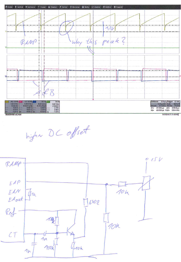

    I working only at voltage mode. This transistor circuit should add the ramp with an DC offset to the ramp pin
    Here I have increase the DC-Offset like it was suggested.... By the way may be you can expalin why I get this negative spike at the ramp, If I reduce the 680Ohm resistor I can reduce this spike, but I don't know why it is there...

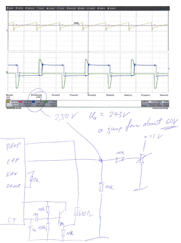

    Here you see my change of the EAP-Voltage (1)
    Change of the EAP-Voltage. You see I have write the output voltage change of about 60V by change the EAP-Voltage only about 60mV.

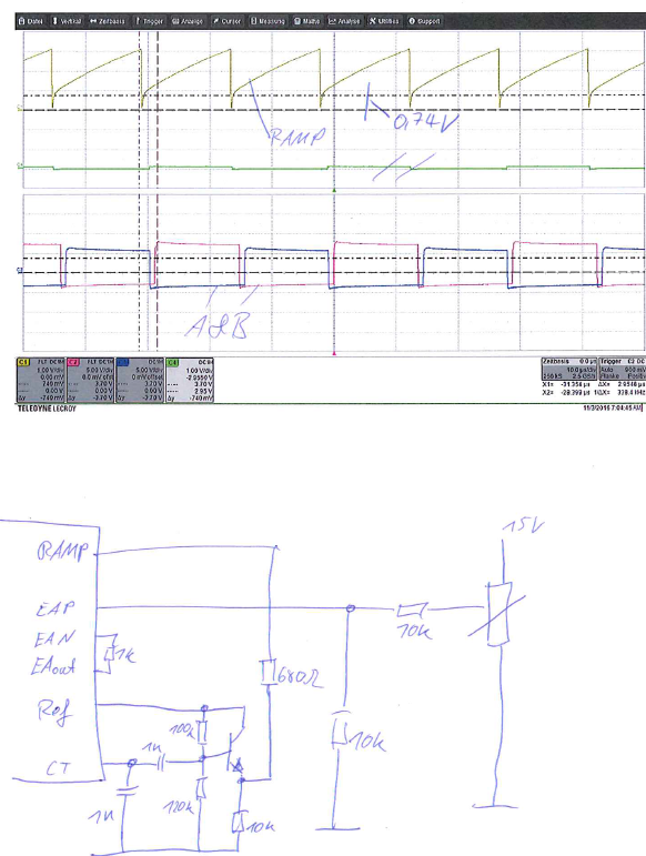

    Of cource I have a big transformer ratio this will result in a big output voltage change by a littel EAP-Voltage change. But the change are not linear it will change with a jump from one point to the other. If I want to control the voltage betwen this point, I will get some serious problems.
    Here I have change my circuit, that it work like recomended at the SLUA275, but I get the same behavior.
