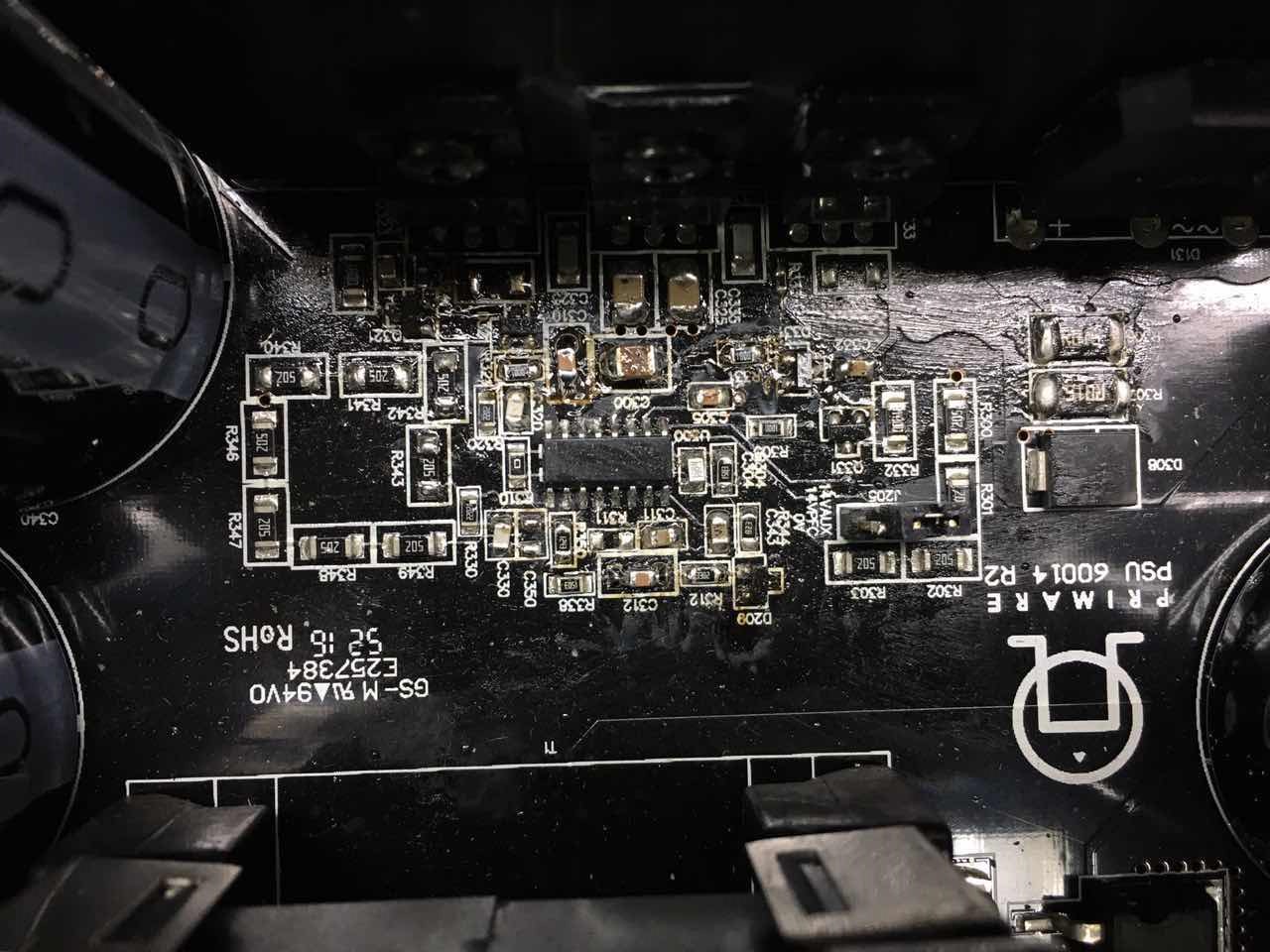

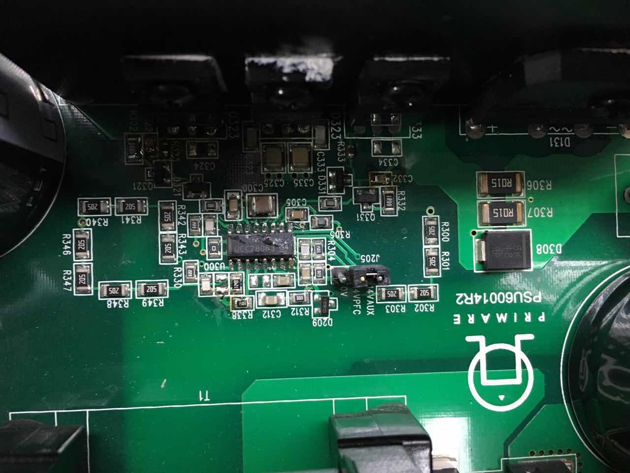

Below is the OEM board:
Below is the board of customer:

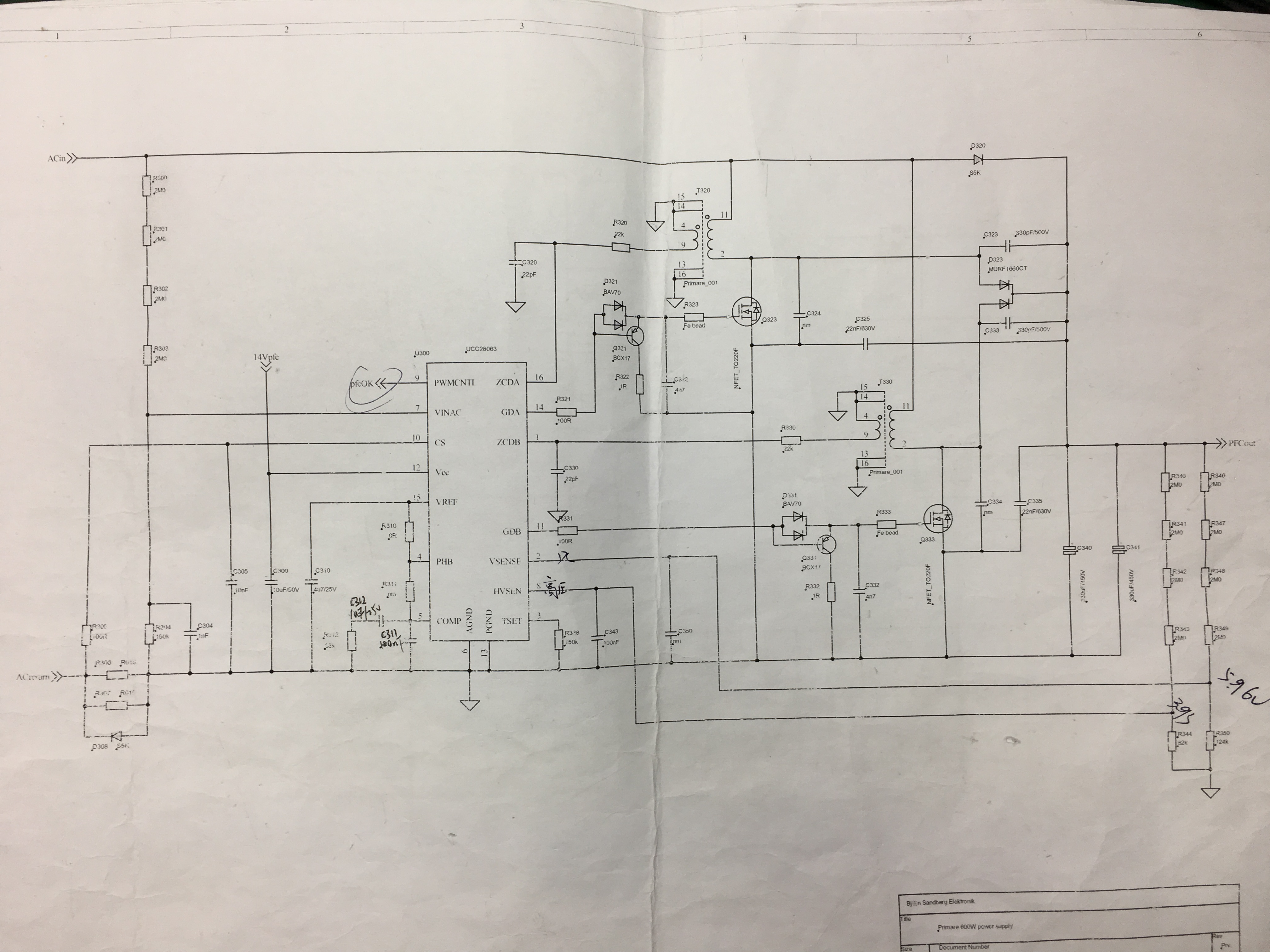

Below is the schematic of UCC28063.
Due to the policy and confidential, it is available to get the schematic and layout file now.

I have compared the layout, I have found that on customer board, the capacitors for several sensing pin (such as CS, VSENSE) is relatively far away from pin than OEM board. It would be easier to couple noise.
Do you think it would be the key reason to lead this issue?
Any suggestion to figure out the problem and is it easy to verify that if don’t make a new PCB?

    The first issue I notice is that PHB is connected to COMP.
    This is done in an attempt to switch off GDB at light load.
    Unfortunately this will not work if the input voltage varies from 100V to 230V because the value of COMP varies with line and load
    Please remove the resistor from PHB to COMP
    This allows GDA and GDB to operate over the full load range.
    Also please check the value of RSET (pin 3) on the OEM's board and the customers board.
    The value of the resistor on the TSET pin sets the maximum on time for the UCC28063.
    If maximum on time is set too low then the power supply will be unable to provide full power at low line voltage.

    Actually, the resistor from PHB to COMP has been taken off. (You could see R311 is not soldered in the PCB picture)
    And the components and parameters used in both OEM and customer's board are the same.
