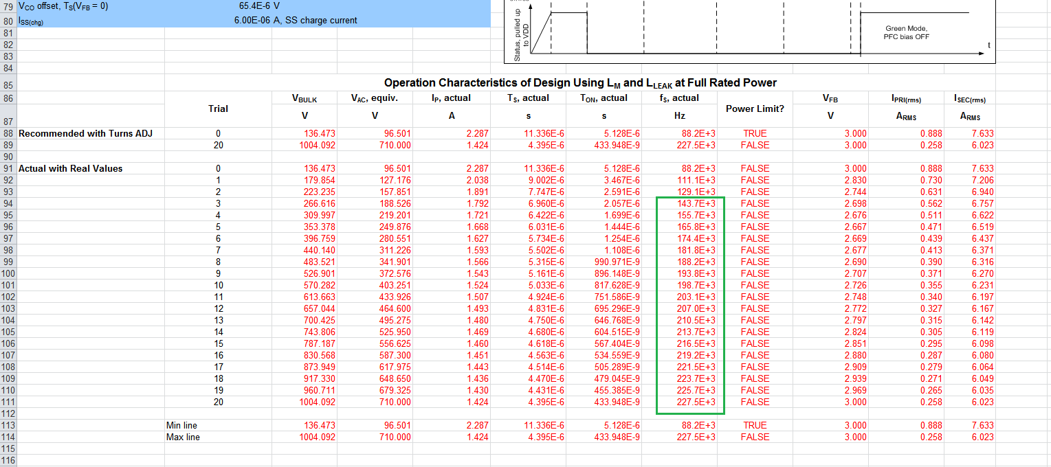

Hello team,
Three questions.
1. Is there a minimum Leading-edge blanking time for UCC28600-Q1? This will restrict the minimum turn-on time of the controller, right? Can it go to 0?
2. what is the minimum CS threshold voltage or minimum peak current amplitude that the controller can regulate? For UCC28700 I seethe ratio is about 1/3 as shown in the datasheet.
3. In the excel sheet the calculated switching frequency is higher than 130kHz, as shown below. Is this correct?
Thank you.
