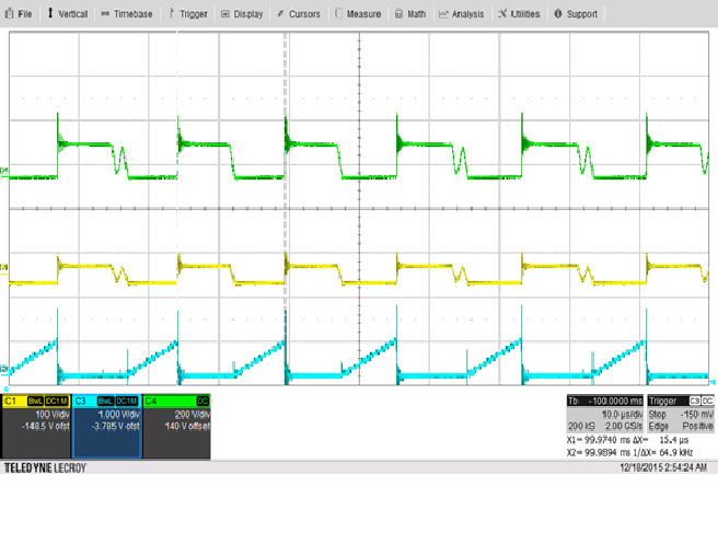

  • Hello Rachit,
    The VS pin is sensitive to probing and can trigger and under voltage fault if you probe it directly. It you want to detect for faults you should probe the aux winding instead of the VS pin.
    From the waveforms that you have the aux wining polarity does not look correct. When the FET is on it should be negative and not positive.  I am curious if your issue is because your transformer polarities are incorrect.  I would double check that first.
    The following waveforms were taken from a DCM flyback at full load similar to the one that you are working on. CH4 = FET Drain, CH1 = Aux voltage, CH3 is the CS signal.   This should help to show what the polarity of the transformer should be.
    Mike
  • For some reason this waveform did no post.
