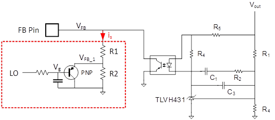

    There are additional questions.
    There was an application note on the audible noise at burst.
    SLUA836–August 2017
    UCC25630x Practical Design Guidelines.
    page7
    6.2 Soft Burst On Circuit
    Furthermore, I will consider this circuit and think about reducing the audible noise.
    Please tell me how to determine the constants of this circuit?
    Is there a calculation formula?
    Thank you.
  • Hi Masazumi-san,
    I would suggest adding the following circuit:
    This circuit will provide a certain soft-on/soft-off when in burst mode.
    I would start with R1=150kΩ, R2=150kΩ, R3=50kΩ and C1=10nF. Increasing C1 slows the rate at which the PNP turns on, which slows the rate at which you pull current out of the FB pin. This also extends the period of time VCOMP is above the burst threshold.
    Ultimately, this results in more burst packets delivered during each burst period and less frequent burst periods. This helps to avoid the audible noise region but with higher output ripple.
    Ben Lough
