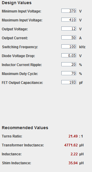

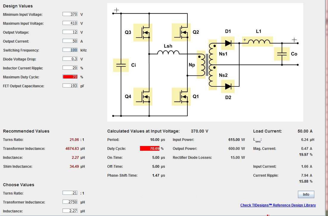

IN SLUA560 at Lout calculation why Vo term is used? Inductance value should depend upon the voltage across it and not output voltage? (1-Dtyp) I guess signifies the off period ie when inductor current is falling.
is it not?
Dtyp =0.65
so voltage at the input terminal is 24/0.66=33.36
so voltage across inductor comes out to be 33.06-24=12.36 is this not the value that should be used for LOUT calculation?
where i am making mistake?
please guide me through.
