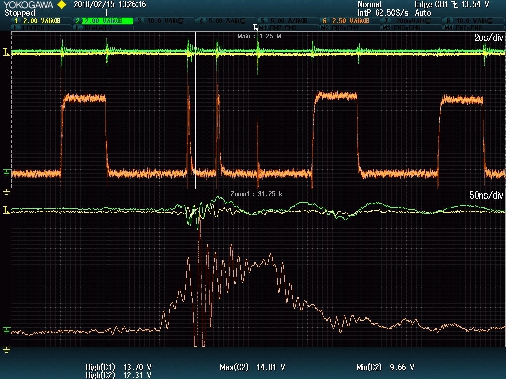

The application is a non-isolated buck converter. The UCC27211 is used to drive the conduction mosfet and the synchronous rectifiers.
The driver operates fine at ambient temperature, but when it is tested at 10degC oven temperature or below, the HO and LO stops once every few pulses.
I am able to replicate the problem with several different test units, and I am able to replicate the problem by spraying a pulse of freezer spray over the gate driver instead of testing inside an oven.
The converter is operating at 200KHz, I have included the relevant part of the schematic below:
Rg-on= R766+R724.
Rg-off= R724. D1032 bypasses R766 during turn off.
R724 and D705 is used to attempt to protect the HS pin from -ve spikes.
C1076 and C1077 reduces ringing on the gate, gave a slightly better gate waveform.
C1075 is the bootstrap capacitor.
T704 is the conduction mosfet.
T705 is the synchronous rectifier.
L702 is the output inductor, there are some electrolytic and ceramic capacitors as output capacitance not shown in this schematic.

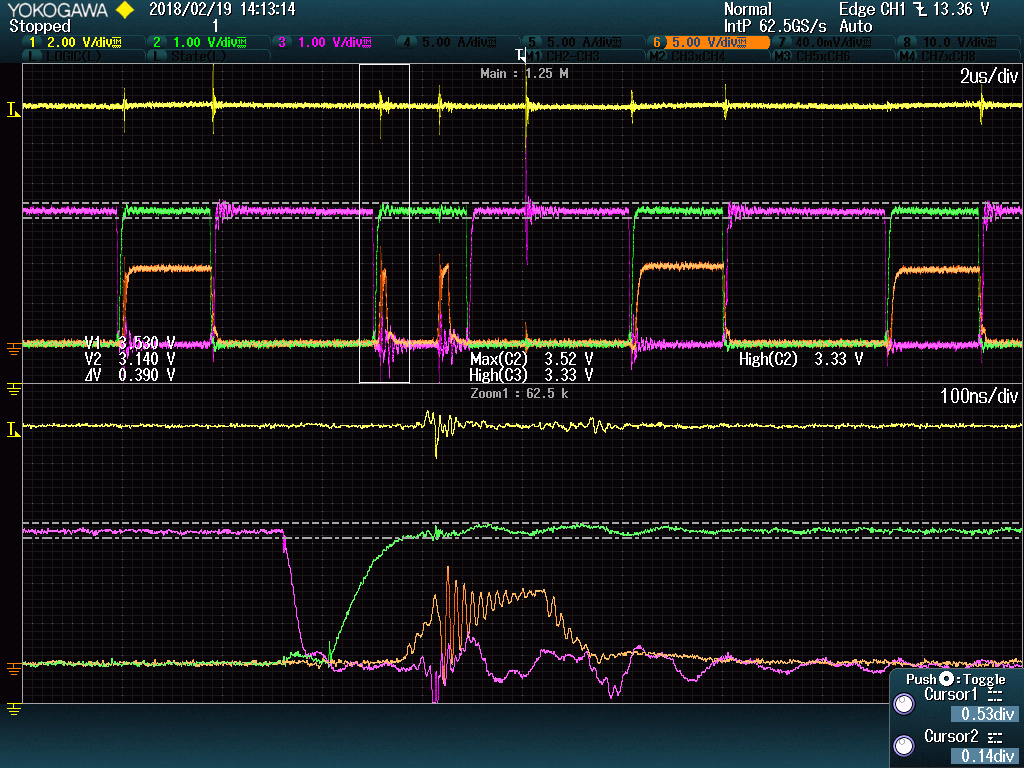

The problem is captured on the oscilloscope trace attached.
CH1=HO of UCC27211
CH2=LO of UCC27211
CH3=HI of UCC27211
CH4=LI of UCC27211
The fault happens once every 3 to 5 pulses. Basically when it receives a HI signal, it will attempt to turn on HO, but will then turn off, reattempt to turn on, then turn off again. And when its time for the Lower switch to go hi, it will have a delay before LO turns on.

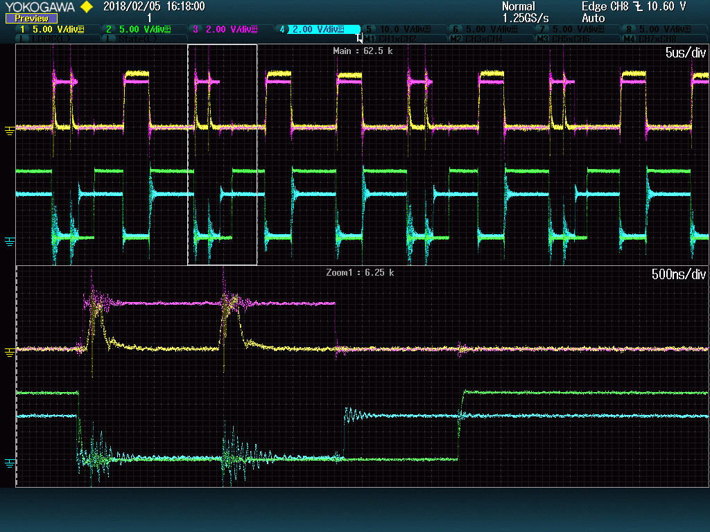

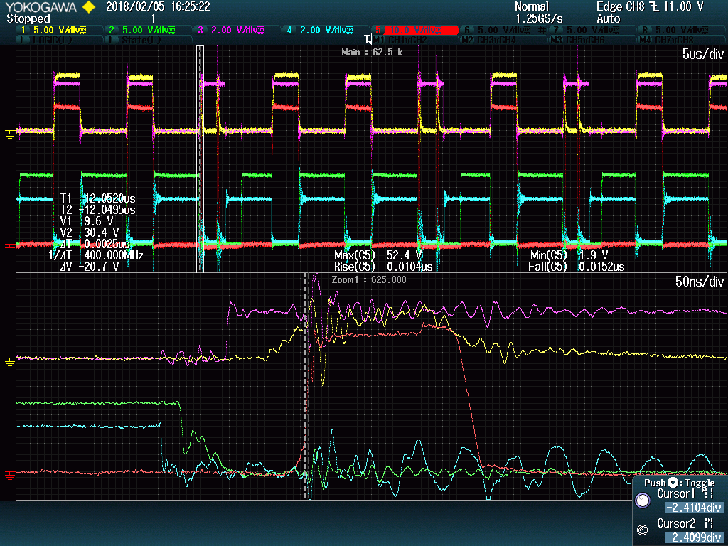

I have checked the VH pin dv/dt during the fault, and it is about 8.28V/ns (which is within 50V/ns).
CH1=HO of UCC27211
CH2=LO of UCC27211
CH3=HI of UCC27211
CH4=LI of UCC27211
CH5=VH voltage
I have checked the VH pin Vmin during fault, and it is about -1.1Vmin (which is over -1V), however the HO pin goes down when VH is positive. CH5=VH voltage
I have then checked the VH pin Vmin when there is no fault at ambient temperature, and it is very similar. CH5=VH voltage.

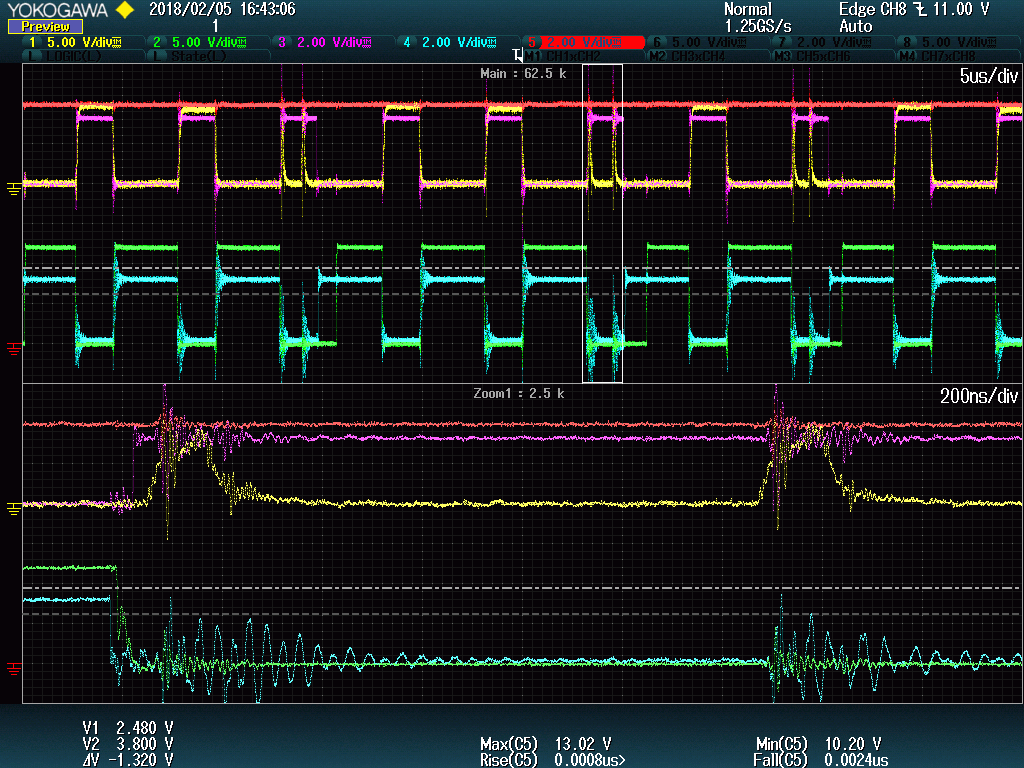

I have checked the VDD pin during fault, and it is 10.2Vmin (which is above UVLO). CH5=VDD

    The schematic and scope waveforms is helpful information to help with the concerns. I do have some information that I want to confirm from the schematic and waveforms.
    Based on the LO waveform on the 1st scope graph it looks like VDD is ~12V, LI and HI is ~3.3V pk. Can you confirm?
    Also on the schematic I see the power MOSFET as BSC070N10N55. I was not able to find that exact number datasheet, is this the BSC070N10NS3 or similar?

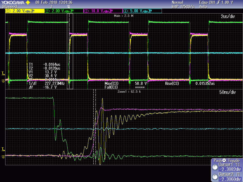

    On the 3rd scope plot where you show the VH voltage at 1V/div, is this the VHB-VHS high side bias? Can you confirm the measurement of VH, differential or to ground, and which pins on the IC?
    Based on the behavior of the HO output this could be caused by a UVLO on the HB-HS high side bias. The UVLO delay times can be within what is shown in the scope plots, it is dependent on the two levels of the voltage on the HB pin (high and low level of the ripple).
    If the VH voltage on the 3rd plot is the VHB-VHS bias ripple voltage, this does appear to be fairly high ripple. The placement and layout of the VDD capacitor and VHB capacitor is important for proper operation. Ensure that the VDD capacitor is placed close to the IC and connected to VDD and VSS pins with short traces as possible. The same advice for the VHB to VHS capacitor, place close to the IC as possible and connect with short traces. As a troubleshooting measure, can you test with the C1075 (bootstrap capacitor) value of 100nF?
    In the scope plots there appears to be noticeable high frequency ringing on the LI and HI inputs, this may be due to noise induced in the probes. In the case there may be high frequency noise on the actual driver inputs I suggest trying adding small bypass capacitance to the input pins LI and HI. Try 22pF to 33pF placed close to the UCC27211 input pins and ground. High frequency false triggering can cause unexpected discharge of the bootstrap capacitor.
    It is not clear the cause of the LO delayed turn on at this point. Can you provide a scope plot of the HS pin voltage to ground both at a scale to capture the peak to peak, and an expanded scale to see the negative voltage to ground?

  • Hi Richard,
    Thanks for looking into this.
    I can confirm VDD is 12V and LI and LO are driven with 3V3.
    The power mosfets and rectifiers are Infineon BSC070N10NS5.
    On the 3rd plot is actually the HS voltage w.r.t. ground (i.e. VHS to GND). I didn't use a differential probe, I used a 500MHz probe with a very short ground wire (close probe technique). The measurement was taken across D705 diode which was placed about 2mm away from the UCC27211 IC. My aim was to accurately check the negative voltage of HS pin to ground.

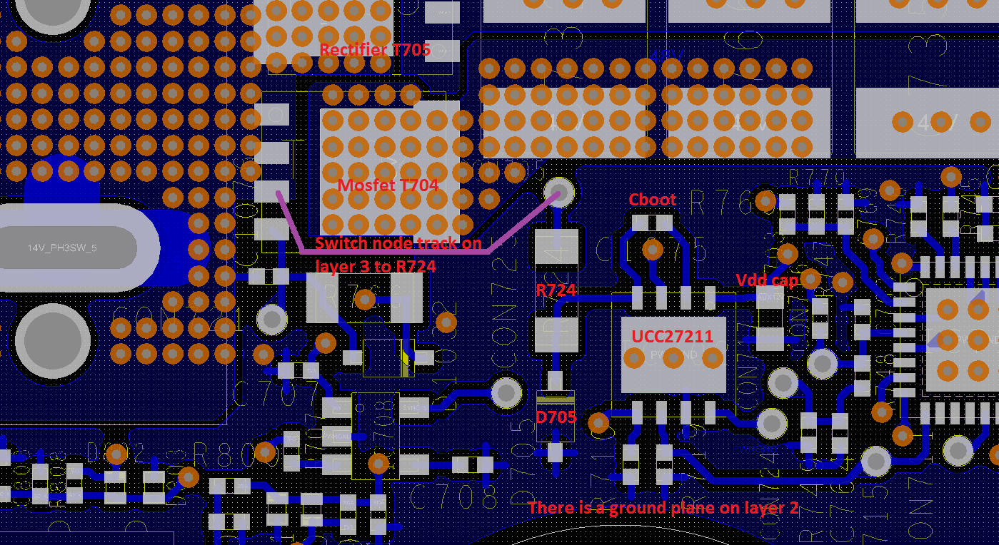

    The VDD capacitor (C703) and the bootstrap capacitor (C1075) are placed very close within 2 to 3mm of the IC.

    The previous scope traces are the HS pin voltage to ground (CH5). The 2nd scope trace shows peak voltage of HS pin is about 52.4Vmax. The 3rd scope trace shows min voltage of HS pin to ground is about -1.24Vmin.

    I see that R724 and D705 should limit the negative voltage on HS. Confirm that D705 is located as close as possible to the IC pins. Also can you confirm the negative voltage level on HS, and that it meets the datasheet limit of -(24V-VDD) for <100ns?

    Below is the layout, Vdd cap and bootsctrap cap are pretty close to the IC:
    I will try adding diodes on the HO and LO outputs next.

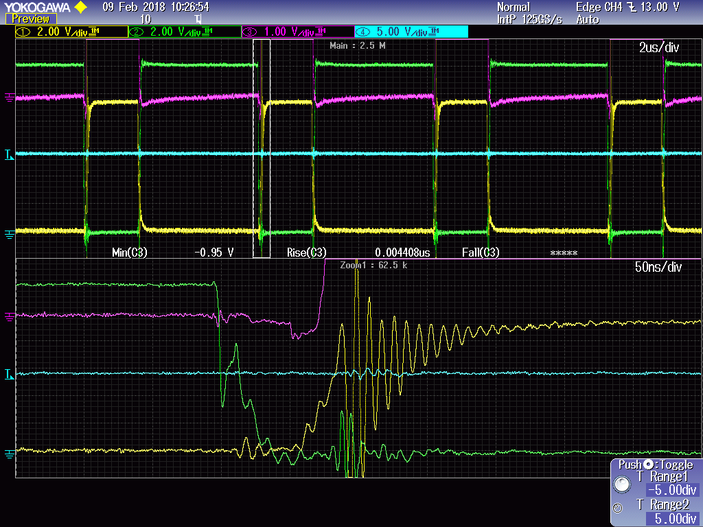

    I have capture some further scope traces of HS pin to GND.
    Test @ ambient temperature without fault:
    CH1=Mosfet Vgs     CH2=Rectifier Vgs     CH3=HS voltage to GND (close probe technique)     CH4=converters Vout

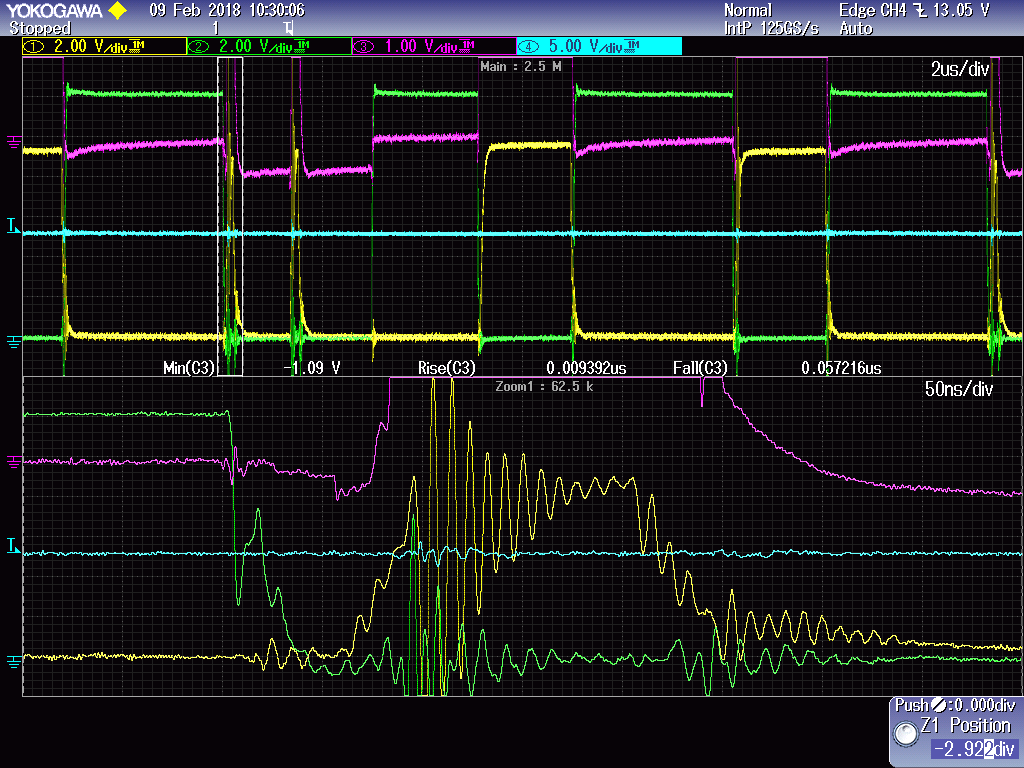

    The zoomed in trace showed HS voltage Vmin=-0.95V for about 25ns during mosfet turn on. (You cannot see the entire voltage because I focused into the negative section)
    I captured another trace during the moment I induce the problem by spray freezer spray over the circuit.
    The zoomed in trace showed HS voltage Vmin=-1.09V for about 25ns during the turn on instance where the fault occurred.
    As another test, I use a Schottky diode PMEG6010 (instead of BAS316) for D705, then capture another trace while inducing the fault with freezer spray.
    The zoomed in trace showed HS voltage Vmin=-0.83V for about 25ns during the turn on instance where the fault occurred. Even though the negative voltage is within spec, I can still replicate the problem.
    It seems like the UCC27211 still misbehaves even when the HS pin voltage is within its negative voltage rating. It maybe that I cannot measure the negative voltage accurately, however I did see the negative voltage reduced with a schottky diode as expected.

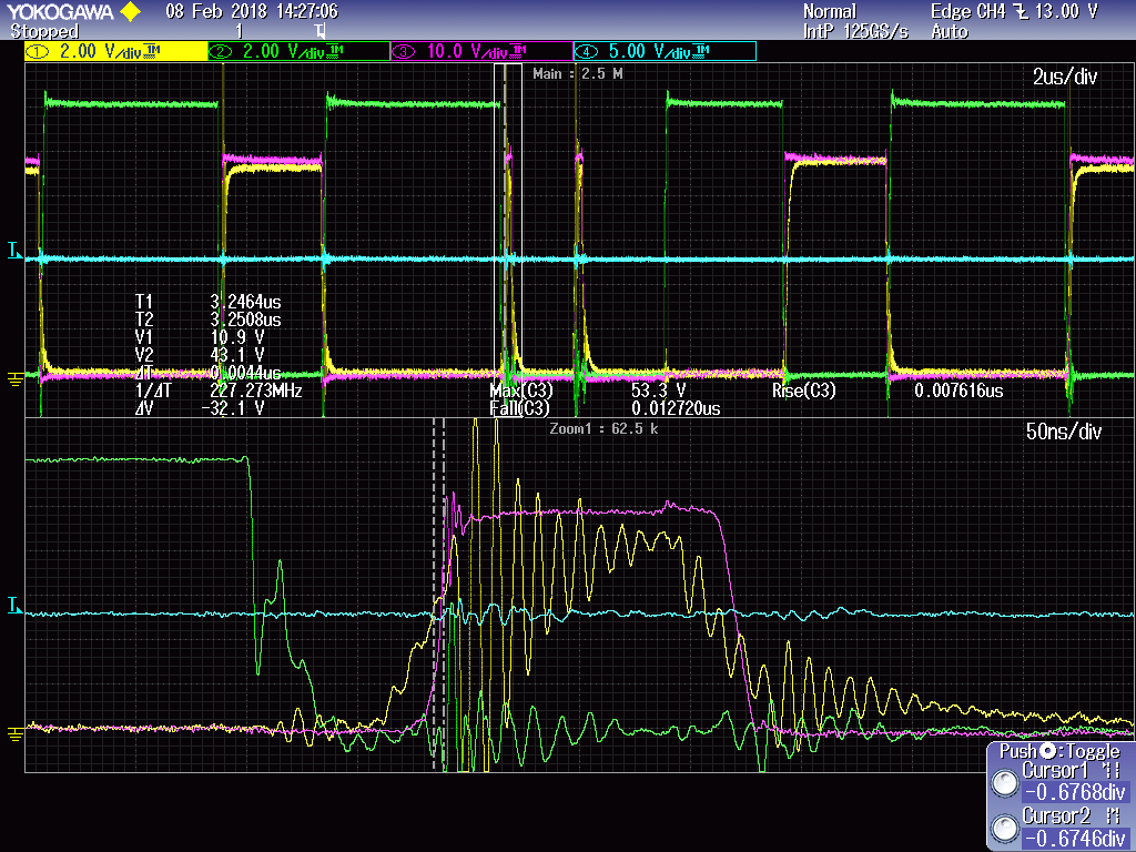

    The next assumption for root cause may be the dv/dt rating of the HS pin. I had captured the Switch node dv/dt during the problem.
    Using cursors, I measure the dv/dt of the turn on to be 32.1V/0.0044us=7.30V/ns. This is within the rating of 50V/ns.
    During ambient conditions when there is no fault, the dv/dt of the switch node is a little slower at about 5.64V/ns.
    Freezing the circuit speeds up the switching.
    To resolve the problem, I added a RC snubber to the switch node which slows the dv/dt down to about 3.80V/ns.

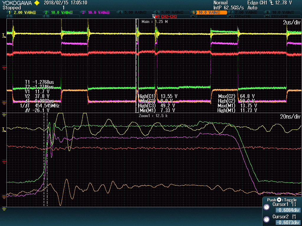

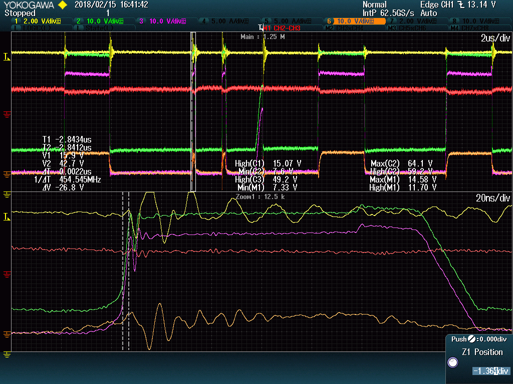

    I have done some more testing by lowering bootstrap capacitor from 47nF to 22nF as you suggested, but I do not see much difference in waveform and I can still replicate the problem.
    CH1=Vo,  CH2=HB wrt ground,  CH3=HS wrt ground,  CH6=Vgs of mosfet,  M1= maths function CH2-CH3 ie:HB wrt HS.
    I used non-differential passive probed with small ground wire (close probe technique) to measure HB and HS, hoping to get rid of all measurement noise.
    The shot below is with 47nF bootstrap capacitor, it was triggered during the fault when I spray it with freezer spray.
    The HS dv/dt = 26.1V/2.2ns=11.86V/ns.
    The HB-HS Vmin= 7.33V.
    I believe this is within the UVLO threshold for the upper gate which is 7.9V-1.1Vhyst=6.8Vthreshold.
    The shot below is with lowered 22nF bootstrap capacitor, it was triggered during the fault when I spray it with freezer spray.
    The HS dv/dt = 26.8V/2.2ns=12.18V/ns.
    The HB-HS Vmin= 7.33V. This is again within the UVLO threshold.
    I have also use close probe technique to look at the VDD capacitor voltage during a fault, but VDD-min=9.66, so it is above the UVLO threshold.
    CH2=VDD

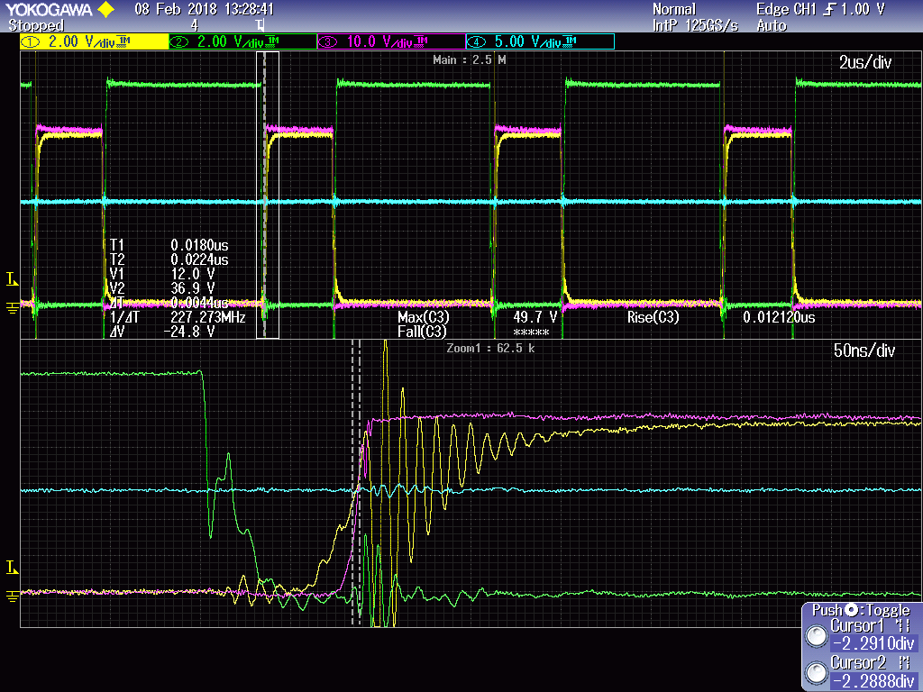

    I will now show you the difference in dv/dt of the switch node before and after I added a RC snubber on the switch node.
    This is the waveform with the snubber added:
    CH1=Mosfet Vgs,  CH2= Rectifier Vgs,  CH3= Switch node (Rectifier Vds), CH4=Vo
    Switch node dv/dt=16.7V/4.4ns=3.80V/ns, rise time=0.015us.
    And this is the original circuit without the snubber:
    dv/dt=24.8V/4.4ns=5.64ns,  rise time=0.01212us.
    As you can see, the original switch node waveform has a slight extra ring near the top, but I am not sure if this will cause a problem
