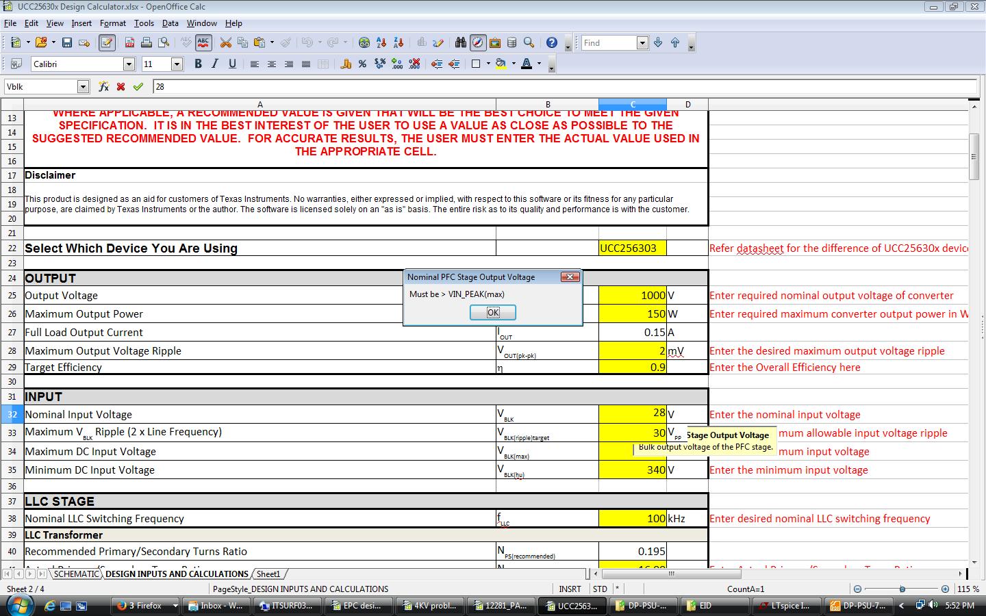

UCC256304: Compatibility of this IC or topology for 24V/1000V 150W converter
Part Number: UCC256304
Other Parts Discussed in Thread: UCC256303,
I have seen LLC topology used for step down the voltage in many places. But for my application I need step up converter. If I use the turns ratio for24/1000V is there any issue. I have simulated the topology , I am getting the output voltage only at low Q values.
