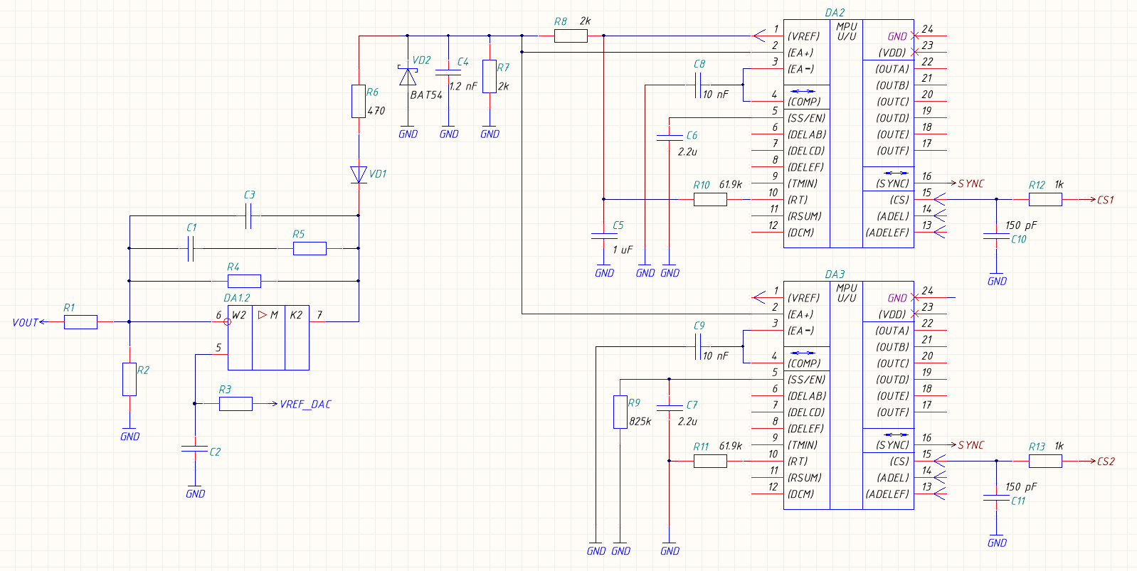

We're currently designing a Full Bridge ZVS 4800 W converter with two UCC28950 (coupled as master/slave interleaving).
Power stage of the converter presents two PHFB DC/DC with center-tapped rectifier scheme tied together by the two output inductors.
We have an external voltage amplifier for feedback (based on MC33272ADG) and both UCC28950 are connected as voltage amplifier in a voltage follower configuration, as simplified shown below:
Both master and slave (when used as master) parts of converter work proper separately and each of them converts 800 V DC input into 24 V 100 A DC output. Both UCC28950 have exactly the same resistors (DELAB, DELCD, Tmin, Rsum and others) and parameters of master and slave power stages are very similar (Lmag, Lout, Rcs and others) – in fact we have two identical converters placed on joint PCB. The only different thing is that one part of converter starts drop output voltage at Iout = 105 А and another starts drop output voltage at Iout = 115 А (when they work separately). However, when we launch both parts in master/slave interleaving configuration, we have two main problems:

About the second problem: we decided to break synchronization line between two UCC28950 and configure both of them as masters to check if they share current equally, but they don’t! It is confusing because EA+ level is the same for two UCC28950, additional ramp is the same (Rsum configured for 0.147 V/us slope compensation), but CS trigger level differs.

    The Slave unit should have a 825k resistor added between SS/EN and GND
    The UCC28950 SYNC signal has to be at least 1.8 times the controller's free running frequency. It might be that your slave device is losing synchronisation so I would suggest that you reduce the free running frequency of the slave by about 10% or so and see if its behaviour improves. I would also double check the amplitude and waveshape of the SYNC signal.
    It might be that there are differences in the GND potential of the two controllers so that the effective EA+ level is slightly different.

    Slave do has resistor 825k in parallel with SS capacitor.
