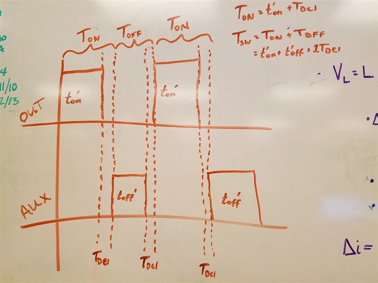

  1. Why does T(ON) get T(Del) subtracted from the on-time set by R(on), while T(OFF) has T(Del) added to the off-time set by R(off)?
  2. Due to the opposite polarity mentioned above, equation 4 suggests that the switching frequency is independent of the delay time T(del). In my mind the switching period would be t(on)+t(off)+2T(del). What am I missing? (Picture Below)

  • Hi Ryan,
    In any switching converter the on time refers to the total time the main switch is conducting and the off time refers to the total time the main switch is off.
    So ton in the data sheet refers to t'on in your sketch and toff in the data sheet refers to t'off +2T(DEL) in your sketch.
    I think the confusion arises because the data sheet definition of ton and toff is not the same as T(ON) and T(OFF) in your sketch.

    However, I'm still confused on how the switching period is independent of the delay.
    If I substitute datasheet equations (2) and (3) into equation (4), I see that the switching period is only dependent on R(on) and R(off). If I fixed those two resistance, but varied R(del), shouldn't my switching period grow/shrink as the delay grow/shrinks?

  • Hi Ryan,
    Your timing diagram is not correct.
    Please see SLUA535 for correct timing.
    This is a fixed frequency controller. You can set the operating frequency and the overlap time but the operating conditions and control loop will set the on and off times
