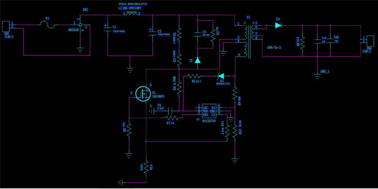

UCC28700: i MADE a sch of it with the UCC28700 ,the input voltage is ac 220v 50hz , the rectifier bridge , diode D1 and the mos tube WILL be damaged when we power on the ac. can you help us to analyze this problem.the sch you can see in the p
Part Number: UCC28700
are there any problem with this sch,what is the reason result in damaged the components.  the  rectifier bridge  , diode D1  and  the mos tube WILL be damaged  when we power on the ac sourse .the input voltage is  ac 220v  50hz .   When  we  take down the ucc28700 ,we measure the voltage pin2  of ucc28700.  we find that the VLOTAGE is 72V.

    In your schematic, I see that the polarities of the primary and secondary windings are that of a forward-mode converter, not a flyback converter. The UCC28700 is a flyback controller and does not work in forward mode.
    That alone does not explain the component failures. The Auxiliary winding does not have a polarity mark, and I suspect that it, too, is oriented in a forward-mode arrangement. Such a polarity would imposed excessive voltage onto the VDD pin (pin 2) of the controller, causing it to fail from voltage overstress. This, in turn, could cause a cascade failure through the gate drive output to overstress the MOSFET gate and cause it to fail short, which then can allow a large surge current to overstress the rectifier bridge.
    I'm not sure why diode D1 failed. Maybe the leakage energy from the surge current that damaged the MOSFET built up excess voltage on the clamp-cap C3 which then over-voltage D1.
    In any case, I believe the wrong polarity of the transformer is the root cause of all other follow-on failures.
    To fix it, swap the connections of pins 1 and 2 of the transformer; that is, pin 1 to the Drain, pin2 to the bulk voltage. Then use a very low ac-input voltage (approximately 15Vrms) to cause the converter to attempt to start up. It will not start, but it will cycle through VDD turn-on and UVLO thresholds. At the peak of VDD (about 21V), there will be three short pulses from the gate drive to turn on the MOSFET and test for conditions. During these 3 pulses, verify that when the MOSFET drain is low (~0V), the voltages at D2 and D3 anodes are negative with respect to each winding's local Ground.
    When the winding polarities are correct, the converter should work much better.

    The transformer specification schematic diagram looks normal, with primary winding 1-3, auxiliary winding 4-5, and secondary winding 6,7 - 9,10. The polarity marks in the transformer schematic are correct. The pin numbering of the physical footprint is very unusual, though.
    Normally with a top-side view, one would expect pin1 to start at top left corner (as shown), then progress down to pin 2 (the left-side missing pin), then 3, then 4, then 5 at bottom of left side. Then pin 6 at bottom of right side and progressing up pin 7, 8 (missing pin on right side), 9 and pin 10 at top-right corner.
    Your top-down view has only pins 1, 7, & 9 in their expected positions and the other pin numbers inconsistent with typical numbering.
    If the transformer itself is constructed according to the specification, with the windings going to the normal pin-numbering positions, it should have worked okay in your circuit. However, if the transformer was constructed with the windings going to the assigned pin numbers, but the pin numbering followed the unusual positioning as numbered in the physical top-view, then I can see how the various component failures can happen.
    If the primary winding is wound from pin 3 to pin 1, but pin three is physically at top-right and pin 1 is physically at top-left, then there is a direct short-circuit from primary to secondary. The same with pins 6 and 7. The spec schematic has one end of the secondary tied together at 6 & 7. If the physical footprint numbering is used, this will tie the auxiliary winding to output ground.
    These connections will definitely cause component failures because the current and voltage stresses are completely different than expected from the usual interconnections.
    Please review the transformer construction thoroughly to understand how the windings are actually connected from one pin to another. The primary and auxiliary windings should all terminate on the left side (using top-view) and the secondary terminates on the right side (top view). No winding should extend from the left side to the right side. I recommend that the physical top-view pinning of the transformer should be corrected to follow the normal pin number progression, as I described above. And your circuit schematic pinning should also be corrected to follow the correct numbering (which is in the transformer specification).
