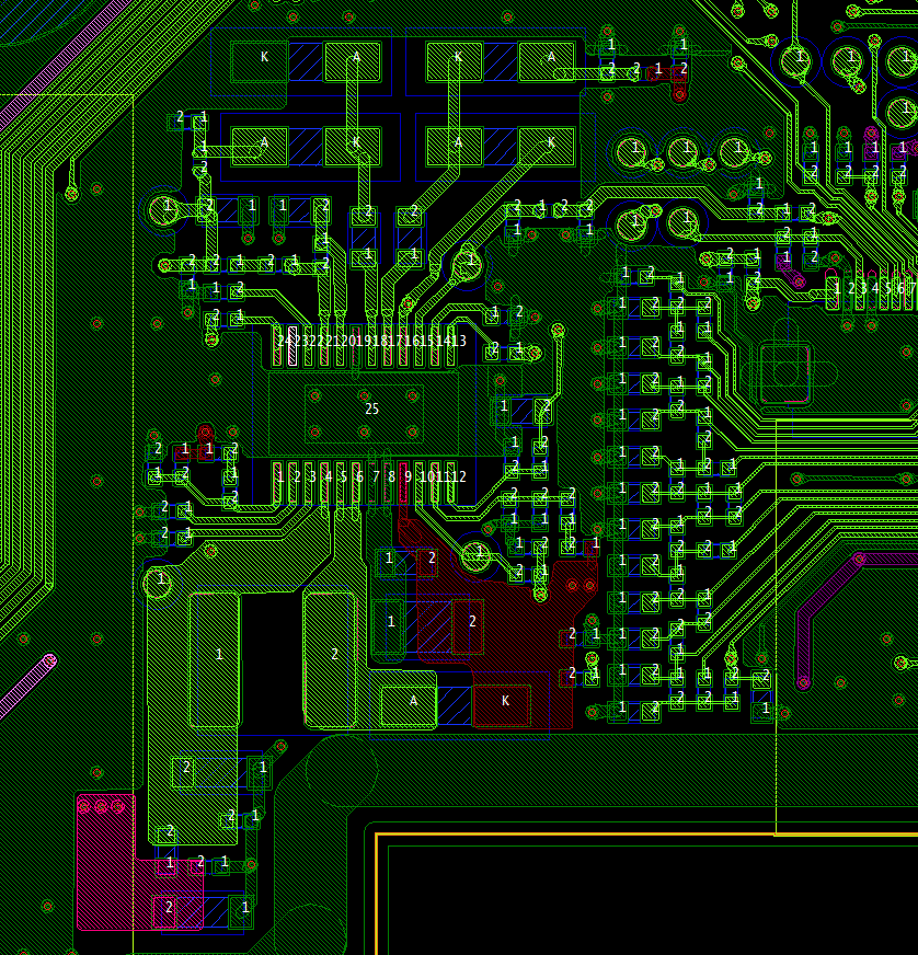

We are using TPS65150 in automotive application. We can't pass the EMC test because the switching noise. We are using 2-layers.
Could you please give us some comments about the layout ? How to modify the layout to make the noise smaller ?
Attached picture is the layout.

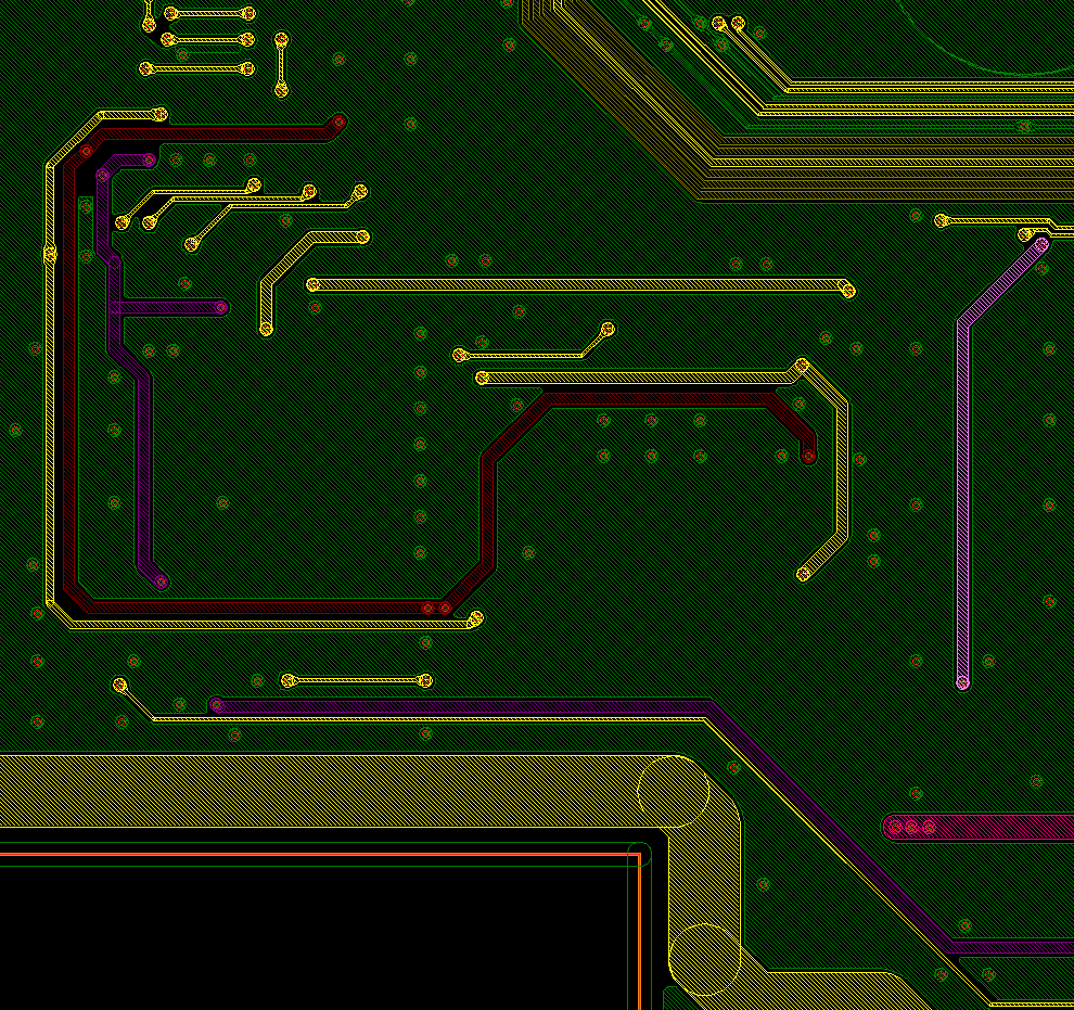

We measure the voltage difference between Boost power ground pin and power pad, we can see big switching noise(1.2M). We are using "ground ring" to avoid the radio noise, and also using snubber to damp the ring. There
is not much improvement. But when we remove the negative output, the result is much better(attached picture).
 is
  • Hello William,
    It is almost impossible to review a layout without schematic and placement. If you could provide these, it should be possible to check the layout.
    Can you pass the EMC test when removing the negative output? If yes, it might help to add a series resistor of a few ohms to DRVN. It is interesting that you get higher spikes when the negative charge pump is connected. I think this means that the spikes are on the GND plane and not on the signal. Your GND connection is cut a lot.
    You could as well try to use Zener diodes for the charge pumps if you are not using some already. The spiking is for example higher when using BAV99 compared to BAT54.
    Another possibility is adding snubbers. Sometimes it seems to be helpful to have a small cap directly at the cathode of the boost diode to GND. If you have a snubber on the SW node available you can check this as well.
    Brigitte
