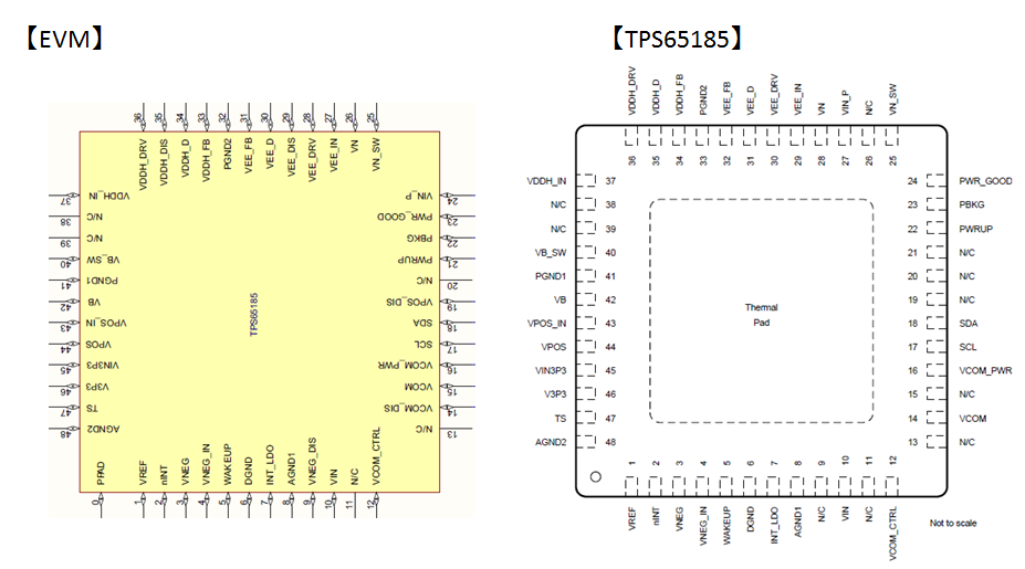

We would like to know the pin assignment of TPS65185.
I found that "Pin assignment of EVM" is different from “Pin assignment of the datasheet.
Which is right information?
Kanemaru
Kanemaru-san,
Thank you for bringing this to our attention, it seems that there is an error in the datasheet figure. Please use the pin assignments table in the datasheet for the most dependable resource.
The figure in the EVM also matches the pin assignments from the datasheet, so it can also be used as a reference.
