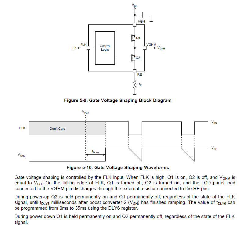

    There are 2 points that influence the VGHM startup. The internal delay from VGH to VGHM is set by the DLY6 register which is by default set to 20ms. You need to set this register to 0ms (0x00) to start VGHM directly when VGH is at the target value.
    In addition the FLK signal needs to be high to connect VGHM to VGH (turn on Q1 in Figure 5-9).
    I expect that the 54ms the customer is measuring are a combination of the DLY6 register and the FLK signal because the maximum delay that can be set with the register is 35ms.

  • Hello Yada-san,
    Please excuse the delayed response.
    If VGH has started, it depends on the setting of DLY6 register when VGHM goes high. See figure 4-60 in the datasheet for a 10ms delay.
    In this time, FLK can be high, but VGHM will not go high until DLY6 has passed.

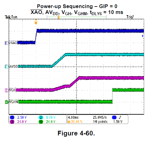

  • Hello Kurioka-san,
    Please have a look at this figure:
    For this startup measurement FLK is high all the time. VGHM starts about 10ms after VGH reaches the set value because tDLY6 is set to 10ms.
    VGHM goes high after the following has happened:
    1. tDLY6 time has passed after VGH reached the set value.
    2. FLK is high.
    Maybe this text from the datasheet page 35 helps even more to understand the behavior:
