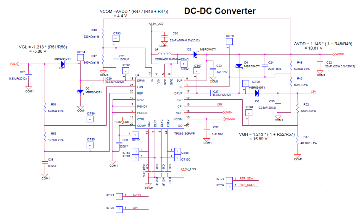

TPS65150: Please review the circuit diagram.
Part Number: TPS65150
Hi team
I made the schematic as above.
Please confirm.
Please tell me the wrong part.

  • Hello Taemin,
    The schematic looks ok for me, just C22 is a 6.3V capacitor on a 10.81V output. Please use a higher voltage rating cap.
    The diodes for the charge pumps are ok, but could be replaced by BAT54 or BAV99 as well, but this is only a comment.
    I did not re-calculate your resistor dividers, but the formulas you are using look good.
    In general I recommend to have a resistor in series to the COMP capacitor, just in case it is needed during testing of the circuitry.
