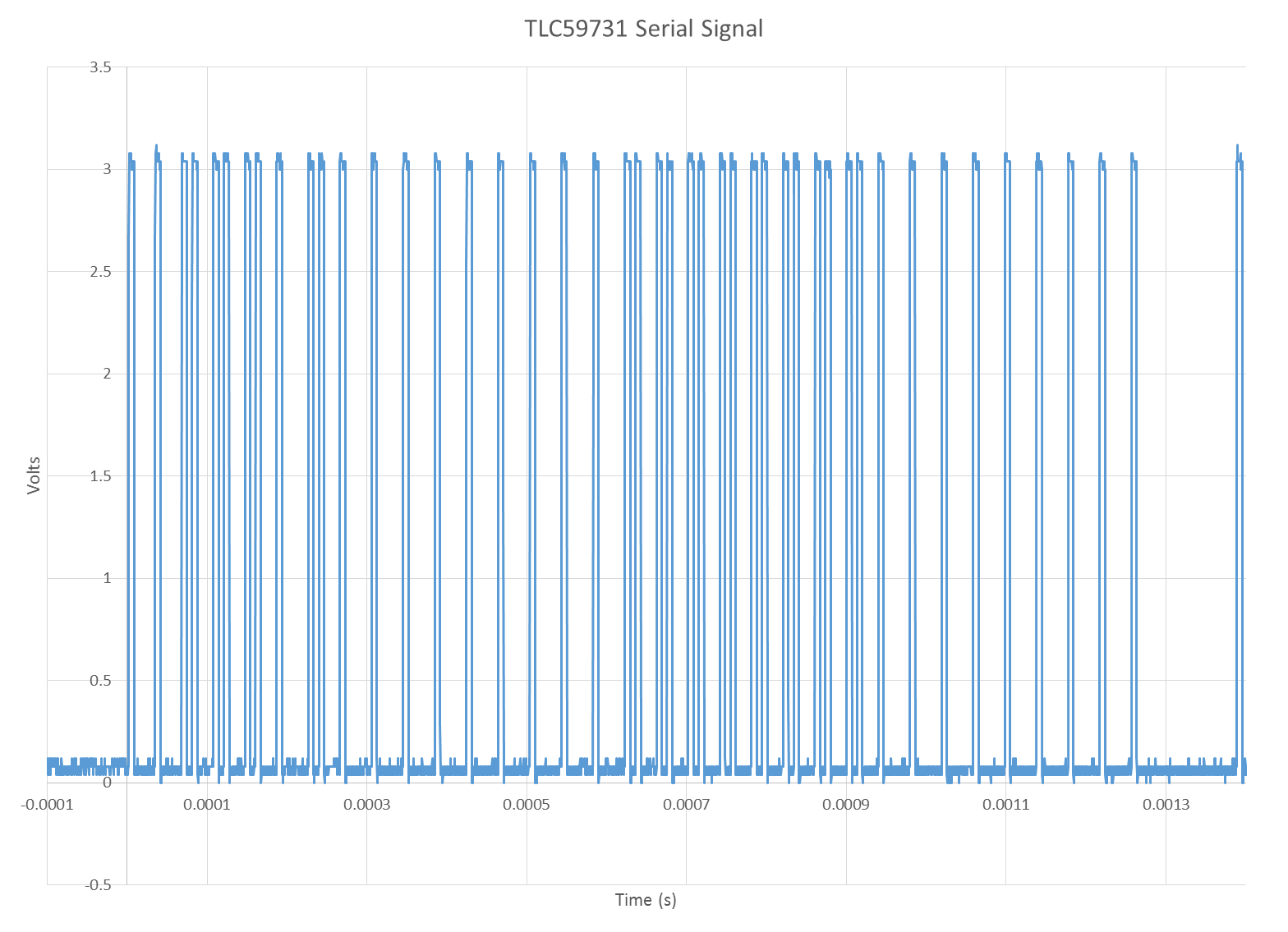

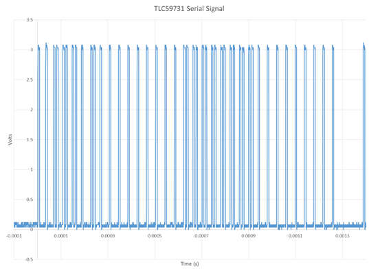

I am attempting to use a TLC59731 to light up a string of RGB LEDs, but am unable to make any of them light. There are 4 LEDs in the string, with an LED voltage of 19V. Forward voltages are as follows:
  • Red: min 1.7V, max 2.3V
  • Green: min 2.7V, max 3.7V
  • Blue: min 2.7V, max 3.5V
There are 220ohm resistors in series with each string. I'm using a 3.3V supply connected to Vcc, with a 0.1uF decoupling cap. The serial input is being driven by a Cortex-M4 microprocessor. I've attached an excel document of the waveform, and included a picture of it below. I have triple checked it against the datasheet, and I believe it's being driven properly. Do you have any thoughts on what may be going wrong? I can also supply other captures, if it would help.

  • Hi greggory,
    Sorry for late reply.
    I found that you have a 33 bit input for each period but TLC59731 has only 32-bit register. Please change you signal to 32bit and try again.
    Any update, please let me know.
    Rosley

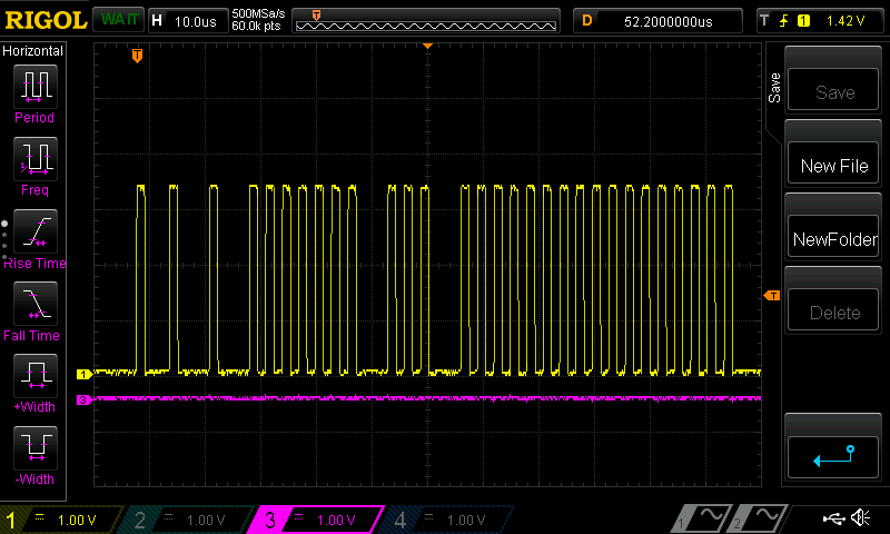

  • Ok, did eventually manage to get this going.  It really is the datasheet at fault here.  Perhaps the most ambiguous and incomplete datasheet TI has ever produced?
    It would appear that the Tcycle measurement sequence is the time between the first rising edge and the rising edge of the first bit.  So below here we see the 0x3A write command (b0011 1010) but with the extra measurement pulse out front.  The first PWM byte can be seen after the 0x3a command, it's 0xff in this case.
    So, it's not two pulses, it's not no pulses as I first thought, it's one pulse!
