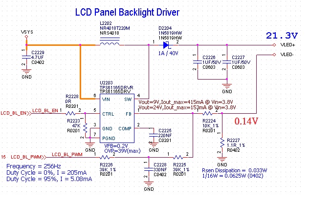

 there was a TPS61165 driving to 21V/170mA circuit as below,
and R2227 with VFB ONLY 0.14V can`t be 0.2V,and current only 130mA。
then change R2227 to 2.2R,and VFB reach to 0.2V,why ?
(we remove the PWM effect cause...)
    What is the VIN under this condition?  It looks like you are violating the Isat of the inductor.  If VIN = 5V, Vout=21V, Iout=170mA, L=22uH, then the peak coil current will be ~850mA.  The Isat of the NR4018T220M is 800mA.  I recommend either decreasing the load condition or using an inductor with a higher Isat rating.

  • Hi Nisha,.
    the coil was changed to Isat rating to 5.4A,but VFB can`t reach to 0.2V still..

  • Hi Philip,
    What is the VIN of your application?  You could be hitting the switch current limit of the device.  You can use equations 3 and 4 on page 14 of the datasheet to calculate maximum available output current of the boost converter.

  • Hi Nisha,.
    we changed the inductor for saturation when Vin=4.2V,
    but we suppose that FB pin PWM frequency cause actually...
    Do you suggest any guide for 128Hz-256Hz to 1% duty cycle from MCU driving 61165 ?
    is it cause of VFB variation ?
    thank you
  • Hi Philip,
    When the CTRL pin is constantly high, the FB voltage is regulated to 200mV typically. However, the CTRL pin allows a PWM signal to reduce this regulation voltage; therefore, it achieves LED brightness dimming.
    128Hz to 256Hz PWM frequency is too low for this device, the TPS61165 only supports PWM frequencies between 5kHz to 100kHz. The requirement of minimum dimming frequency comes from the EasyScale detection delay and detection time specification in the dimming mode selection. Since the CTRL pin is logic only pin, adding an external RC filter applied to the pin does not work.  Plese advise your customer to increase the PWM frequency.

  • Hi Philip,
    Another option is to create an external PWM dimming network. Please refer to the following design tool and Application Note:
    Design Tool:www.ti.com/litv/zip/slvc366App Note: www.ti.com/.../slva471.pdf
