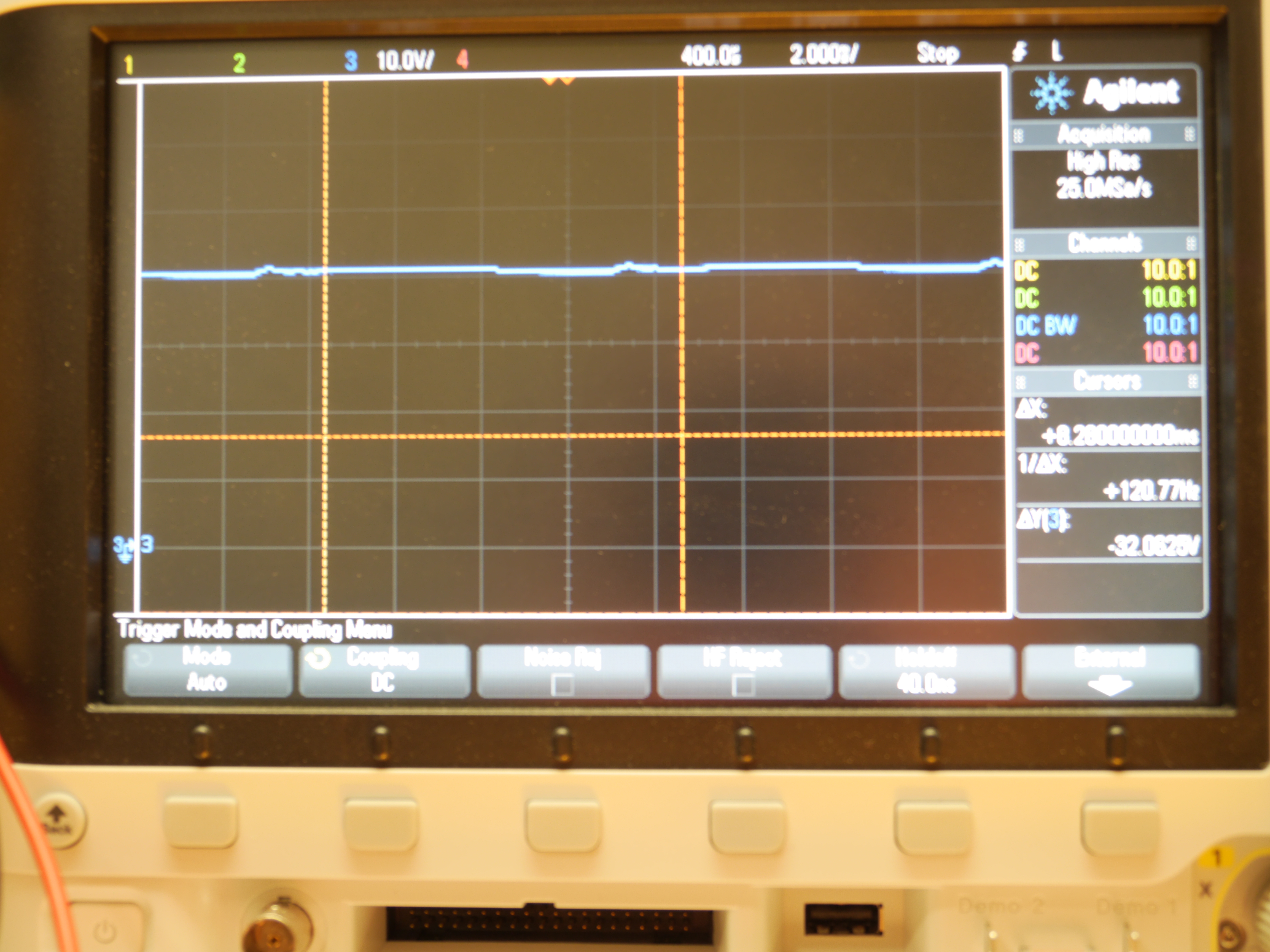

    A scope shot of the LED voltage. I have not rigged up a technique to measure the LED current yet.
    Notice that the LED-voltage average value is around 41V but the variation is about 900mV P-P. The variation seems to have abrupt transitions. I would not expect that effect from the relatively gentle changes in the valley-fill voltage. But the period of the variation of the LED waveform is definitely ~8ms (120 Hz). There are numerous ups and downs within each 8 ms period.

  • David,
    I forgot to attach the LED scope screen shot.  Here it is.
  • Benny:
    You need to get a current probe to measure the LED current. If you can not get a current probe, insert a resistor in the LED string and measure the voltage difference across the resistor.
